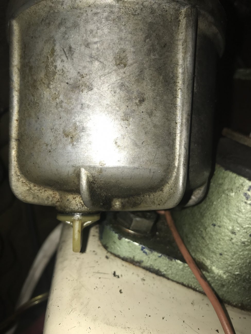

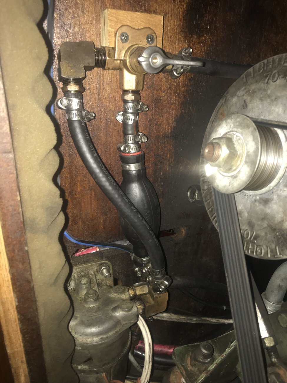

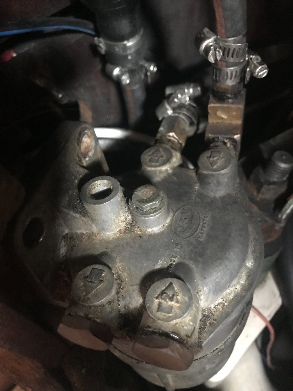

Need info on this pre filter, trying to figure out if there is a filter inside. Seems to possibly be a water separator. If so need info on taking apart and replacing filter.

It looks a lot like the fuel filter on a Volvo diesel. Cartridge type probably. Should be able to loosen the bolt head at the top of housing to drop canister. No provision for water separation, I think. For that reason, The owner of the Volvo I know replaced his canister style filter for a Racor with water separator.
24,502
I have the same filter on my Perkins 4.107.
It is a filter in the metal case. The bolt on the top does release the filter and fuel. Need to have a container under the unit.
Replace filter and then pump the manual lift pump and bleed the fuel lines.
I have a secondary Racor 500M filter between the engine and the fuel tank. It separates water and everything else from the fuel. Since installing the Racor I only need to change the primary once a year or two.

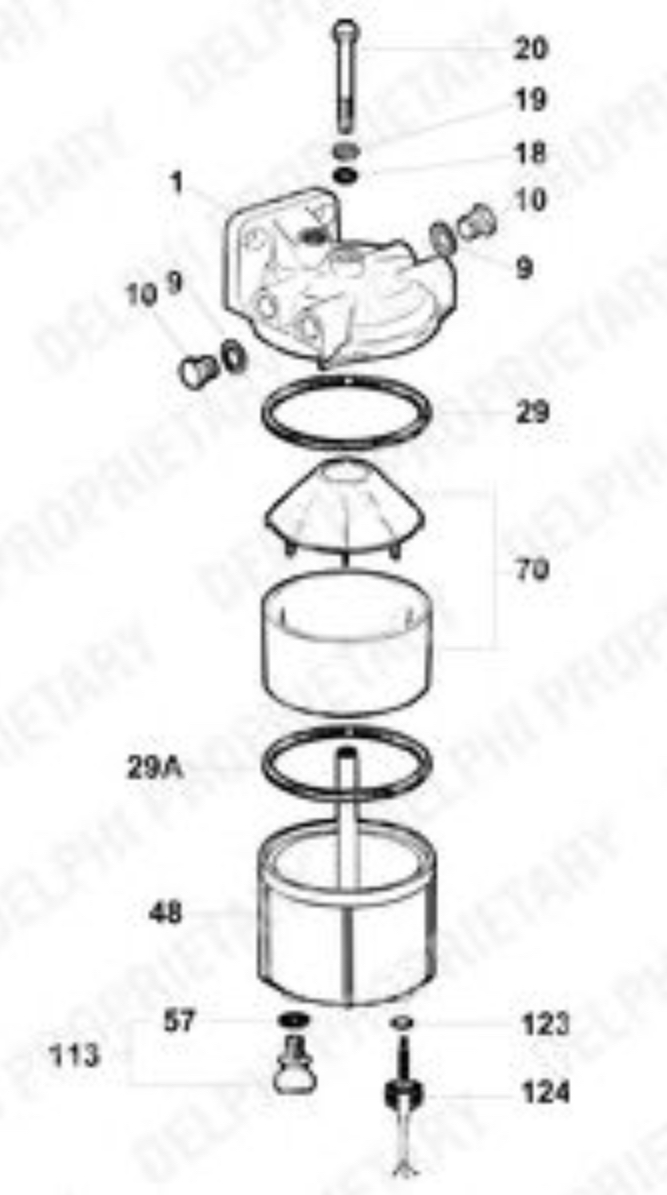

What you have in the pic is a LUCAS / CAV / DELPHI water & sediment separator. There is no filter element inside. We have the exact same on our PERKINS 4108 in our 1984 Beneteau First38. Copied the following from the ASAP.com website:
“CAV sedimenter / agglomerator is typically used as a fuel sedimenter. This CAV replacement filter does not use a filter element. The fuel separator features an alloy bowl and standard CAV type head which has four 1/2" UNF female ports (2 open ports and 2 supplied with blanking plugs).”
Sole purpose of this device is to decant water by density difference & solids by centrifugal force. Debris (solids &/or water) accumulate in the bottom and need to be purged by draining.
Someday we hope to replace it with a RACOR filter/water unit. Of course there is 2nd final filter further downstream.
