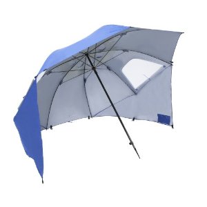

Take a look at the Sport-Brella. I bought one of these for $40 in Costco. It works fantastic. It's 8' across and covers almost the entire cockpit. Also has side flaps so you can tie them down to the lifelines. They also make a 9' if you need that big. I highly recommend it.

Alan, I like the idea of the umbrella! I checked the price for the brella and right now they have it for 79.00 I might get one, any suggestions on how to mount it?

We were lucky and got it on sale. I saw it on Amazon for $63. In any case it's a good deal. It has a retractable center post that you can use to adjust the height and there are loops on the edges for tie downs. I use a couple of velcro straps to mount the center post to the binnacle. It's extremely stable and very effective.
