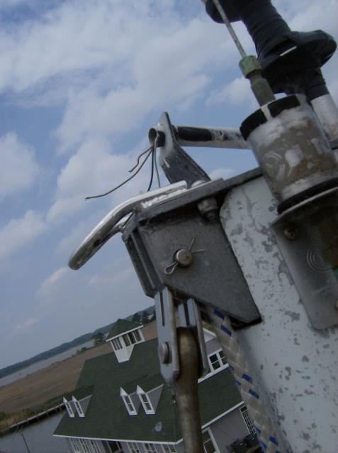

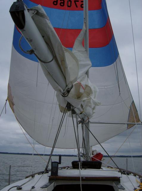

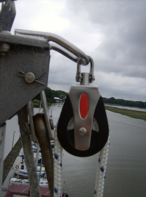

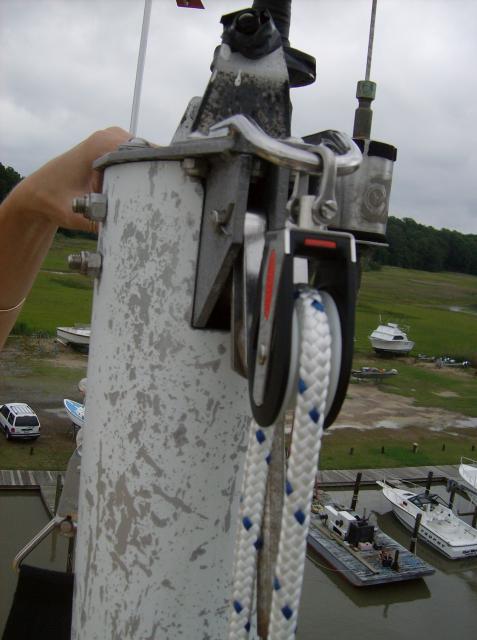

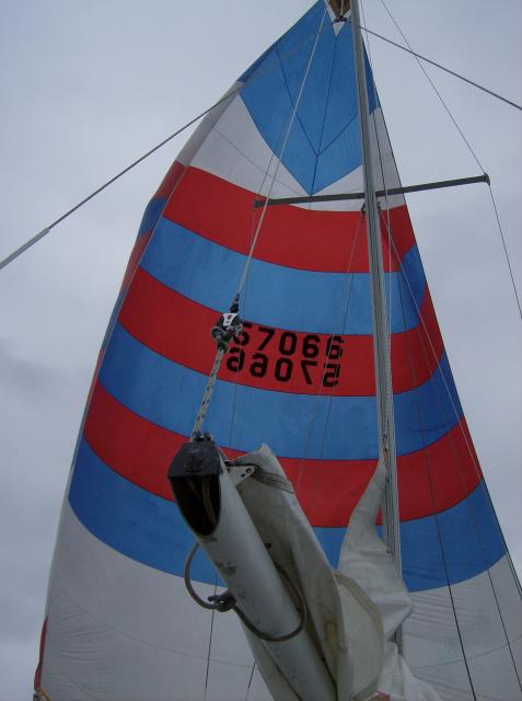

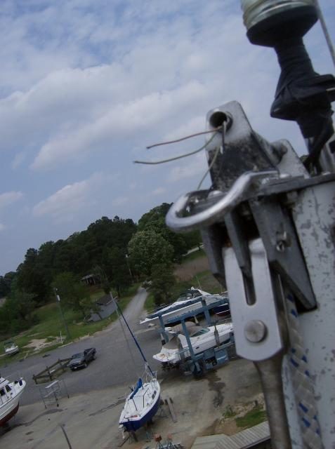

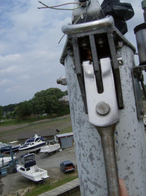

Trying to figure out the best way of running the spinnaker halyard out of the sheave box and forward of the forestay. I do not have a roller furler, just the standing rigging. There is a large padeye pointing forward at the mast head. It almost seems like I could lead the halyard out of the sheave and thru the eye then down to the deck. It looks like attaching a block to the padeye will cause the halyard to rub across the top of the masthead toggle attaching the forestay. I have the 40'6" Kenyon mast and it has two forward and two aft internal sheave blocks. Any ideas on what will work here?
