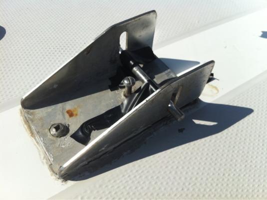

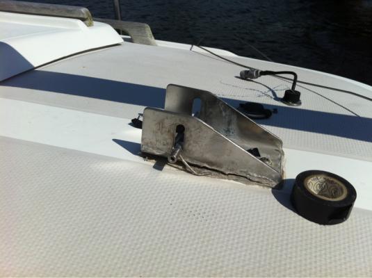

Ok, last thing...where the mast mounts to the deck (see pics) the steel plate doesn't appear to be fully secured. Not sure why this is??? Fiberglass appears safe and sound. Should be easy to either tighten down or re-drill holes and fix this right?
Clark
Jun 30, 2004
886
Hunter 280 Lake Guntersville, AL
Billy, that looks like you should remove the step and investigate. I'll defer to C22 owners about what supports the step underneath but at a minimum, the coring at that point has probably deteriorated and needs to be dug out; dried out; filled with thickened epoxy and redrilled. The step does not normally take a huge amount of side forces so it may have been attached with screws as opposed to thru-bolts and nuts.
