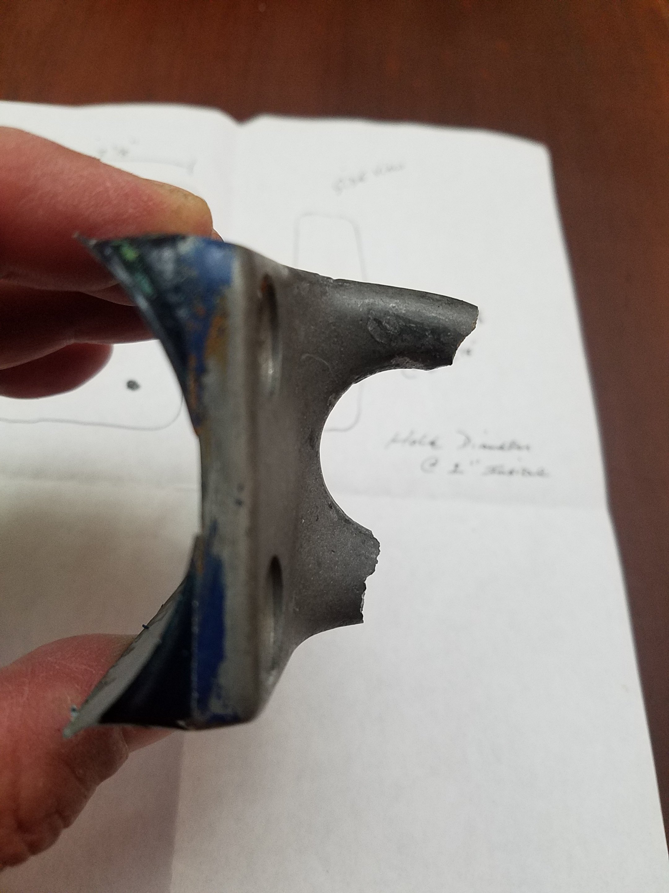

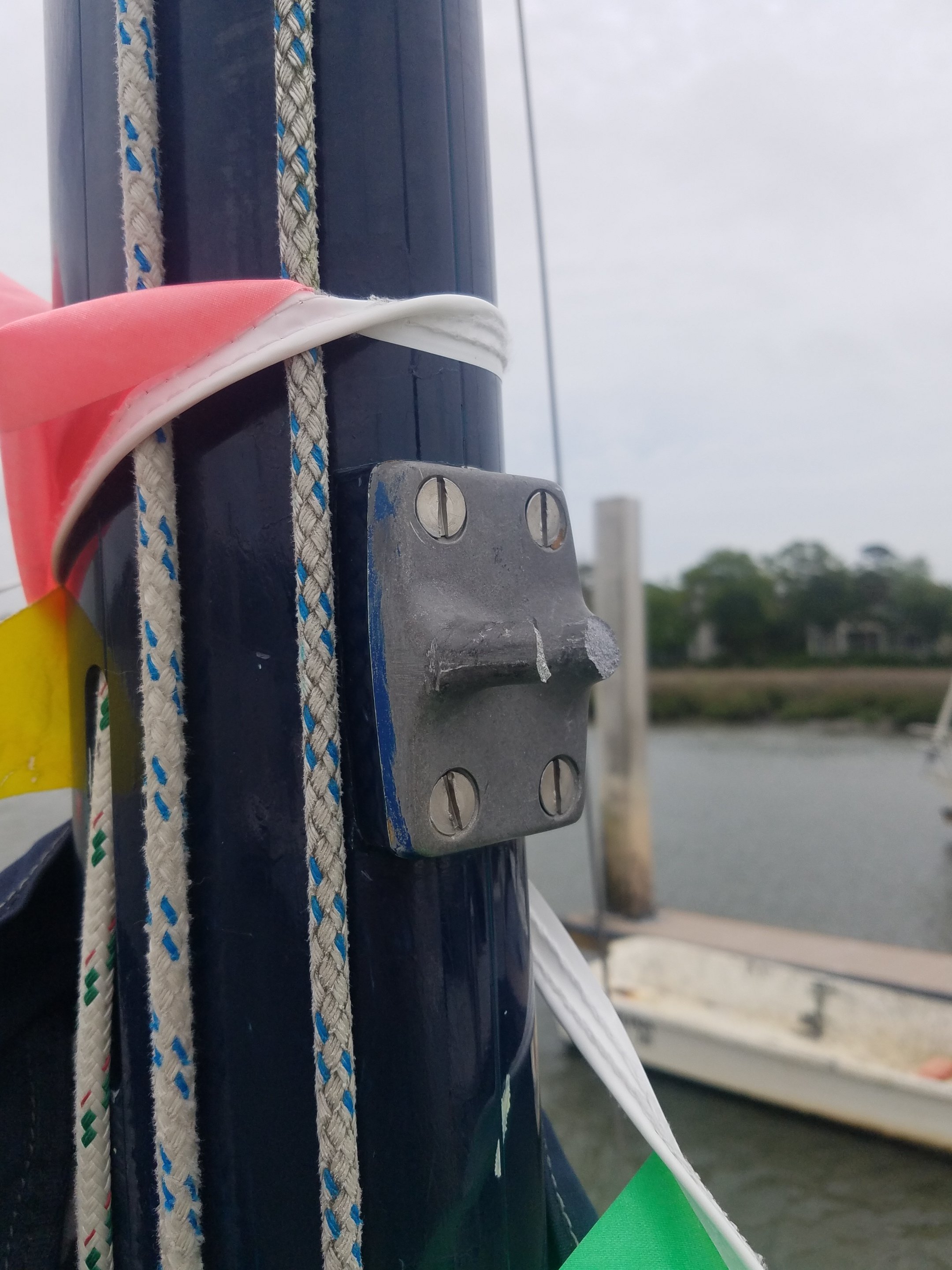

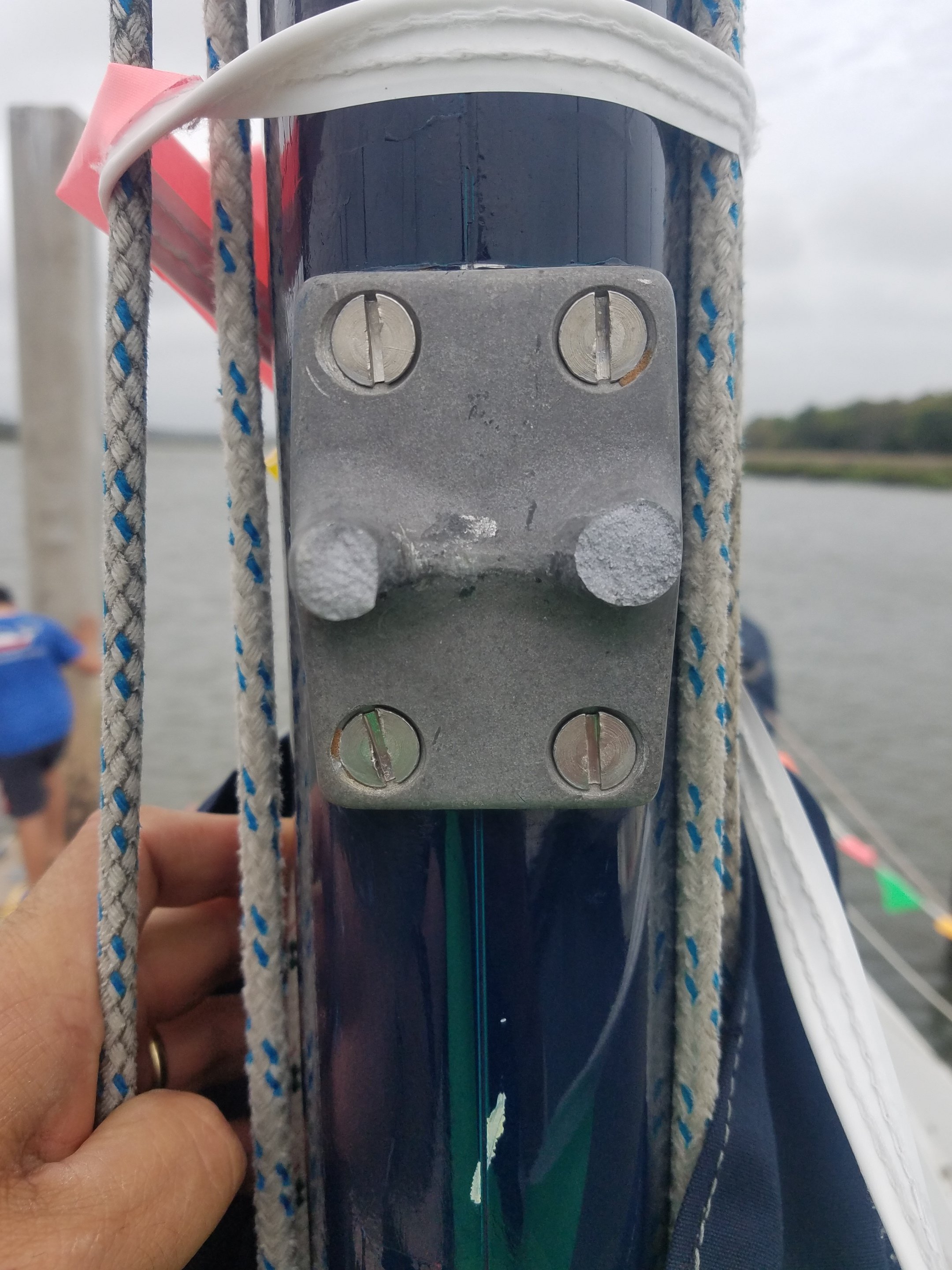

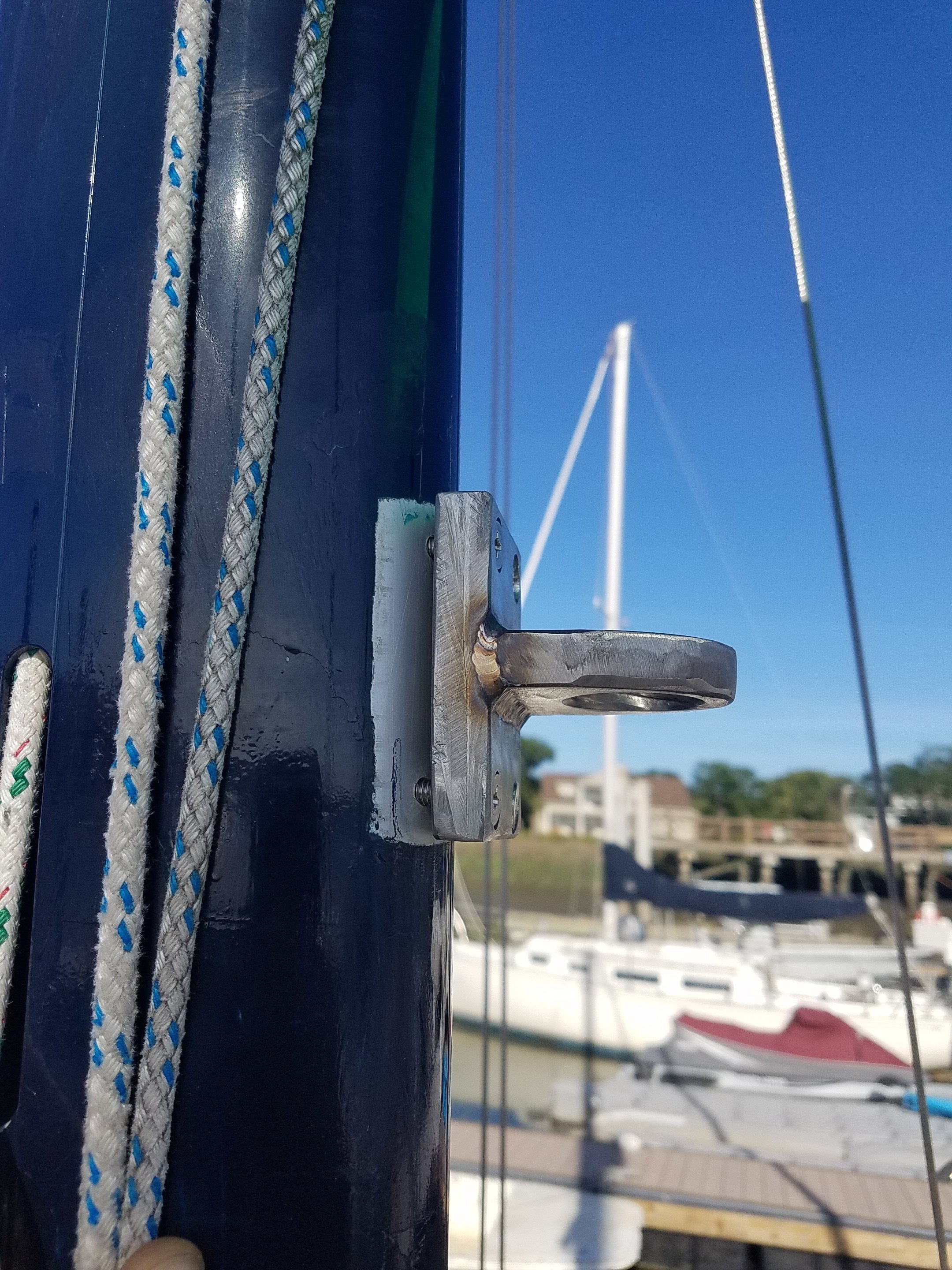

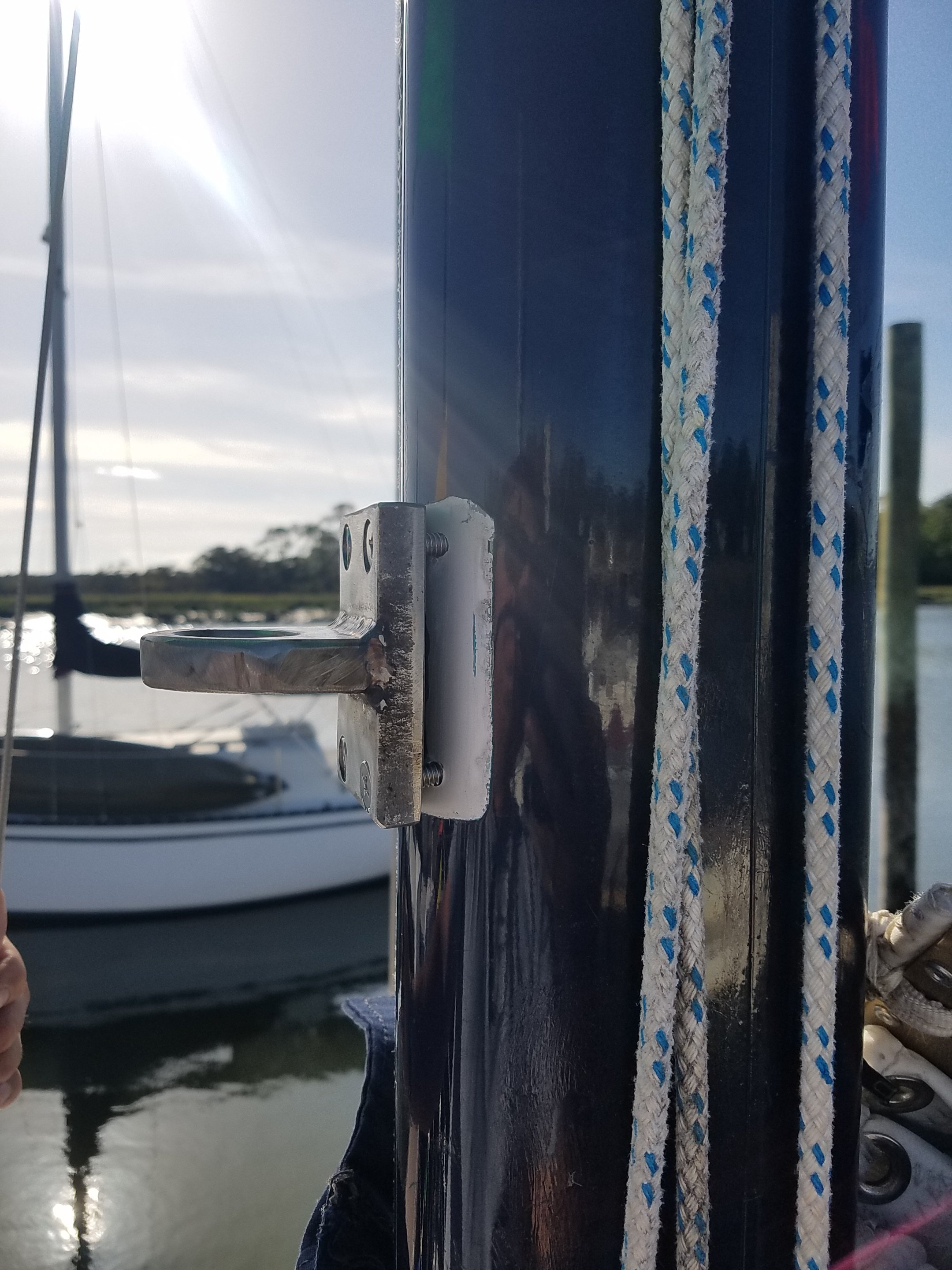

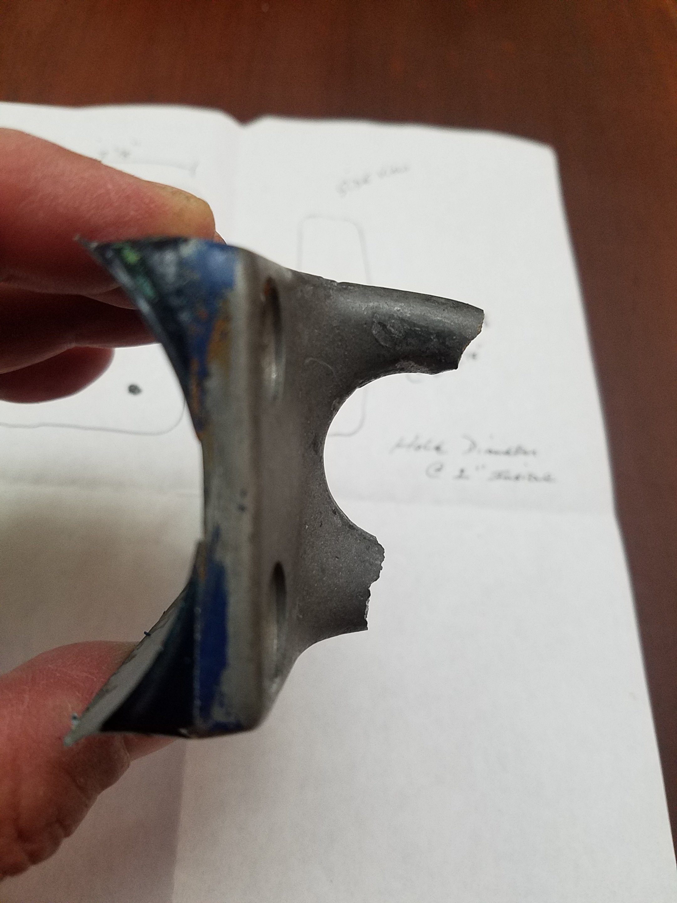

I have a 1994 Catalina 270, and broke the Mast Eye yesterday using the whisker pole to wing the Jib sailing downwind.
I am sure is was my stupidity, but I am hoping someone can point me in the right direction as to finding this part. It would appear I can unscrew the base plate and replace it but I am have quite a hard time finding this part.

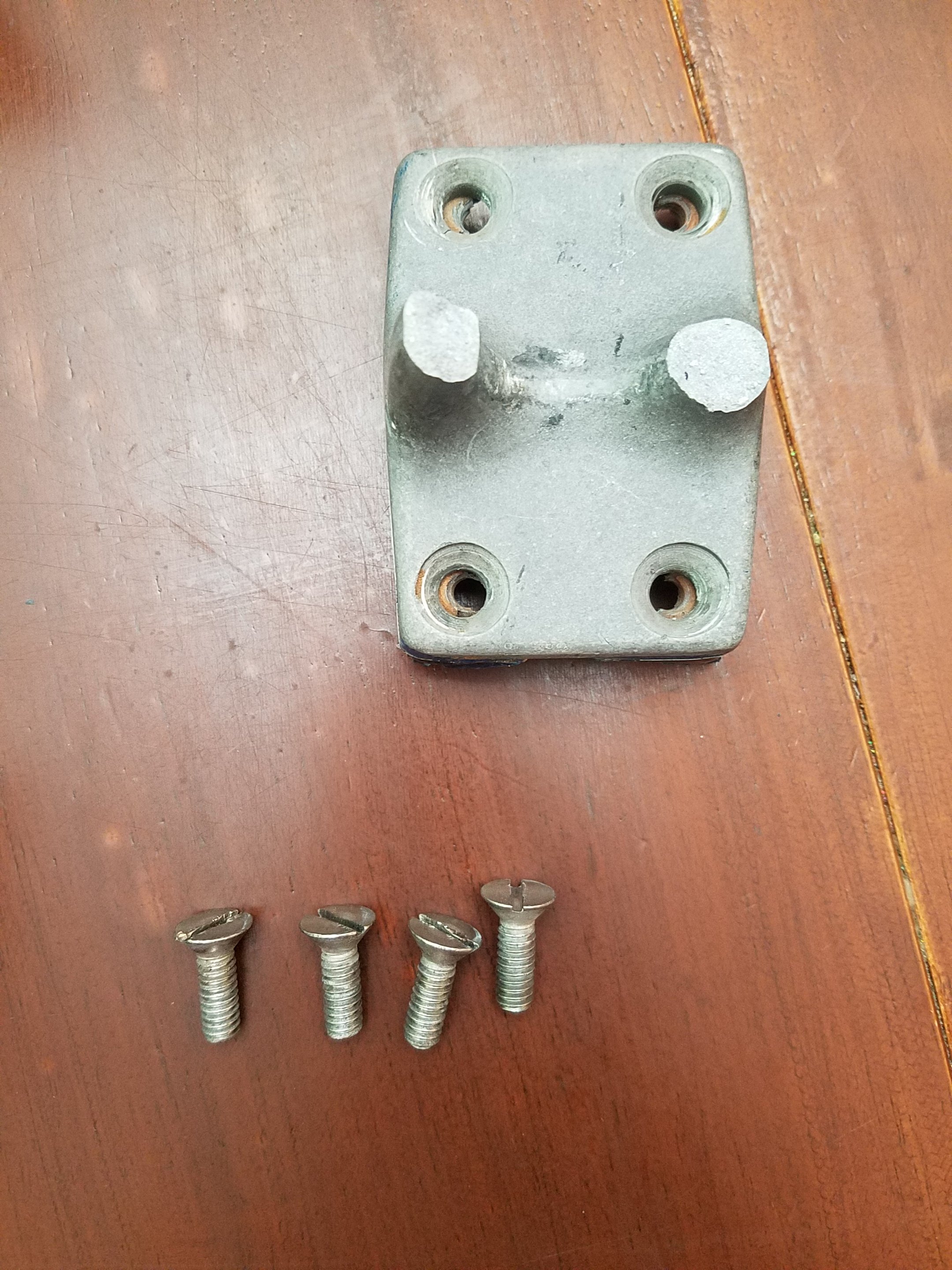

You are looking for a mast pad eye ring. The picture you posted looks to be made from a cast material. Forespar and Selden are the major players in this type of boat gear. I have seen more cast parts from Selden. Here is a link to a possible replacement.
http://www.seldenmast.com/en/products/rigging_hardware/deck_eyes/pad_eyes.html?id=4421&item=508-818
You can always modify the attachment to your mast and use a stainless fitting. This would open your options to all of the Forespar product line.
Check the hole placement of your fitting and then look for a part that has matching hole pattern. I am guessing but it looks like the stainless screws may be threaded into the aluminum mast. They may have a bit of corrosion on the threads. Not unusual. Work carefully and you should be able to get them out. Once out clean the threads. I like to chase the threads with a thread cutter into the holes to clean our the corrosion and prep for your install. Use an anticorrosion thread lock when you reinstall.

Looks like your original was cast aluminum. If it were my boat, I'd simply take that piece and fabricate a replacement out of stainless steel. If you can't weld, then you can find a local welder to weld the eye onto the plate. You could probably have it fabricated faster than finding a replacement.. ;)

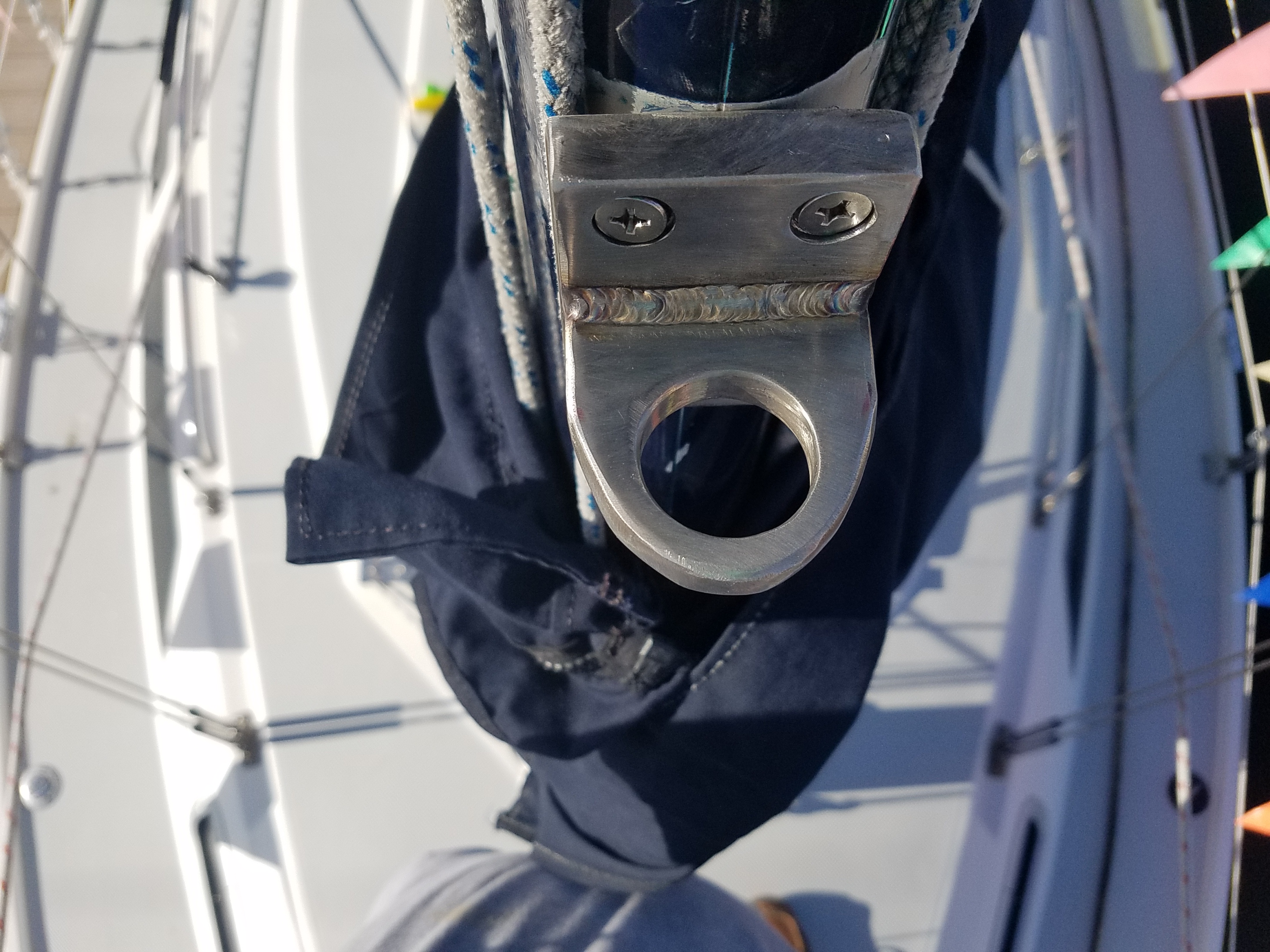

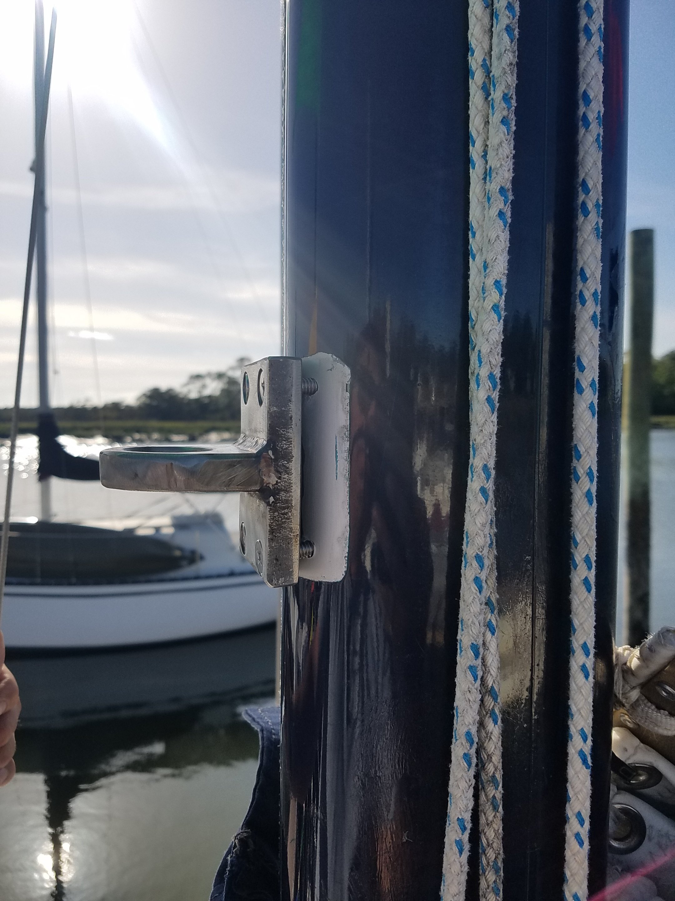

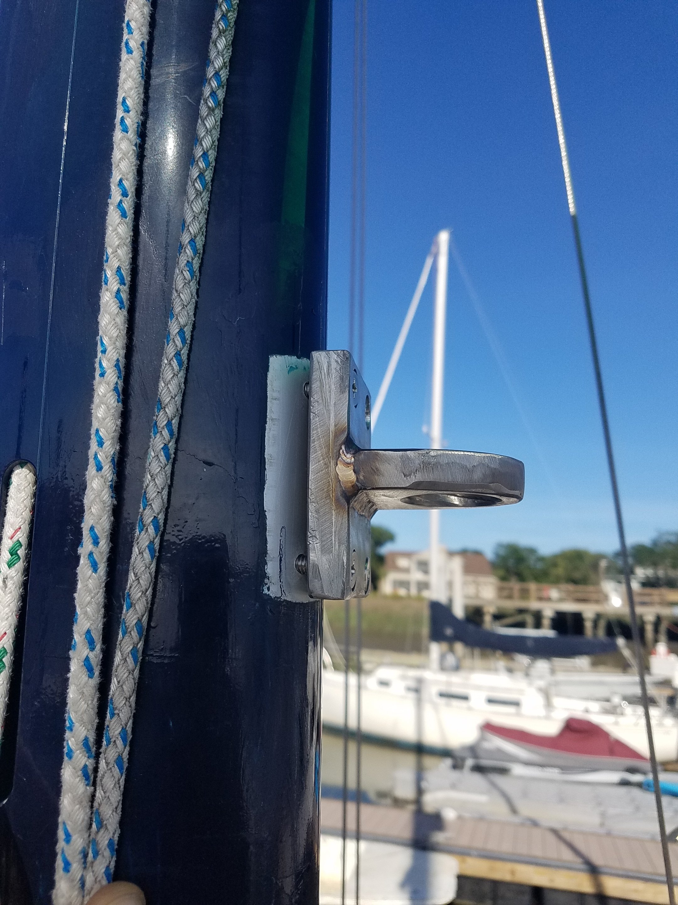

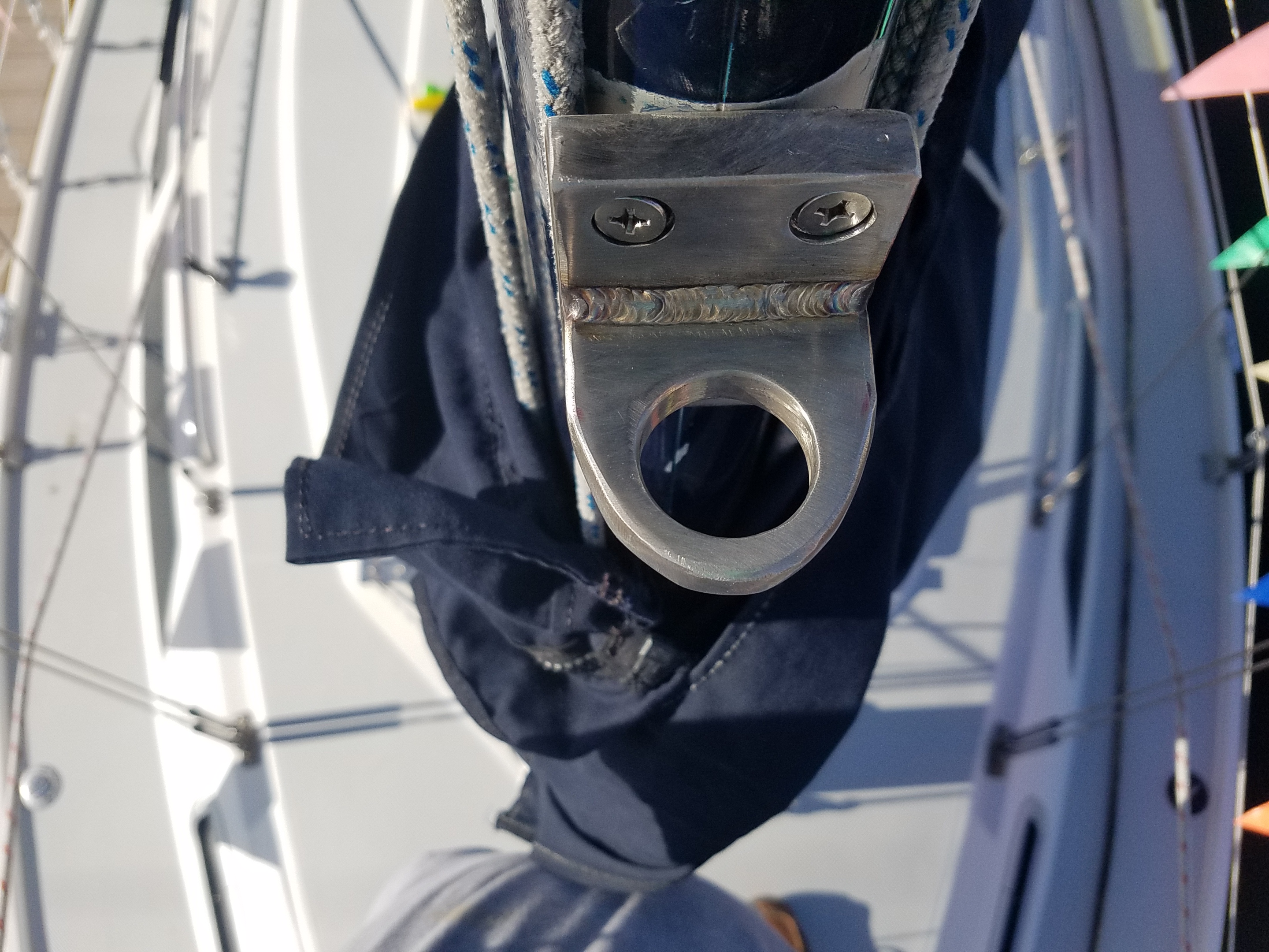

I had a welder in the area make a pad eye. It has a matching hole pattern so I have simply picked up some longer screws and reattached with out new holes. It is big but very strong, overkill perhaps, but will work nicely.
Any recommendations on a filler, as the previous one had, to bridge the gap around the base plate and Mast?

It depends upon what materials you like to work with. You could use a Delrin, aluminum, wood if you want to do it with a solid material.
You could cast a piece from structurally filled epoxy. This method will give you a perfect match quite easily. Wrap your mast with saran (plastic wrap) wrap (you probably want to be able to easily remove this spacer if needed). Wax your screws, and you mix up your epoxy with a structural filler to the consistency of thick peanut butter so it doesn't sag. If you want to be able to remove the spacer from your plate, either wax your plate or cover it with plastic wrap like the mast...
Basically, pick your preferred material to work with...
