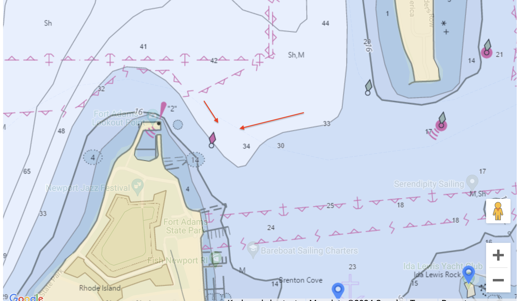

jviss
Feb 5, 2004
7,090
Tartan 3800 20 Westport, MA

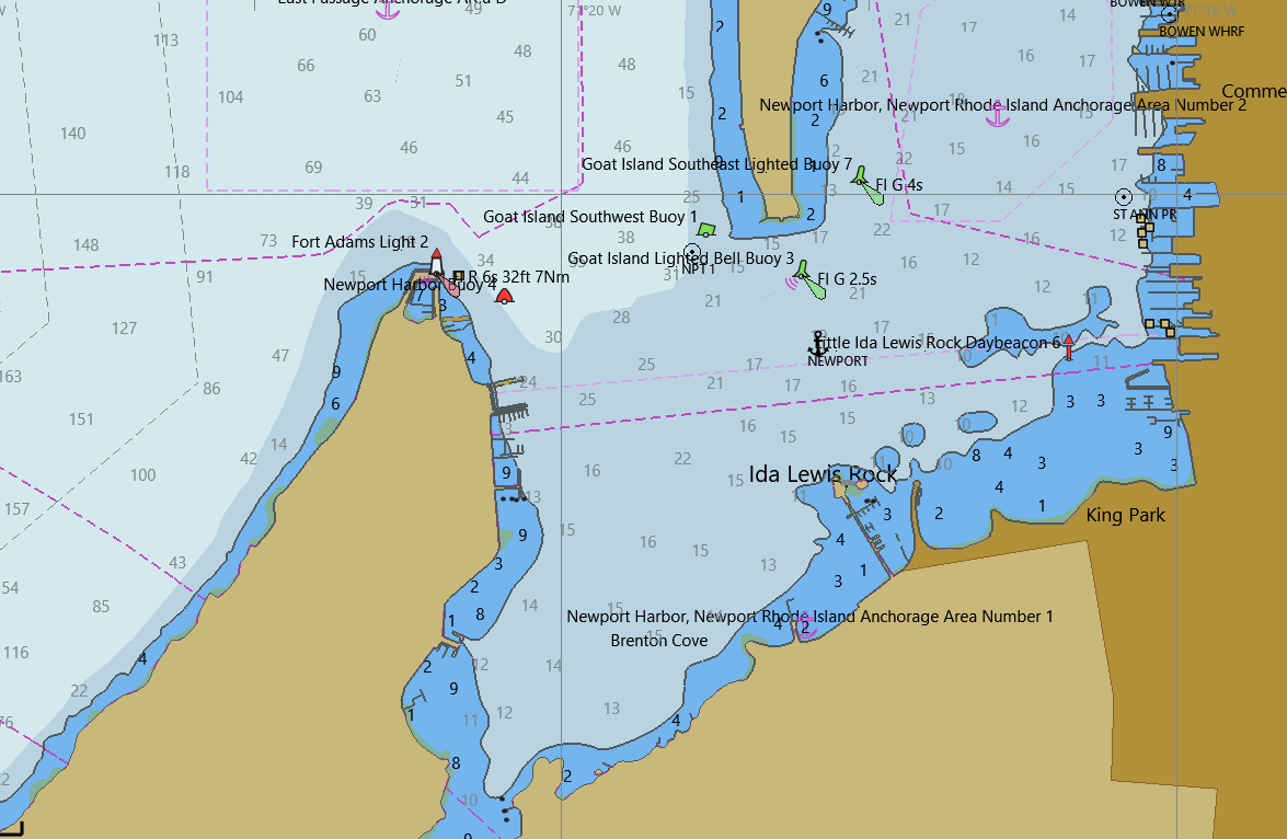

The total width of this entrance, from the point at Fort Adams, on the left, to the bottom Goat Island, on the right, is 2,300'. Between the buoys is probably 1,500' or so.
The small arrow is me, entering. The longer arrow is that fleet coming at me. I don't know where exactly they were coming from, probably from the East side of Goat Island, as I didn't see them until they were on top of me.

14,278
A 1000' is plenty of room and there is plenty of depth outside the red buoy. Slowing down or even stopping for a couple of minutes shouldn't be an issue. The chanel is 20 times the length of your boat. Sorry, trying plow through the racing fleet was just bad seamanship and manners.
All I know is that if one hits a USCG buoy (in a race or otherwise) you'd better be in a well built metal boat. Those things are heavy and not inclined to move out of the way.
Yes, they are big and heavy. If you hit them on a glancing blow it will get your attention and you will have some gelcoat work to do, but they won't sink you. Hitting head on, might be a different story. Don't ask how I know this.

You are hanging your hat on "constrained by draft".... You were not constrained by draft. You boat has less than 6 feet of draft. You could have easily gone to the land side of that red buoy. Plus the channel is plenty wide where you are talking. You were motoring, you were not showing a constrained by draft indications (which you shouldn't have) - those sail boats were the stand on vessels but apparently you are complaining you had to look out for them... I'm recalling a saying my mother used to use - "You're looking for sympathy? You'll find it right in the dictionary between sh!t and syphilis.."
