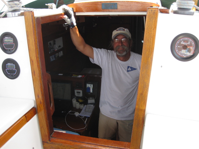

The original instruments on Impetuous were Signet sailing instruments and a Garmin Chartplotter with the datacard. We upgraded to the B&G instruments with the Vulcan display. Our unit came with the wind instruments and the triducer DST. An important feature for us was the built in WiFi. The MFD is mounted to the navigation station down below but our tablet hangs off the bimini above and forward of the helm. The Admiral loves it as she can change displays easily. I love it because we got rid of the three 4" holes where the old Signet displays were mounted.
