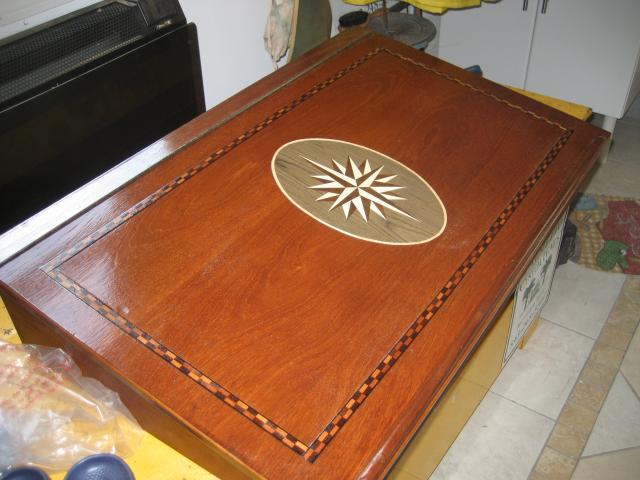

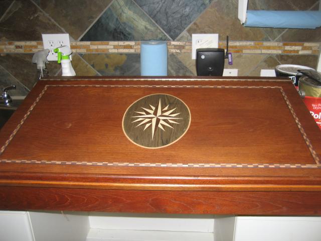

I work in hardwood floors but our medallions and borders are 3/4 thick so I looked at marquetry in order to achieve the same results.
I selected a small Compass Rose medallion and a 1/2 border from Inlays.com. After making a pattern, I routed a 1/8 groove for the border and a space for the medallion. After gluing, I covered the top with several coats of varnish. Right now, it has a gloss finish but I may use satin on the last coat.
