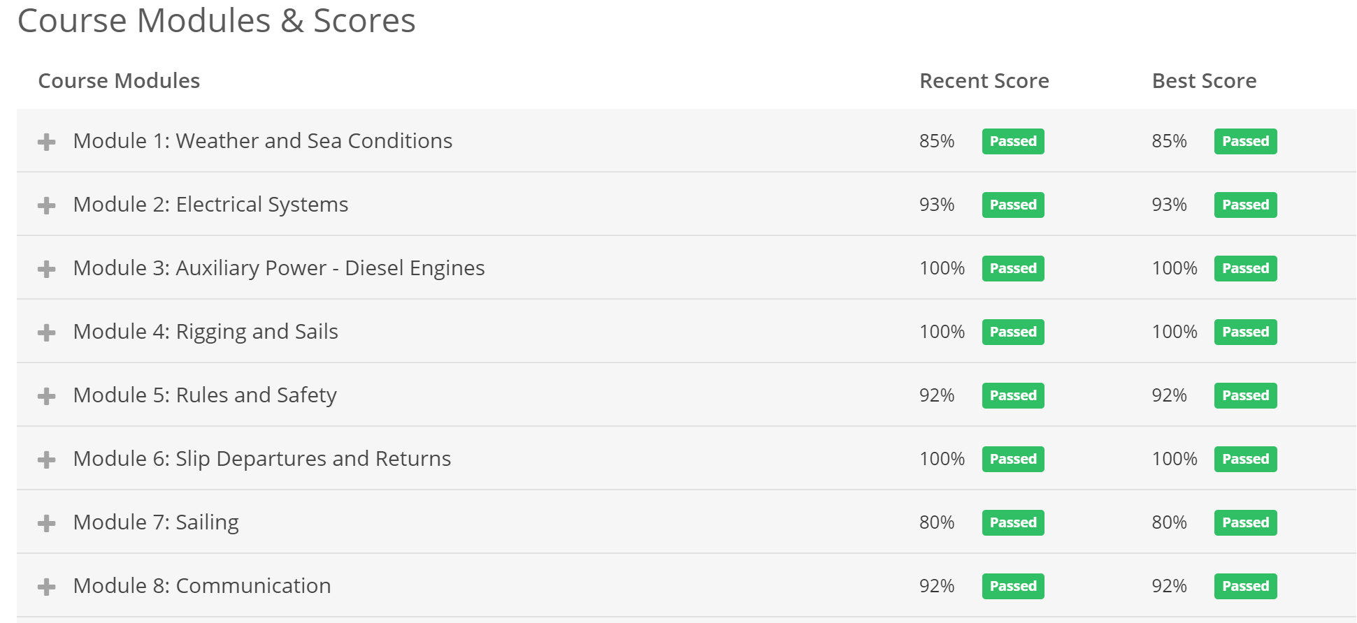

there's my nauticed as a snapshot. the relevant bit is under module 5. it ain't a 100% but it ain't go buy a book and read and come back.

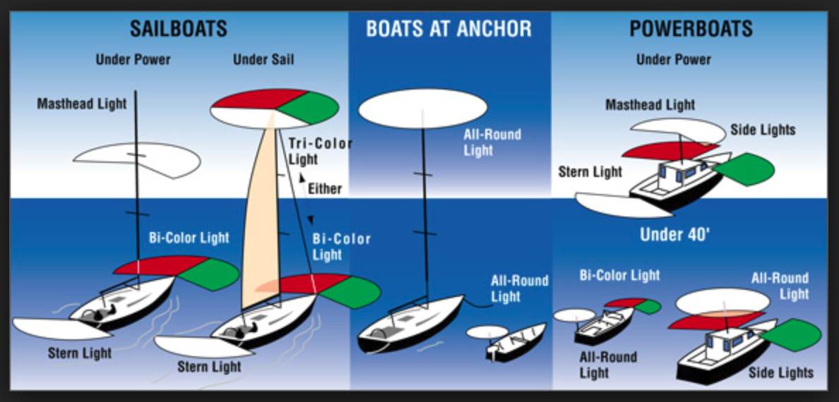

there's the photo, the very same photo, that sparked the conversation. The sailboat undersail has the tricolor. the boat i bought had none. It also shows both sets of lights on at the same time. This graphic is the same as the one in the michigan boaters safety course books, which i can take a snap of later if it helps you think i read before i post. I'm not some green horn pwc jetskier raising hell waiting to get caught by the patrol.
13,995
Unless I'm missing something, wouldn't be the first time.
Hey Stu, that's my line! :)
The picture says EITHER. Not BOTH.
Yes the picture does say "either." Here's a link to the CG's Navigation rules. See Rule 25. Note that the inland and international rules may be different.

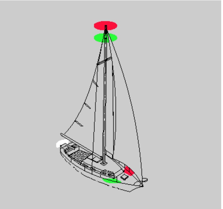

Well to add to the confusion..... Is this legal?
So has this thread been hijacked enough? I have to comment not legal regardless. Under sail power and 360 degree red and green on mast head...are you a boat, a beacon, towing. Bad idea, except maybe plausible at anchor or moored on Dec 24-25th.

Is this legal?
It is. According to the rule #25 paragraph c):
"(c) A sailing vessel underway may, in addition to the lights prescribed in paragraph (a) of this Rule, exhibit at or near the top of the mast, where they can best be seen, two all-round lights in a vertical line, the upper being red and the lower Green, but these lights shall not be exhibited in conjunction with the combined lantern permitted by paragraph (b) of this Rule."
(in this context, a) means normal nav lights, b) means tricolor)
