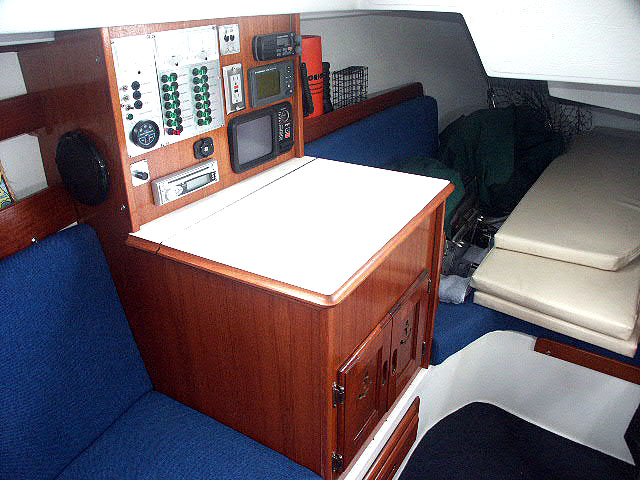

I'm going to use the original ac/dc panel for now. Don't really feel like spending 500 bucks on a new one. I found this picture online and plan on duplicating that design.

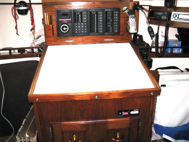

880
Fed up w/ personal attacks I'm done with SBO
You found that online? May I ask where?
My interest, you see, is that it's mine! I'm flattered you like it and would be happy to provide any level of detail you like.
Off to work now (so you don't think I'm ignoring you).
Thanks

I just googled "Catalina 30 chart table pictures" and found the site your photos where posted on. Do you by any chance have more pictures of it? Maybe a bit more detailed?

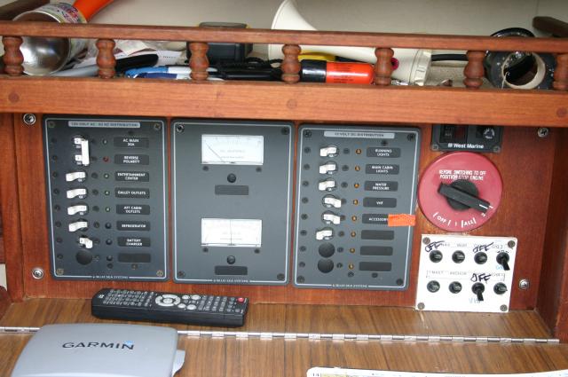

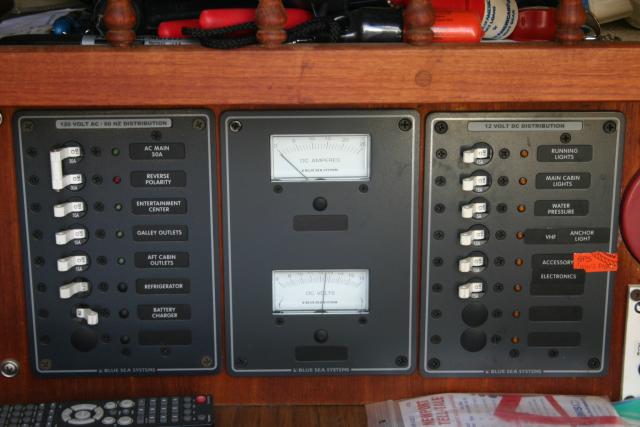

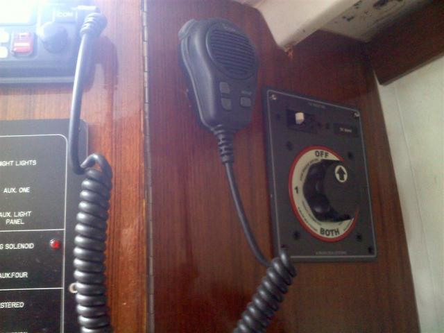

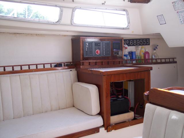

I also admired Neil's electrical panel - There are 50+ footers out there with panels not as elaborate as his -nice- I've never even seen those light up breaker switches anywhere else - where did you get those from Neil? My boat has the Blue Sea System panels, which are a good retrofit, because you can buy them in multiple sections, making the rewiring easier, as it can be done in stages, and not as hard on your wallet all at once. But don't do like my P.O. did & leave the cheesy subpanel switches in place - now I have to turn on the main breakers at the Blue Sea Panel, & again on the smaller white subpanel. This is frustrating sometimes to figure out, and I'm sure it wastes some precious battery power due to the extra wiring voltage loss.
I also recommend replacing the master battery switch if you haven't already. But I found that the standard Perko model doesn't fit well - too big - I would use the Blue Sea switch. Make sure U label the circuit functions well! Pics attached. ps. I would also loose the extra length of wiring going to the Ampmeter at the cockpit gauge if U haven't already - creates a huge voltage drop. Good luck.

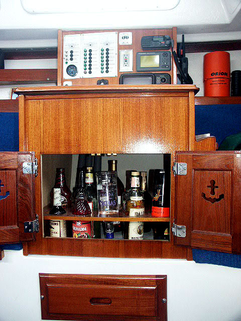

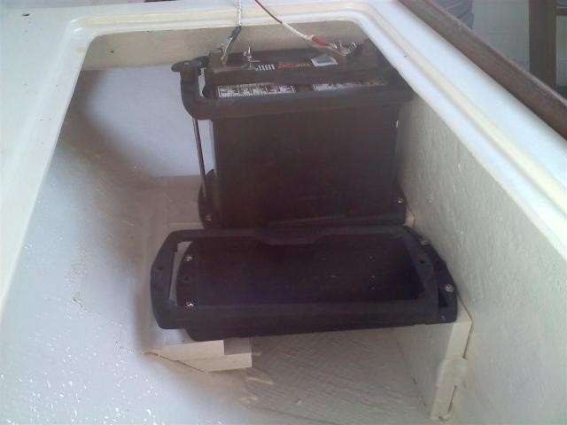

Yeah, Fat Cat and Old School have some sweet set ups. Top grade woodworking coupled with patient eletricical skills will always net a fine result.
I replaced an second generation panel that was in the galley with Blue Seas. It was a bit expensive, but I wanted to add the battery switch, AC and DC panel. I received alot of help from Stu Jackson when I started. I am extremly happy with the results.
My skills are average...maybe a bit higher. But that's only because I am fearless. That is the sole key. Know the plan ahead of time and then don't be afraid to dig in and do it. I've made SO many mistakes, but I only make them once.
I enclosed a few pics. I put the house batteries under the nav table along with a Xantrex 40 Charger. I also bought the Xantrex Monitor and Battery Temp sensor. The previous owner had installed a fridge under the nav table, so the original panel doors were missing. I made a louvered panel to fit over the opening. I was originally going to use the teak louver kit from Jamestown Distribution, but they discontined it. The DYI project was very complicated considering I don't have a plunge router or jigs...but it was fun.
Certainly Old School, Stu Jackson, Captian Ron and others are a great resource. If you need more pictures, let me know, I tried to take as many during my projects for reference.

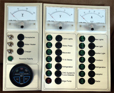

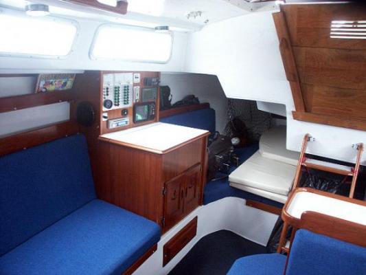

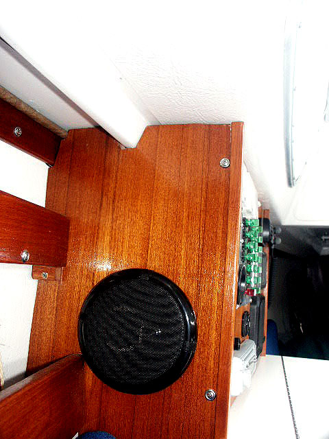

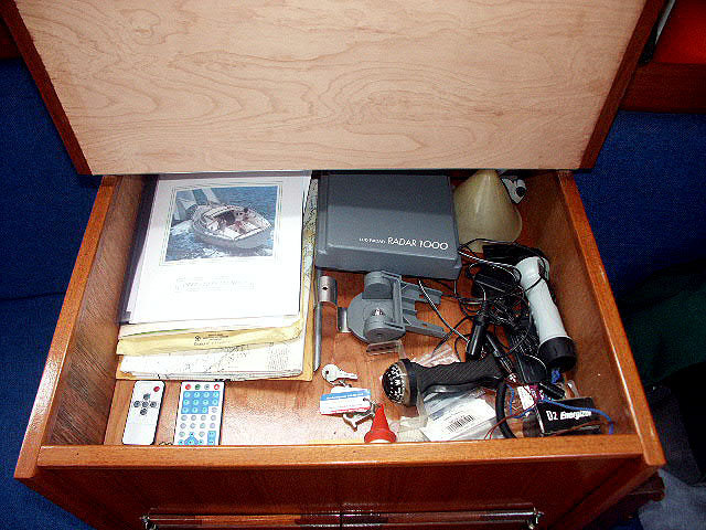

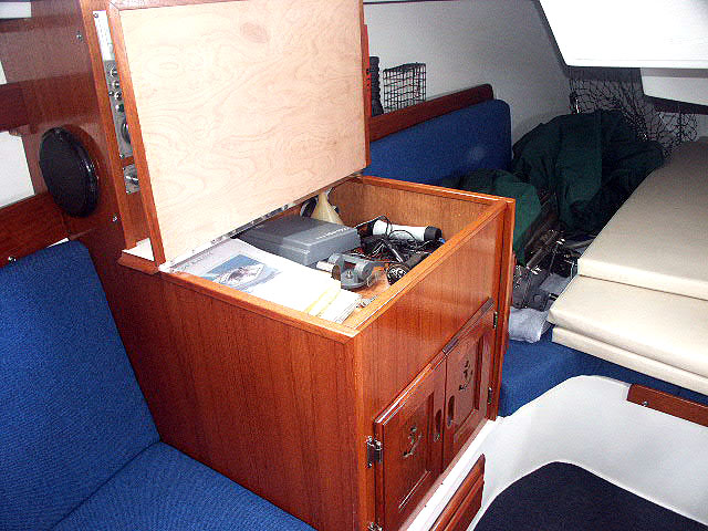

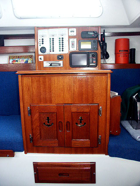

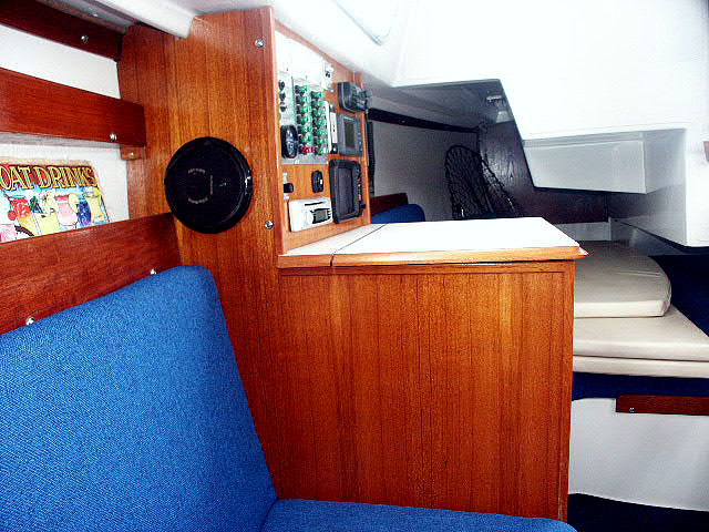

Here's my story
My P.O. hacked out the front of the original slant top nav station and chained (yes, chained) a bar fridge in there. I scrapped the whole thing and started from scratch. New cabinet, new panel, new everything.

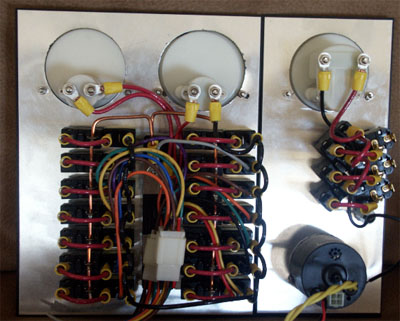

I fabricated the electrical panel from components bought from All Electronics. The illuminated switches are just that, switches. The breakers are the round parts. The panel face was laser engraved by a trophy shop to my artwork. Total panel cost came to about $250. The GPS and plotter came from the P.O. although they were nailed up to the overhead. Everything else is new.
I've provided this information off list to another member so depending on your experience, I have woodworking drawings for this project as well, including a tutorial on complex patternmaking. For now, here are the pictures you requested.

Very impressive Neil! From the pictures I am now assured that when we do finally get to Cabrillo to see your boat, I won't have to pretend to like beer! I see you have some choices there :) Your space under the nav table is so nice an deep, I like that alot. You have done such a great job! Beautiful!

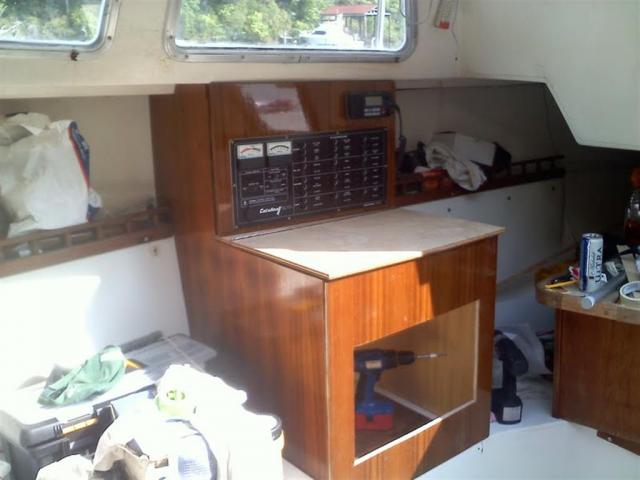

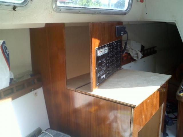

Well..since we've started this thread, I'll jump in too.
I am knee deep in the middle of my new nav station & DC re-wire project as we speak. I hope to have the main battery circuit completed this weekend and fire up the engine.
I have #511, complete with slant table & 6 switches in the galley.
I found this sweet Seaward Panel on e-bay..a little overkill, but it was a better deal than a Blue Sea panel with half the breakers.
My design is very similar to Old Skool Neil's (lots of borrowing of ideas). No sense in re-inventing the wheel on these things, especially with his pristine example already available.
Still needs trim & final touches..this is a "rough" assembly so I could start adding other necessary components. These are also cell phone pics..need to take the better camera down to get some sharper images.
Now, if WM would get my Blue Sea 2723 in stock, I could connect the engine & panel to the batteries, which I relocated under the stbd settee, just forward of the chart table.
Lots of wiring has happened since these pics..It looks like a 4 ga. can of those exploding snake things blew up in the boat right now.
