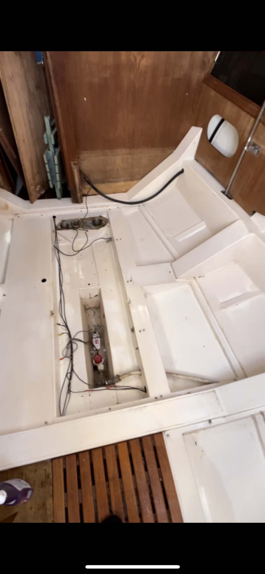

Figured some might appreciate this. This boat had a leaky window that destroyed the cabin sole and galley cabinets. We’re in the process of gutting the interior. Replacement flooring is being cut using a CNC machine and measurements transcribed into CAD.
Does anyone have any words of wisdom since we have this removed? Anything to take advantage of while it’s open, or would maybe do differently? We’re already opening up the bilge access a bit, and making it easier to run cables for when we unstep the mast next winter and add radio/radar.
only mod we’re considering is making the table a bench seat against the wall, with a leaf that can open up to extend to the other side. This will also help when we do a compression post replacement next winter.
Other than that it can be lowered to make a bed, like the original. Not sure if we’re going to keep the galley island as-is.
Also using thick plywood, coated in epoxy and covered with that foam teak veneer.

You've already thought of the epoxy coating the floors - all sides and edges. If you are screwing them down, then drill oversize holes all the way through, fill the holes with epoxy, and screw into the epoxy.
I would also verify that all the holes through all stringers, ribs, whatever are open, so that water can move from wherever it originates to the lowest point in the boat. For our 1983 model, the hole that ran from the head to the bilge needed some cleanout.
There are lots of threads about the false bilge in these boats. You may want to consider cutting out a part of your bilge to get to the actual lowest point in the boat, and reinstall your pump at that level.

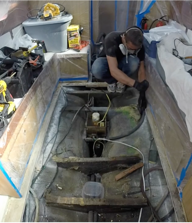

There are also lots of threads about replacing soles. Here is mine from when I did mine:
