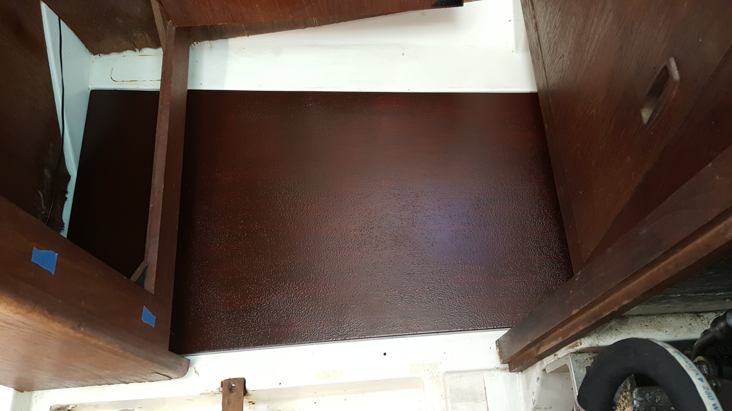

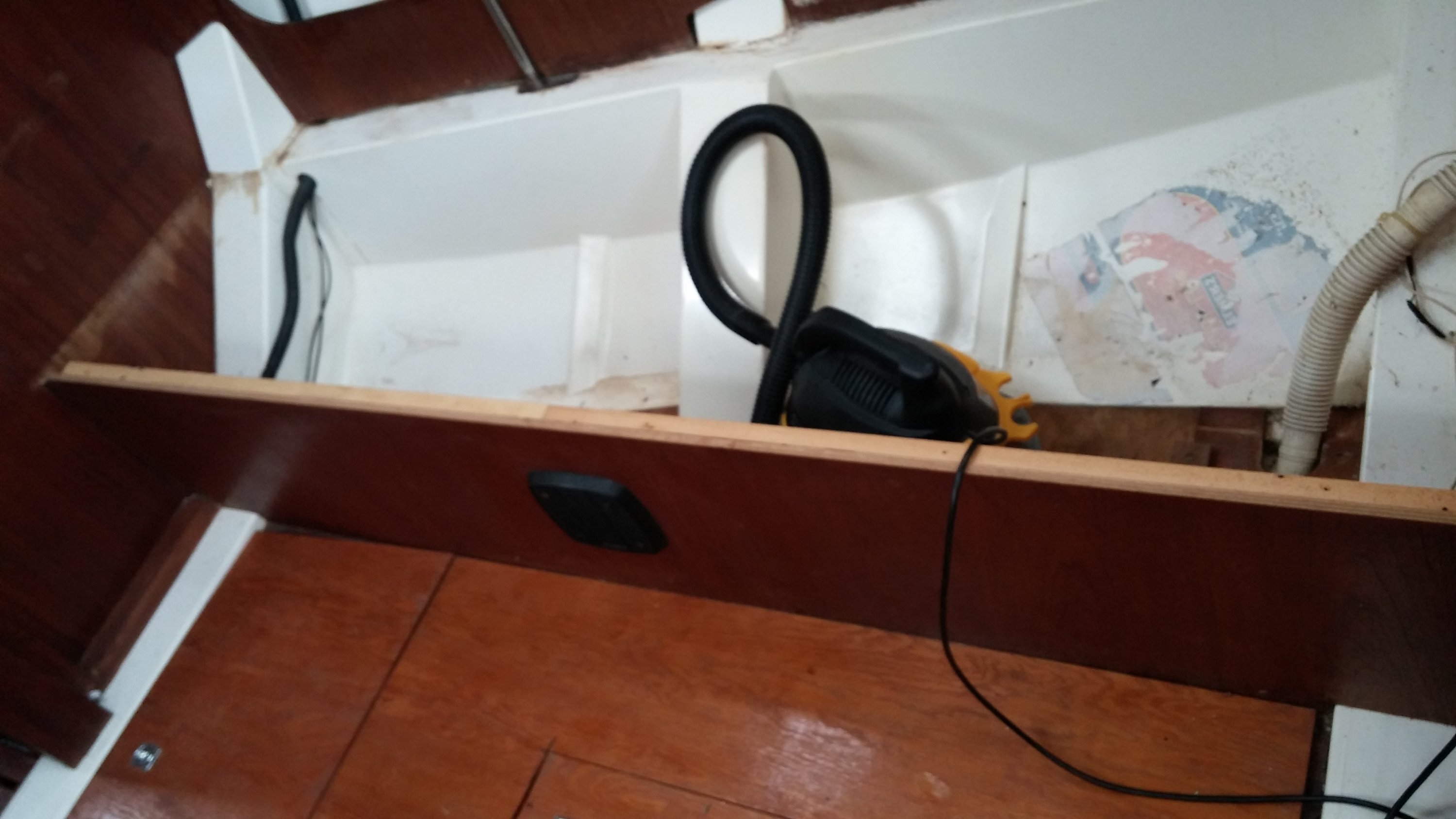

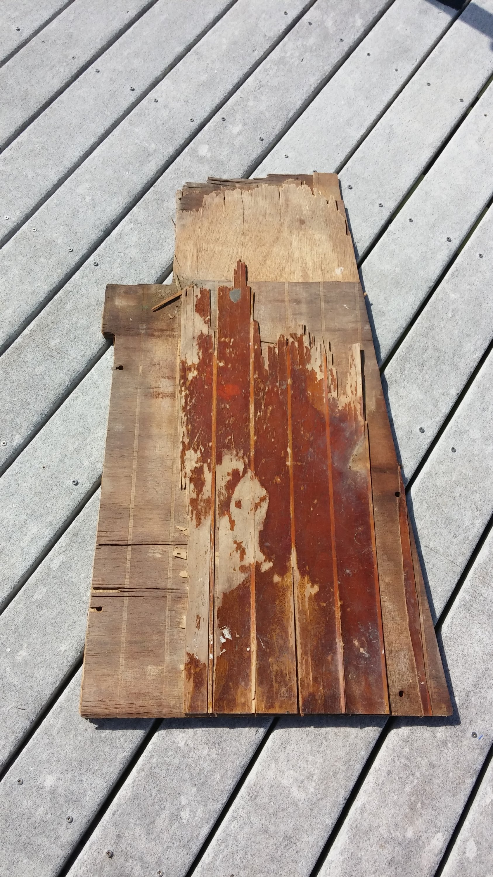

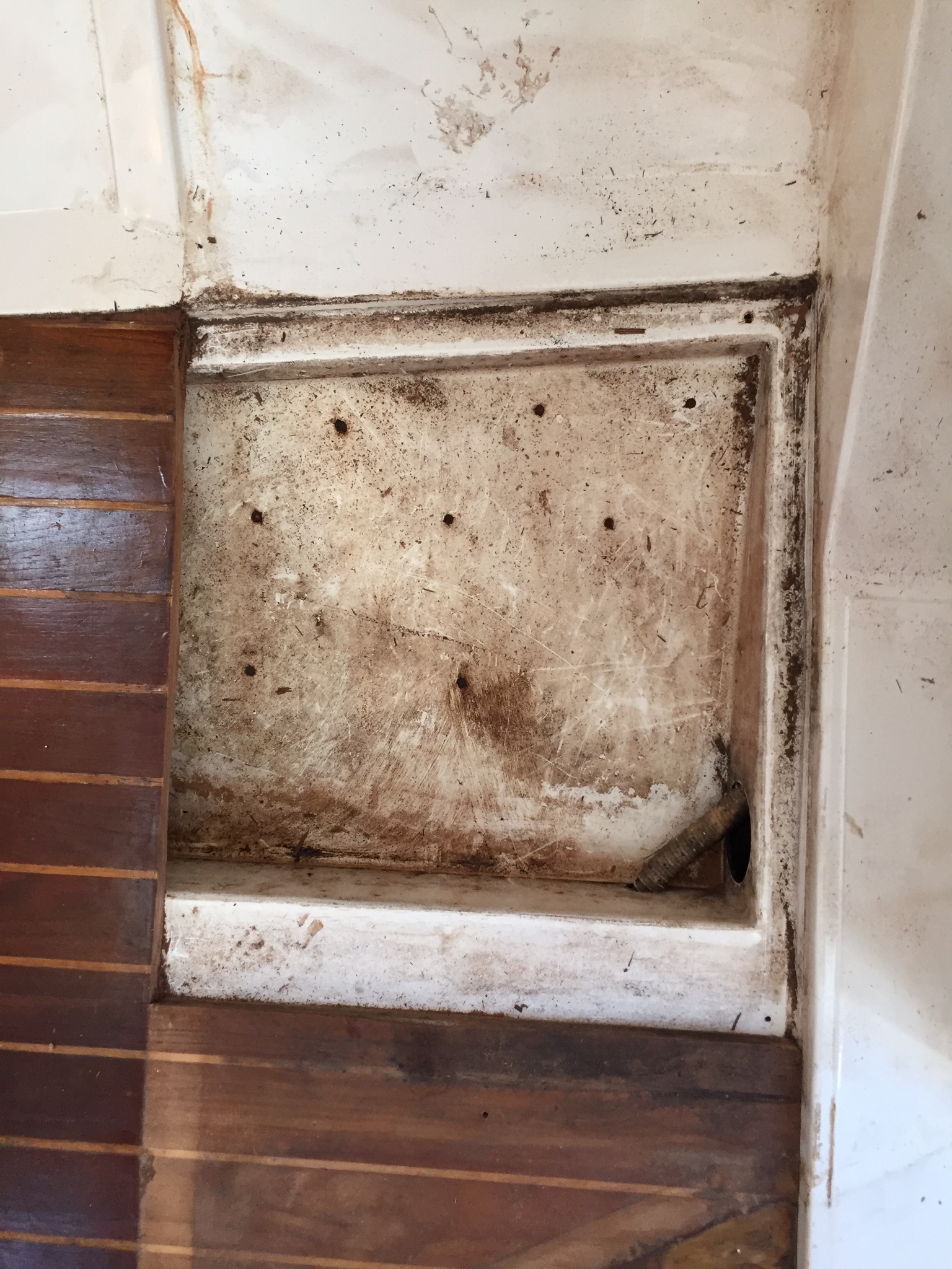

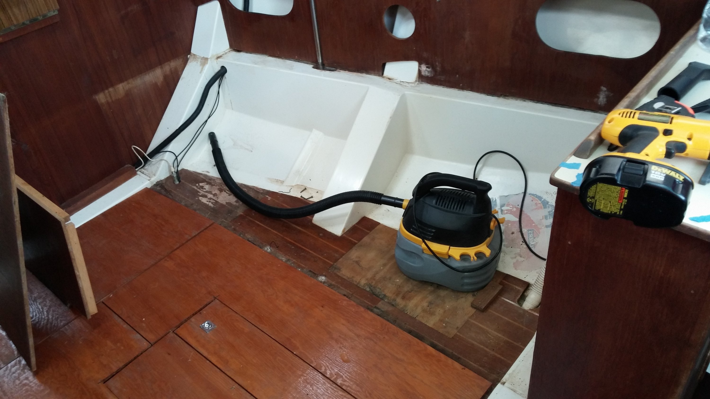

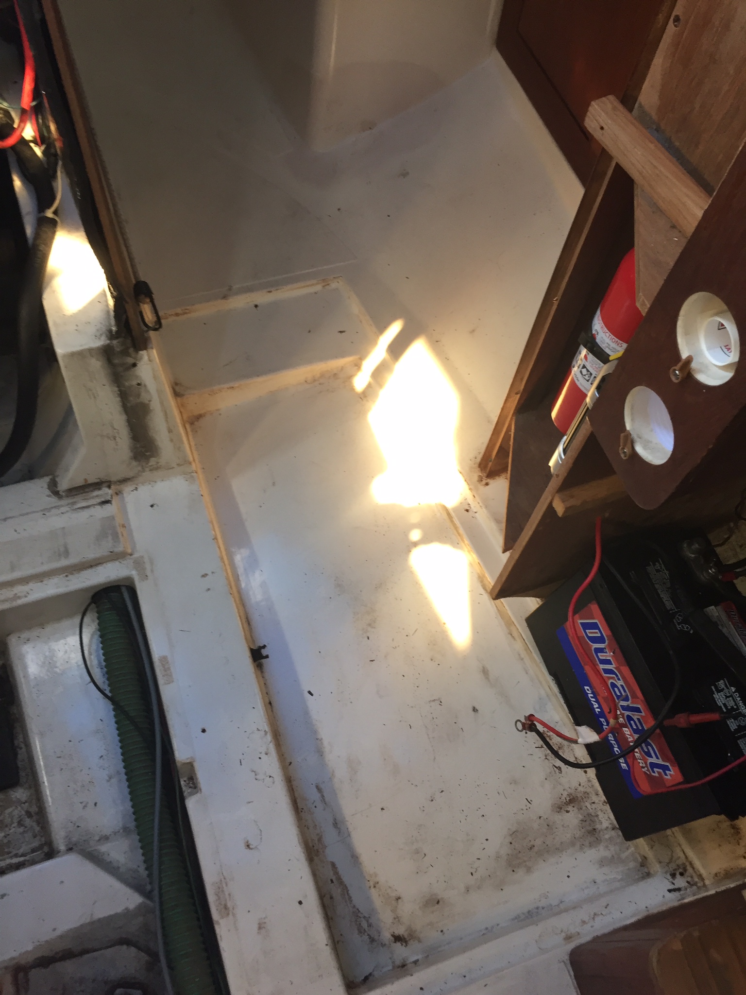

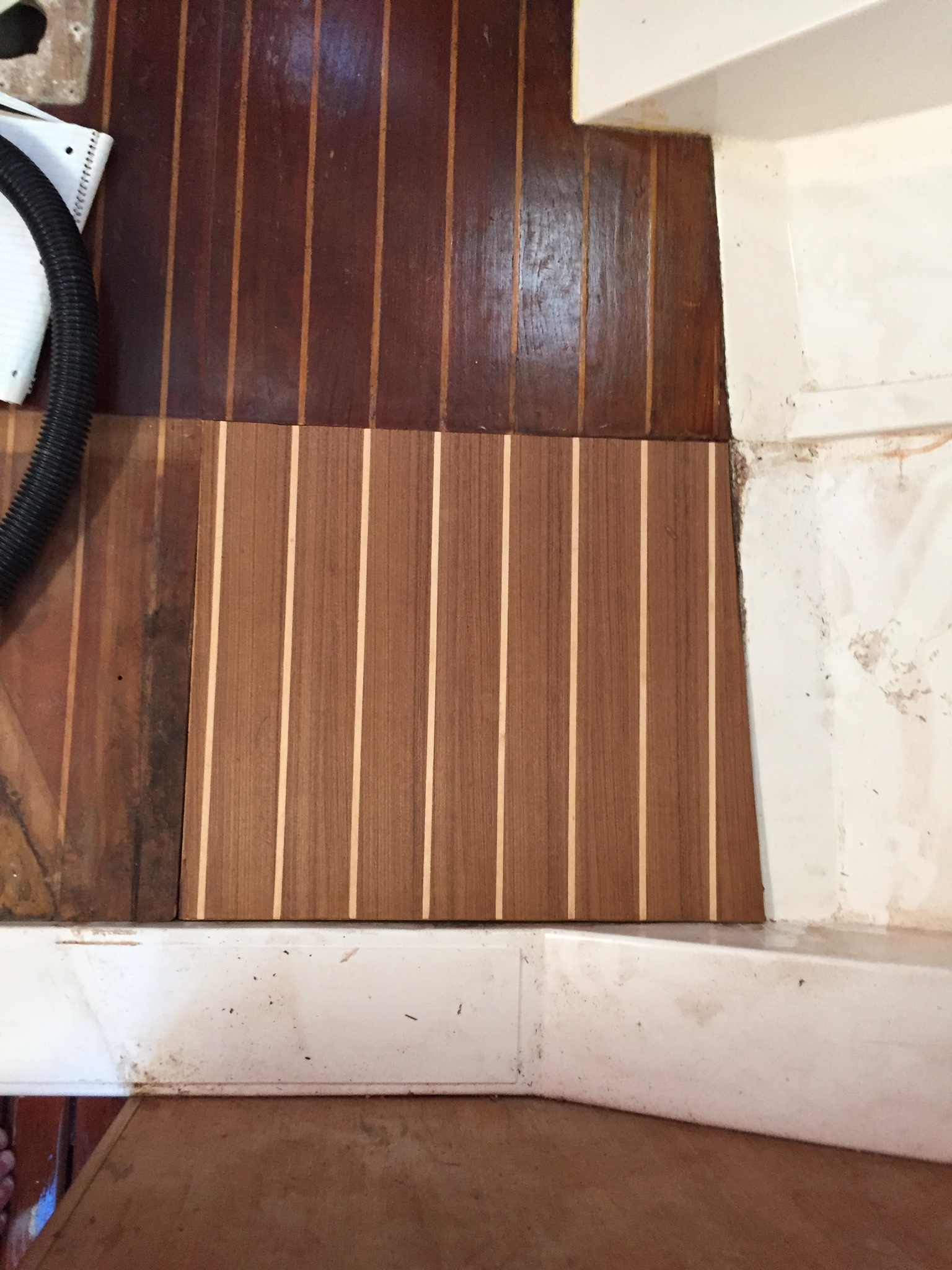

Well the project is finally well underway. The port quarterberth sole that I had to take out:

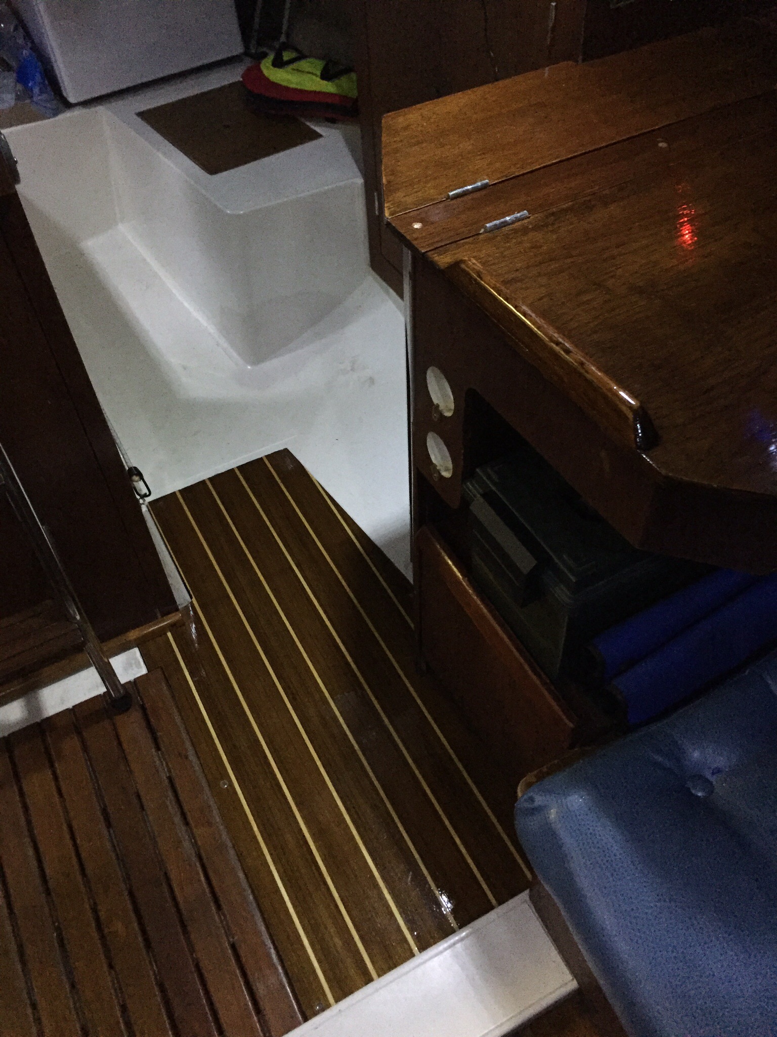

The replacement, installed:
The old galley sole:

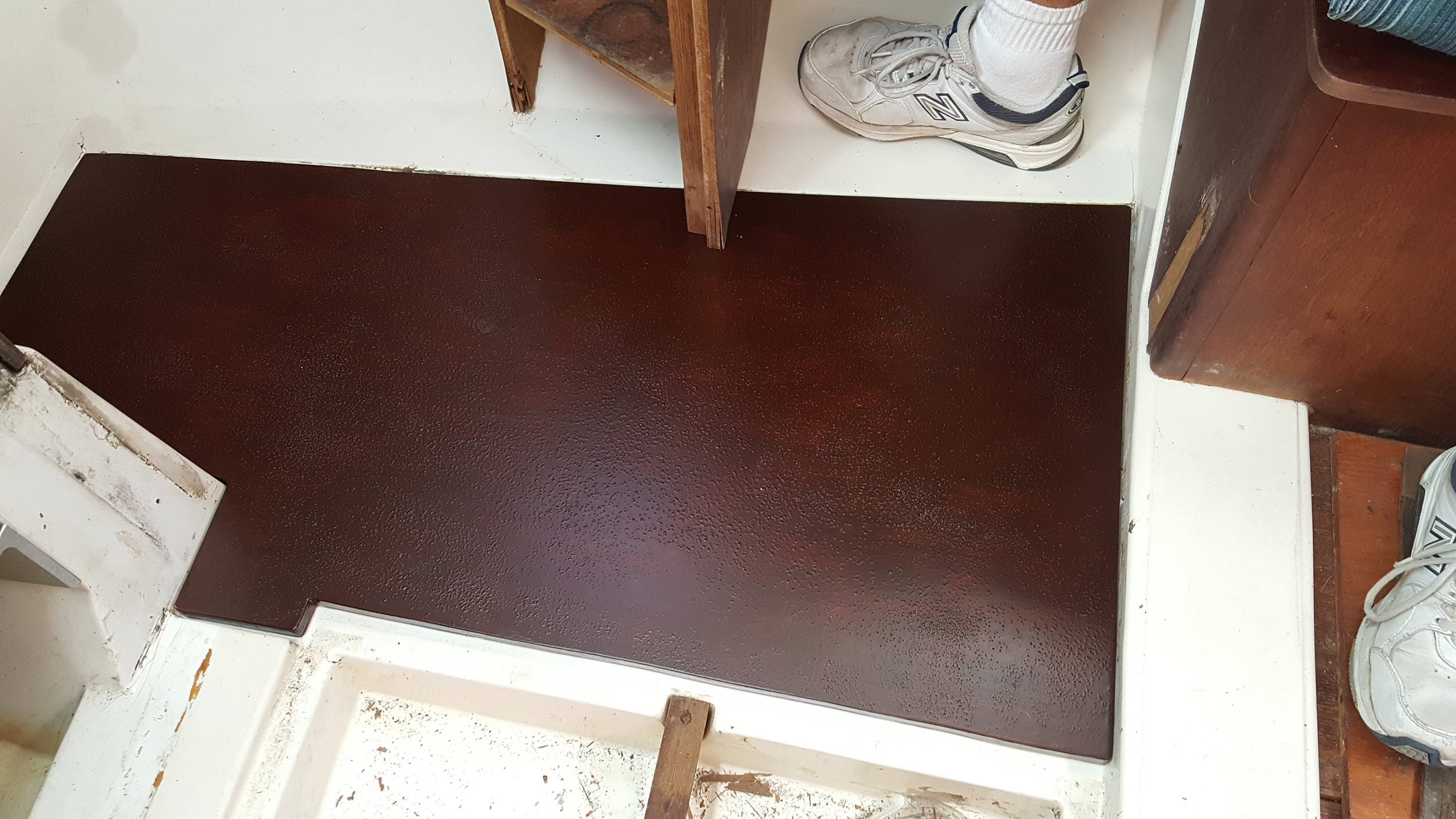

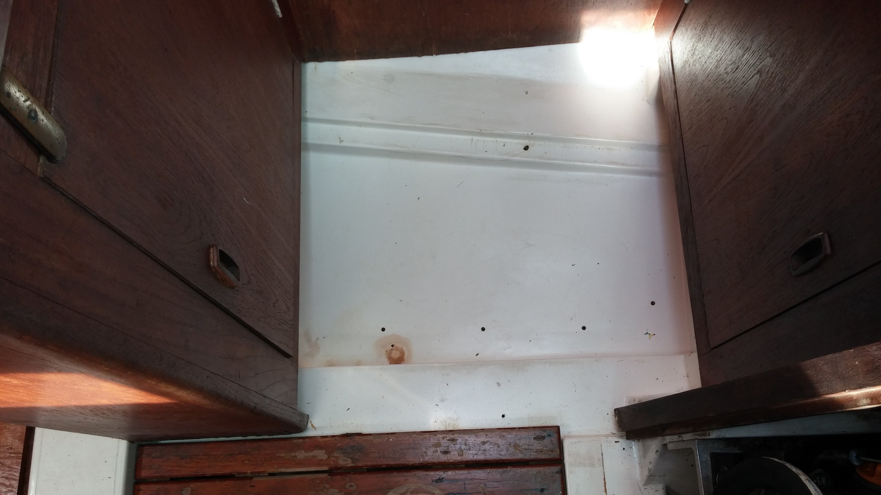

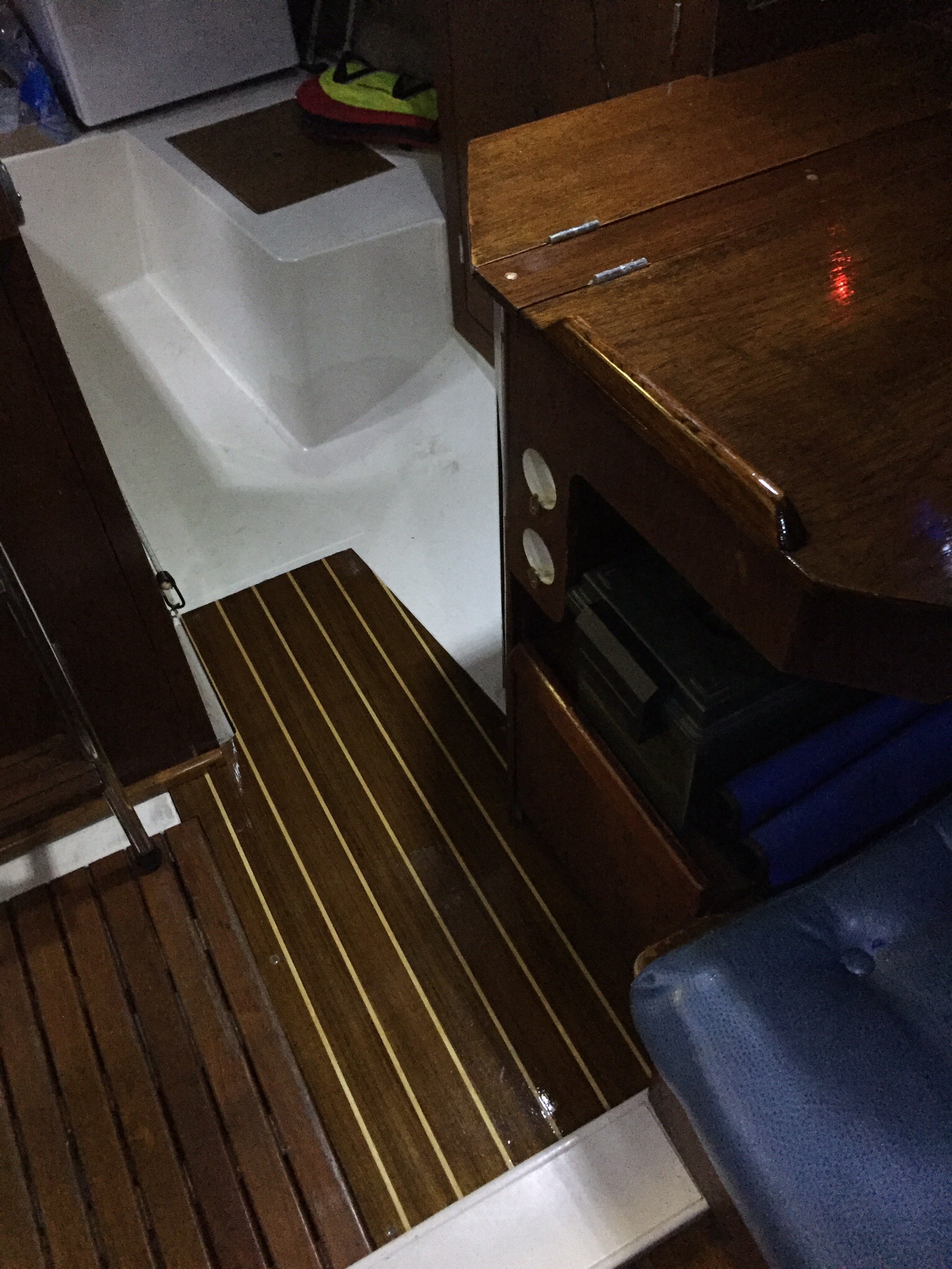

(Exactly! There wasn't one.) Here is the new one, installed:

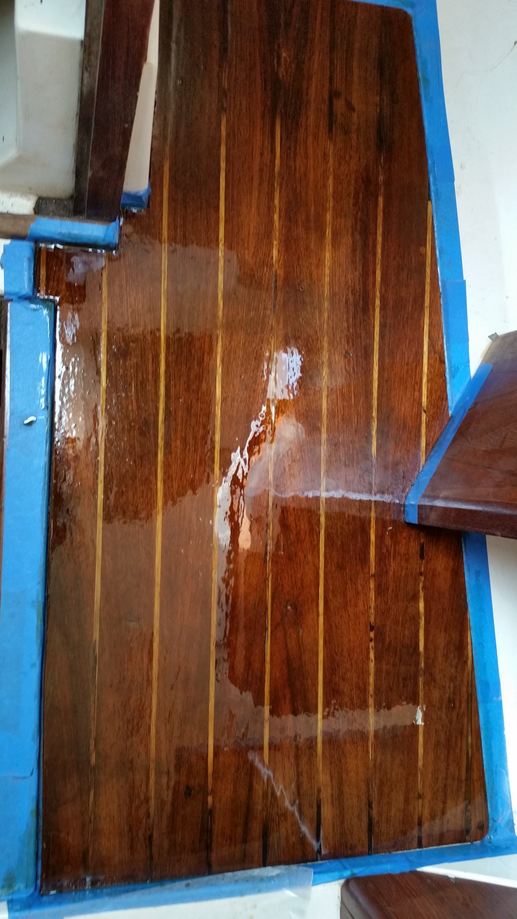

Material was 3/4" exterior grade A/B 5-ply plywood. I cut full size templates out of 1/4" luan plywood, and test fit them. Stain was General Finishes water based stain in Black Cherry. Then 3 coats of West System epoxy (I used the 207 Special Clear Hardener) on top, bottom and edge grain. Finish is Minwax Helmsman Spar Urethane in satin, as follows: One coat, dried and sanded very lightly with 220 grit, as per the instructions. Second coat went on, and while wet I sprinkled table salt fairly evenly (which was difficult) into the wet urethane. After drying, I removed the salt with water, and added one more coat of urethane, for a total of 3 coats.
For those of you contemplating this, it is easier if the cabinetry can come out. I was only moderately successful with that. I tried taking out the nav station, and could not find the last few screws that would have had it come out completely. Ultimately, I removed a panel (which you can see is missing, in the picture), plus enough screws and cleats came out of other places that I could lift it a bit. The combination let the admiral slide the finished panel in easily. Many thanks to HMT2, who has recently done this on his 31, and spent a lot of time with me on the phone, answering questions, texting pictures, and offering confidence-building suggestions, especially regarding the nav station.
So when it came time for the galley sole, I really didn't want to take the forward cabinet out, or even any of its individual panels. Instead, I just made the sole smaller, so it does not run under the midship portion of the forward galley cabinet. It's actually in two pieces, in case anyone is wondering how I got it in without removing the galley cabinet.
We didn't care about teak and holly, so I decided not to spend the money. I'm doing the whole boat, so everything will match. Once I started thinking about the total encapsulation with epoxy, I decided that marine ply was also not imperative. Yeah, there potentially are voids in there somewhere, but I checked all my edges after cutting, and found only one void, which I filled using a syringe and thickened epoxy. The salt for anti-skid was one of the ideas from another thread I started. Thanks for everyone's help on that topic, we tried lots of options, and this is the one we liked best under bare feet.
Its not perfect, but I am pleased. Panels are darker than other wood in the interior, because I ended up applying two coats of stain. I followed the application directions, but was unhappy with the unevenness of color even using the foam brush specified. A second coat helped a lot with that, but obviously overshot the depth of color. We knew we didn't want gloss on the topcoat, for fear of starting a cycle that had us constantly "equalizing" wood finishes instead of sailing, but after seeing the satin I might have opted for semi-gloss. Finally, we live in a condo, so I did all of the epoxy work and finishing in the same room that I had done all my sawing in. Consequently, there are blemishes in the epoxy coats and the topcoats from particulate in the air. But we don't care - look at what we had before.
Now comes the hard part, the main (salon) sole. Settees will have to come out, as the floor runs under them, and I'll have to decide where to cut the whole into smaller pieces, as a one-piece floor will not come through the companionway.

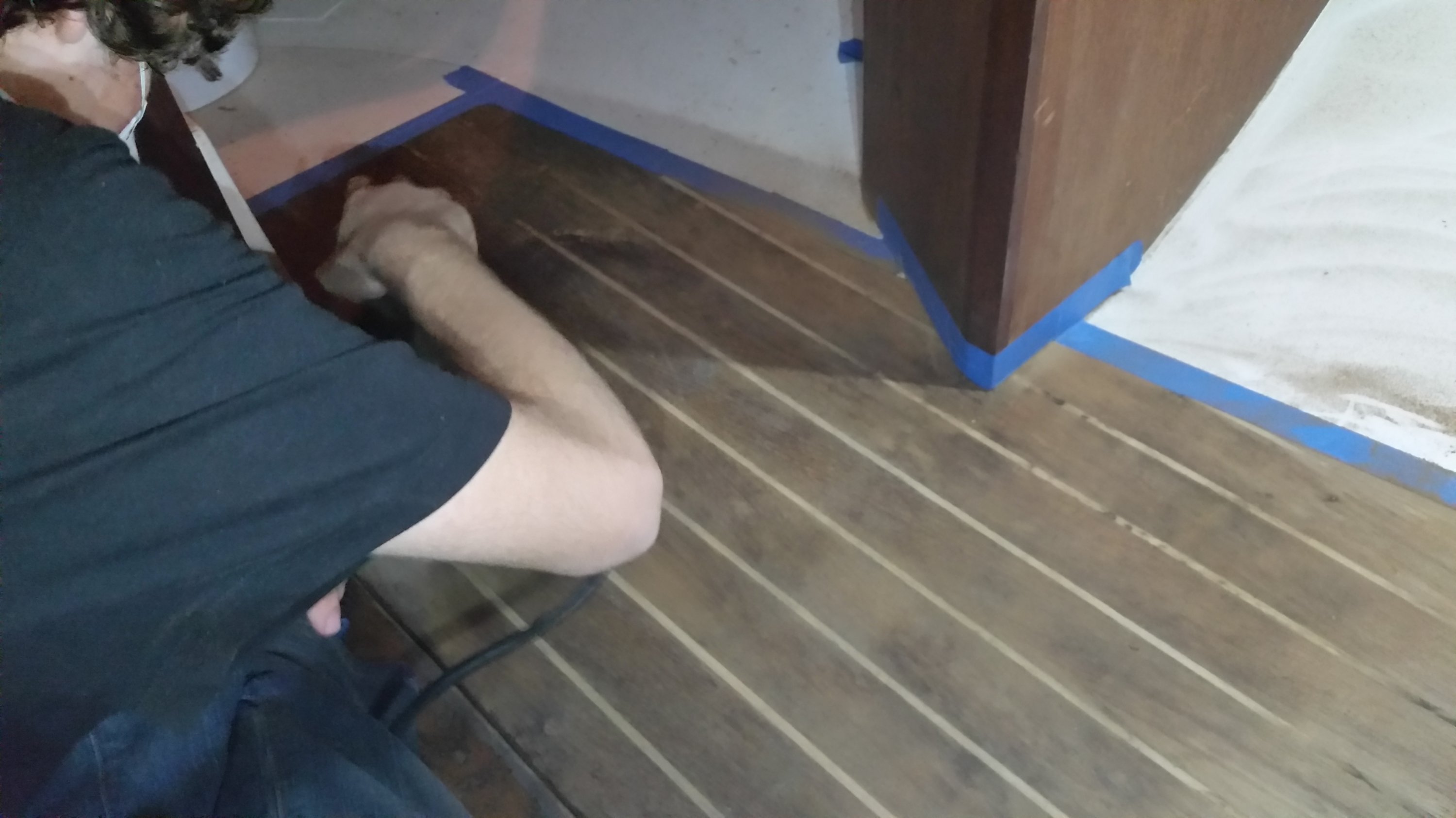

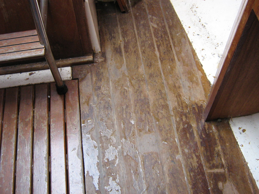

Ours was rough to start.
We refinished

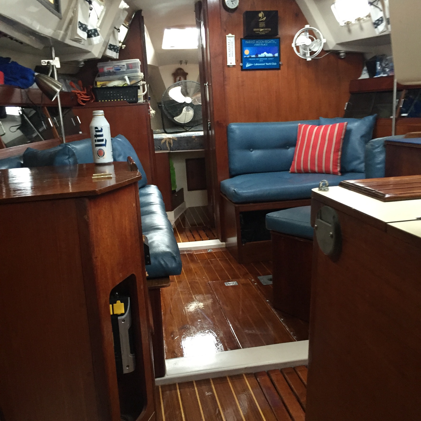

However, we recently had a hot water heater failure that went unnoticed for a week, resulting in complete de-lamination of this section of sole. How hard was the removal? Which screws of the nav station could you not find?

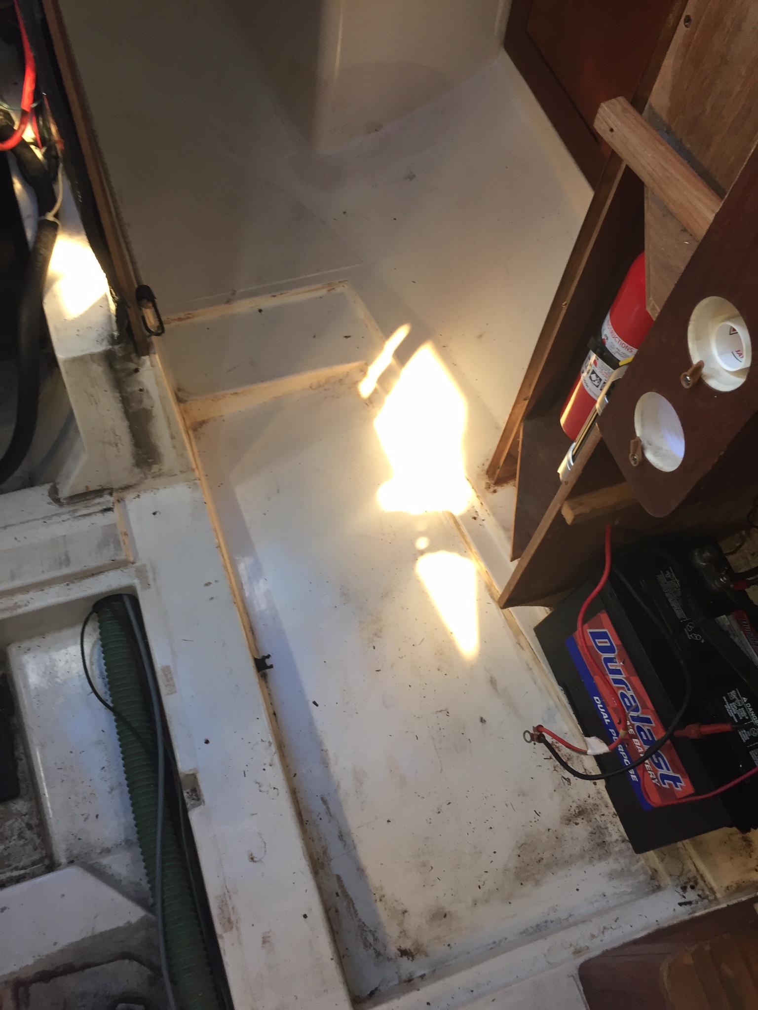

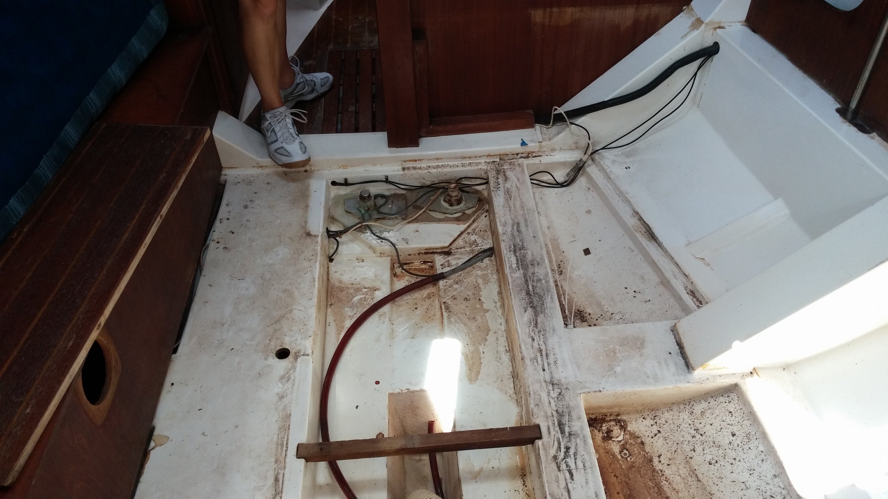

Ok, here are the latest developments. I removed the starboard settee (remember, I have only one on that side, not the U-shaped dining area) in about 10 minutes. It was necessary because the sole running underneath it was delaminating. The settee came apart in two pieces - the top (seat pan), and the front vertical panel. I took the top off by climbing inside with a head lamp and screwdriver, and found the applicable cleats. There was only one cleat, and I only had to remove 6 screws. (As HMT2 said above, cleats are the key when taking out furniture.) You can see a few of the screw holes in the lighter colored cleat along the top of the remaining panel below. Here is what it looked like without the top (I'm facing mostly starboard, and the bulkhead at the left is the head):
Then I removed the front panel. Access was a breeze with the top off. There were 4 cleats total: one trim piece of teak quarter round at the far left end (you can't see it); a more standard cleat on the other side of the panel from the trim piece, fastened against the head bulkhead (2 screws); an identical standard cleat screwed to the forward side of the galley cabinet (2 screws); and a long cleat running along the sole (6 screws, 2 of which were so badly corroded I used a speed extractor. Note that all of the fasteners were Frearson drive, not Phillips. Here is a pic with the settee completely removed:
The seat pan and the front panel are at the left of the picture, leaning against the head door. I was very pleased at how easy this came out, and even more pleased that I could get both pieces up the companionway and off the boat. They need work, as some of the cleats are in bad shape, and I need to craft a lid for the hole in the seat pan.
I agree with HMT2, the port settee will not have to come out. I should be able to pull the sole out from under it, as there is not a cleat attached to the sole on the interior. The total sole is one piece and will have to be cut to get it out of the boat as a template, but that's ok, it won't fall apart on me like the quarterberth sole.
All of those varnished boards are 3/8" plywood put in place by the PO for additional rigidity when the floors went soft. hey came off the boat today too. More pics tomorrow, as I take out the damaged sole. I've decided to set aside my terror, and make the cuts with a circular saw set (very carefully) to the depth of the plywood.

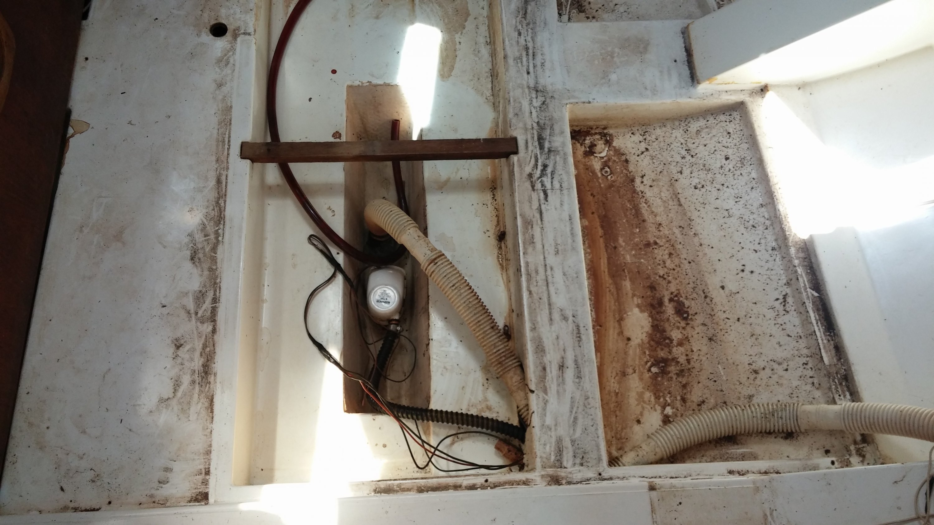

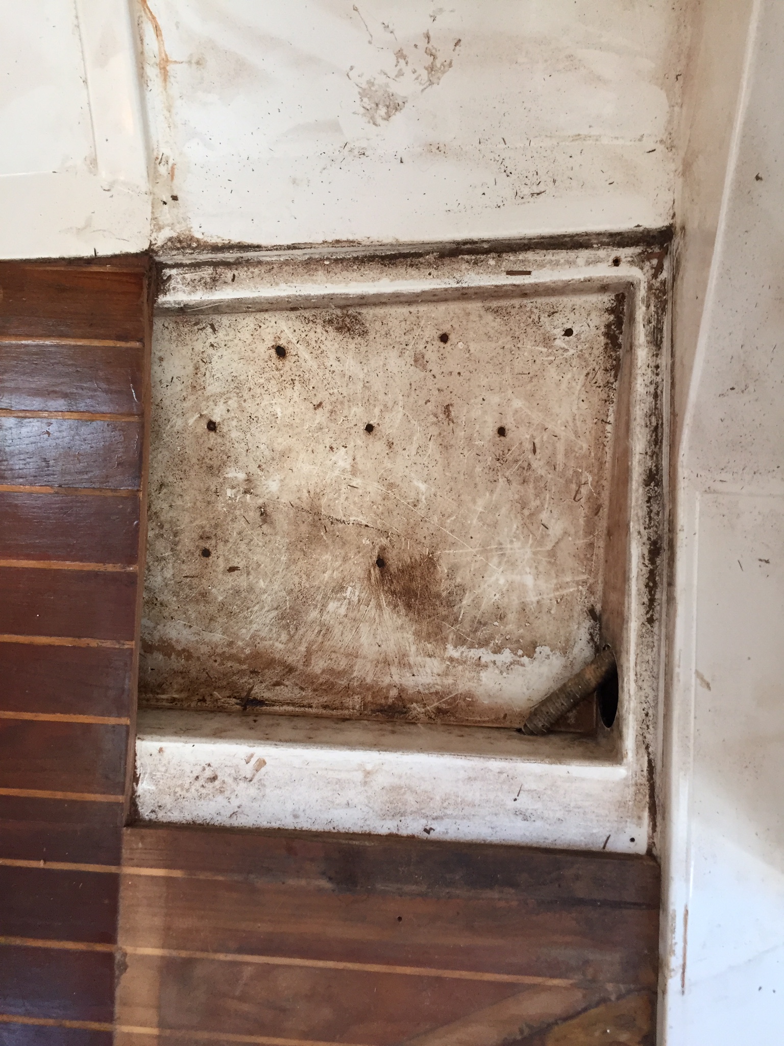

Made more progress today. After I pulled up all of the varnished boards I mentioned yesterday, I was surprised to find a removable teak panel just aft of the threshold to the v-berth. The panel was unsupported on two sides, and when I lifted it up I of course found one of the keel bolts. The Admiral asked what was under a round access plate just to starboard of the removable panel. Ta-da! Another keel bolt.
The entire salon sole came out in two pieces, and I didn't have to cut anything. The larger piece is the one that runs under the port settee. We lifted from the inboard side, it came free of the port piece at the seam line, and we pulled in the starboard direction until it came out. There were no fasteners, and it ran under the port settee about an inch. It was narrow enough to fit through the companionway.
The port sole had a total of four fasteners. Two were at the aft starboard corner, one was at the forward starboard corner, and one was in roughly the middle of those two points, along the hull near the bulkhead reinforcement (I don't know what that part of the liner is called). You can see the hole for that screw in the first picture. It was even narrower than the other side, so also came off the boat.
All in all we were really pleased, it only took about 30 minutes, including moving stuff around the boat to create working room, and discussing what to try first.
The plan now is to put back in a total of three pieces. The starboard piece will remain unchanged. The port sole will essentially be cut into two pieces along the axis of the keel, and the inboard half will be one long access panel to the entire bilge and the keel bolts. I've cut the template for the starboard sole, and am about to walk down to the boat and test fit it.
