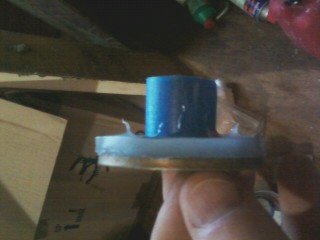

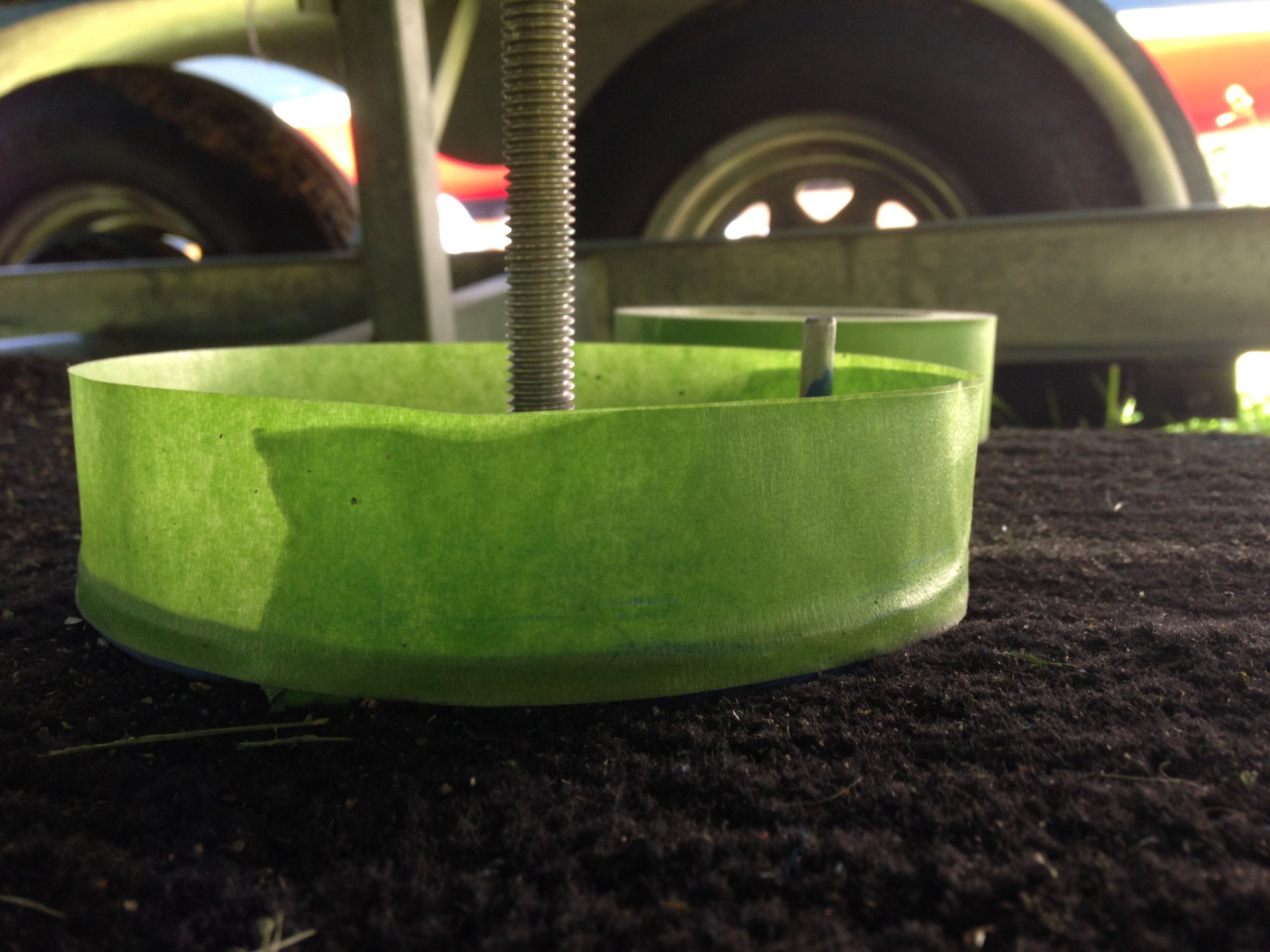

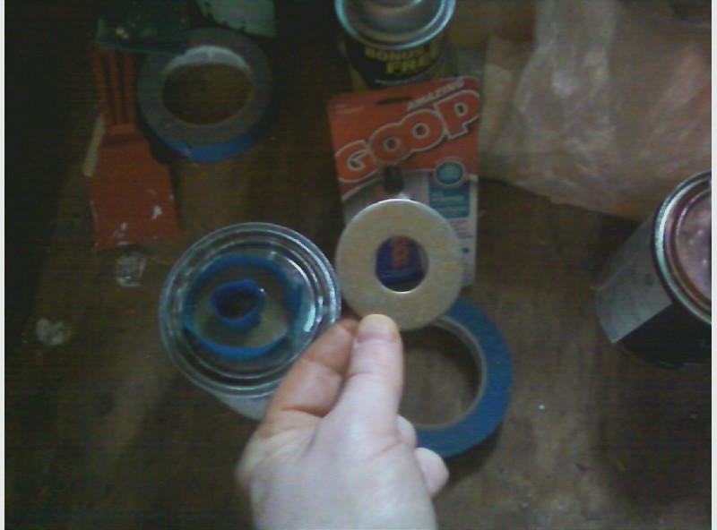

Goop dries into a very hard rubber. More than once, I’ve used it to construct gaskets. Here are some pics where I made a gasket for a swing keel pivot pin on a balboa 26
and the gasket for the ballast tank on a Hunter 26.
Likes: RoyS
