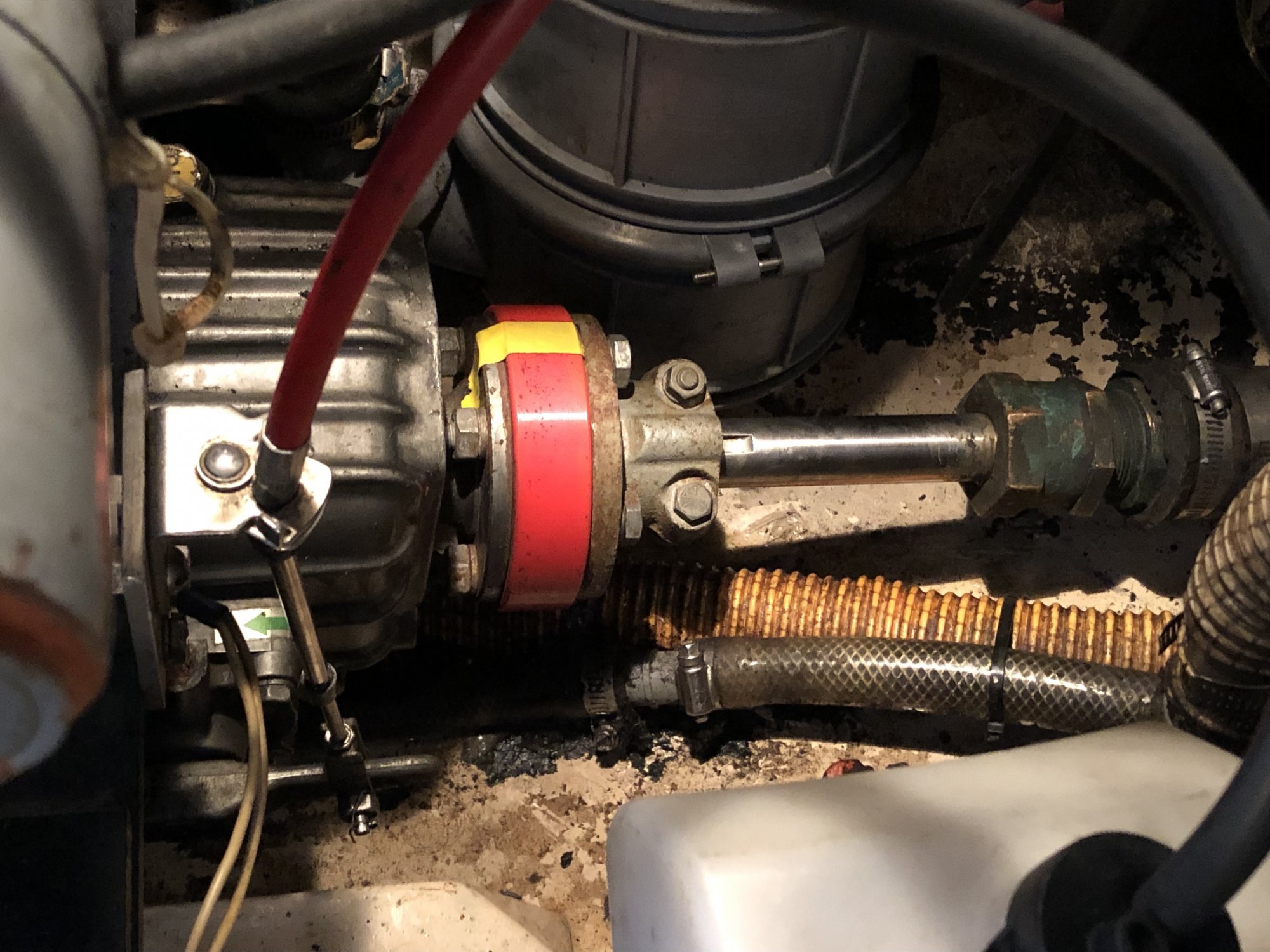

As for prop function in forward vs reverse, the odd part isn't so much the propulsion, but the fact that I can rev up to 3000rpm in reverse with no hint of vibration issue at all, and only 1100rpm in forward - so I think that eliminates prop shaft warp, and maybe alignment to some degree since I'd think it would cause issues in both directions? (I could be wrong though). That being said I would like to know what you think of the spacer because it seems odd to me as well - and maybe the issue is there is compression on it in forward vs. pulling in reverse?
The yellow tape was to help with the alignment.

The spacer is likely a flexible shaft coupling. These are often designed to shear if the prop hits something or adjust for minor misalignments.

That looks like some sort of flexible coupling. I think, in order to align it, the flexible core would have to be removed, and the distance between the coupling faces would be measured at four points, equidistant from each other. The .025 measurement would be too great for a fixed coupling.

Consider the possibility that with the spacer installed, the shaft may not have been shortened

The “spacer” is a shaft saver. When installed it is machined by a prop shop to fit perfect. Sheers if you hit anything that would damage your engine. It is not flexible. Have you looked at the engine while running and vibrating? Checked the engine mounts? Have a friend drive while you stay below with a beer and examine things. A
Missing or sheered bolt on a mount could cause vibration in forward and not in reverse based on direction and force of turning prop. Good luck.
