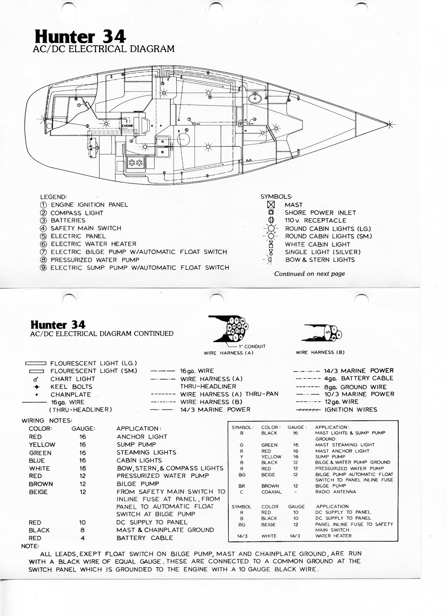

Most likely not original to the boat..
Battery charger maybe.but really could be any of a number of owner/dealer installed items. Note that the boat did not come with a battery charger installed from factory..Original electrical diagram:

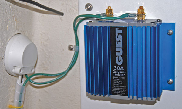

If it looks like this, then it's the blue box from the movie Mulholland Drive, open it at your peril:

As you can see sometimes the imaginations run wild when confronted with a "Blue Box" of unknown nature on this site.
Pictures might be helpful if you want a more cognizant response.
On the other hand if you are just trying to gauge the creativity of the sailors who frequent these waters you have not even scratched the surface.
