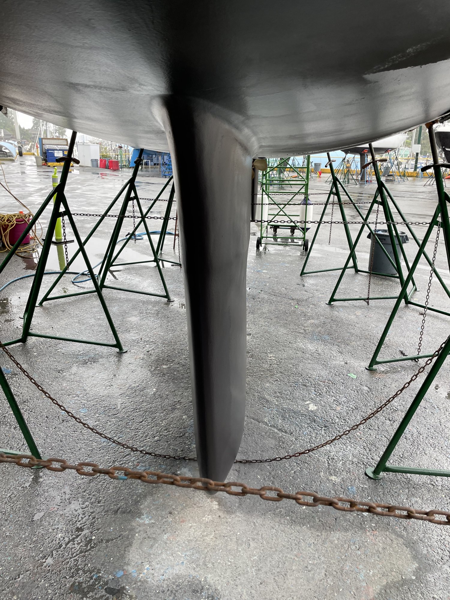

Hi, You mentioned the work might be done Oct. 19 so hopefully it has been delayed and this information is helpful. I had to remove the rudder from our 34 foot Beneteau in 2021. I was at the Thunderbird Marina, West Vancouver works yard. They used a term "hanging" the boat. We estimated the height needed by measuring from the top of the shaft and the yard people "hung" it on multiple stands. Had all the clearance needed and it was very stable. I don't have a picture but in 2023 I needed to get under the keel on my Hunter 36 so I asked them to "hang" it. See the attached photo. Not quite as high as needed to remove the rudder but it gives an idea of how they place the stands.
