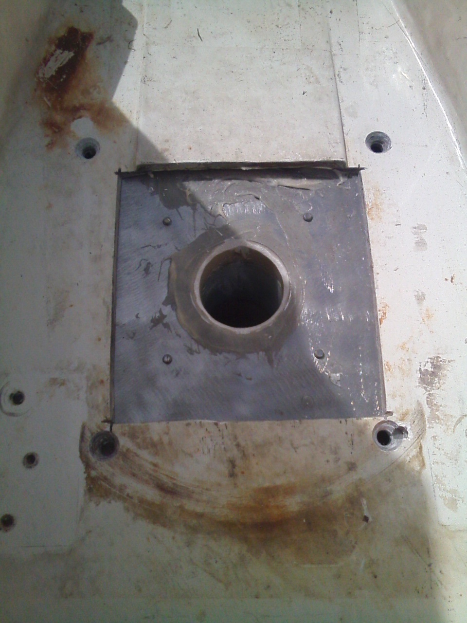

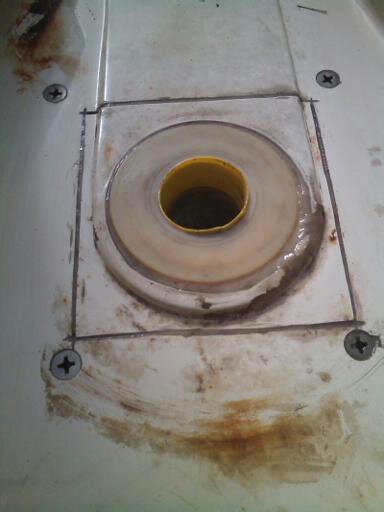

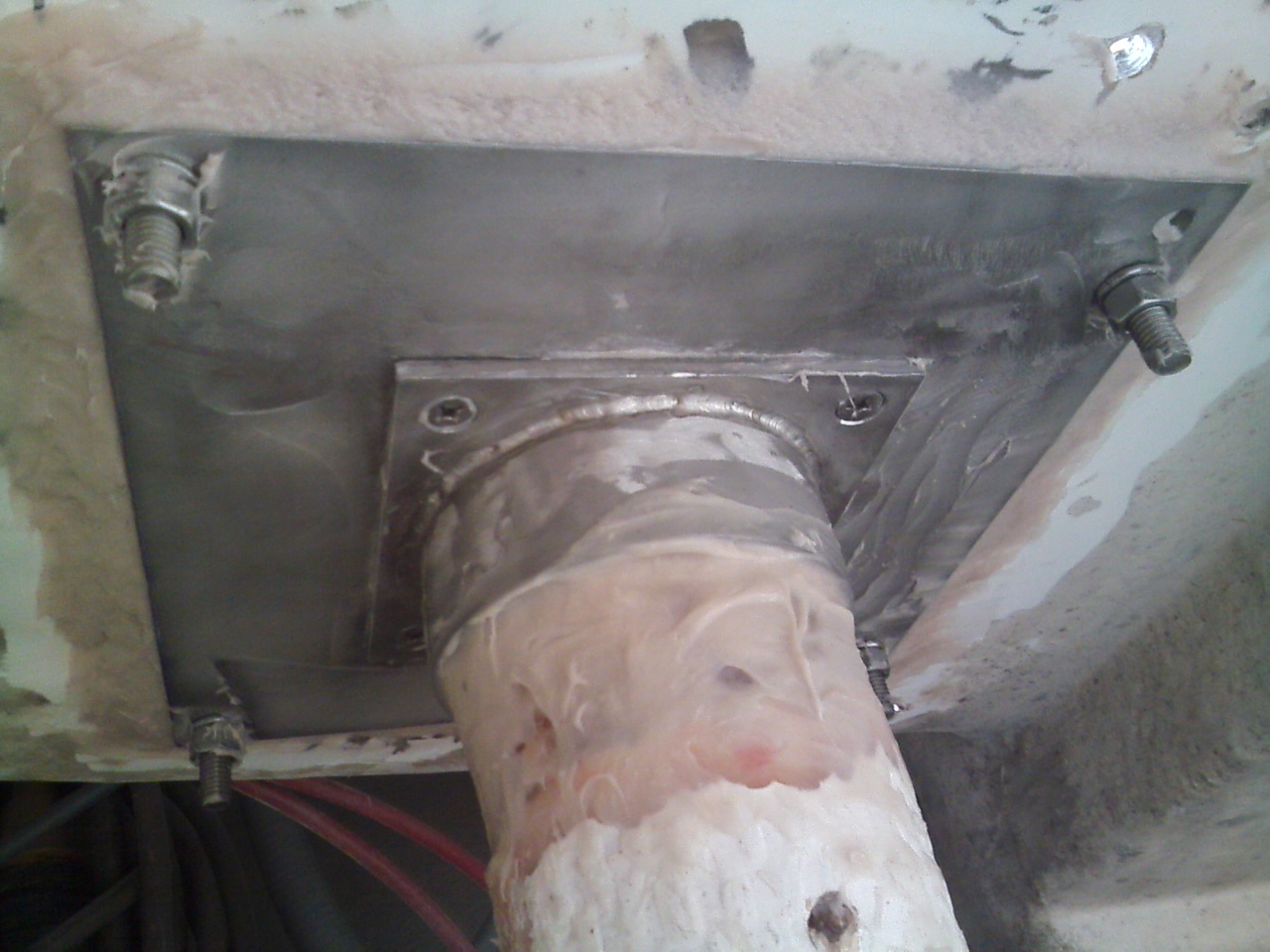

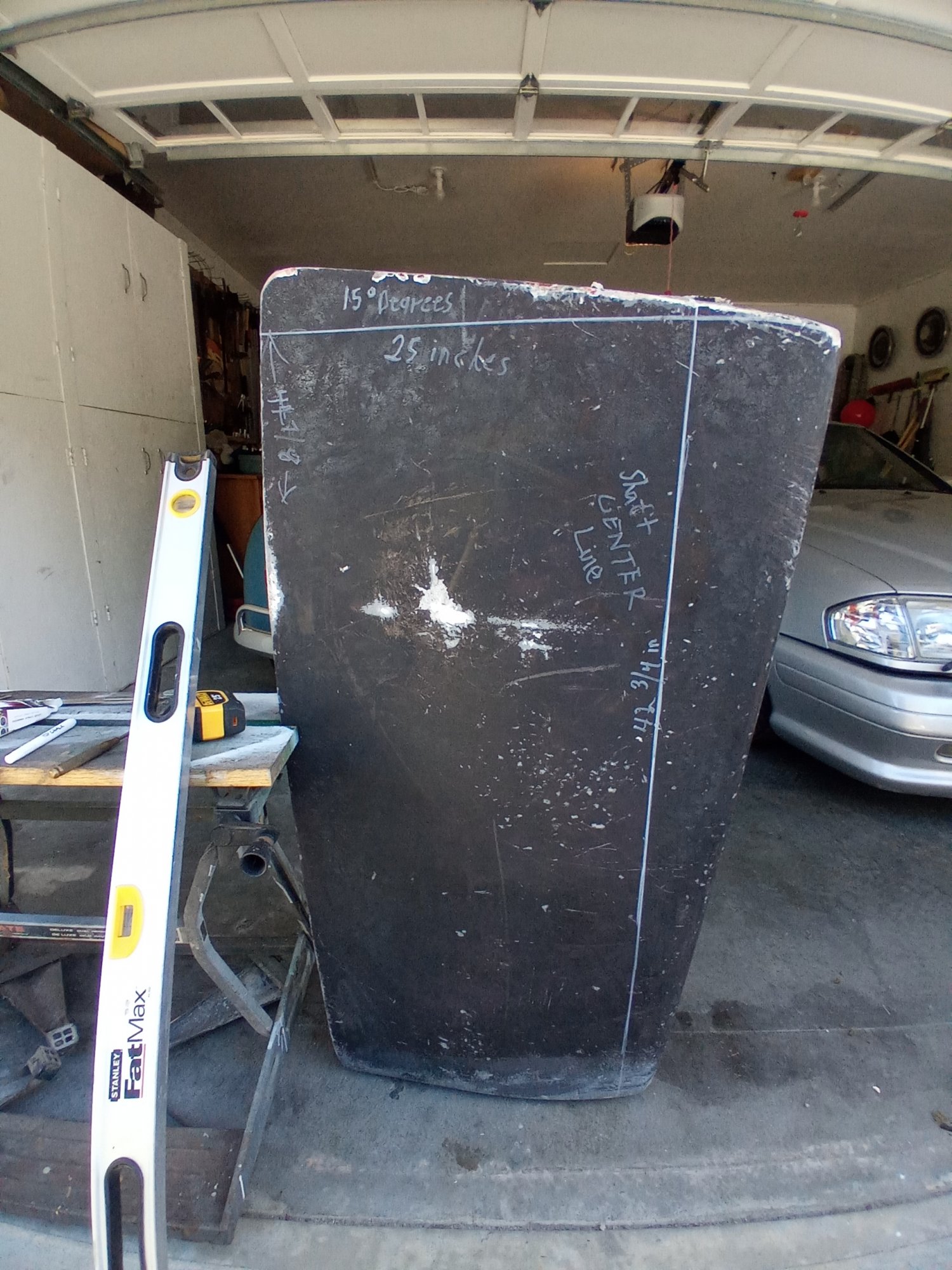

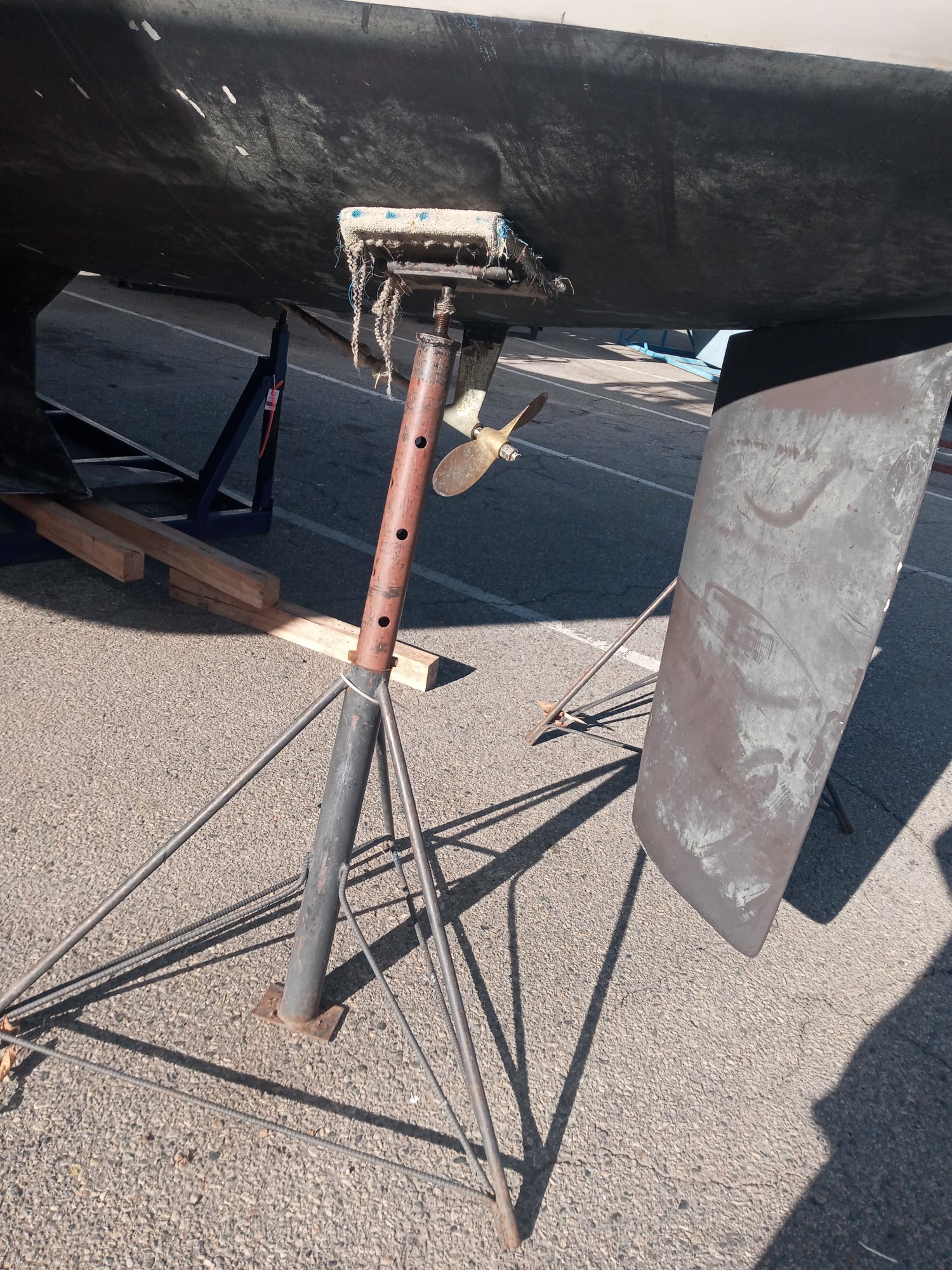

When I bought my Hunter 28 the wheel was hard to turn and had lots of looseness when heeling. At inspection we could move the top with the quadrant sideway 360deg.
When the boat was hauled out and on the ground and after hard work taking off the quadrant (bolts rusted/jammed!), we found that the hull was broken around the shaft and the shaft tube was separated from the hull!
Since we were on gravel ground, we asked the marina if we could dig under the rudder. We had a yes and we were able to slide down the rudder for repair.
If you cannot dig under it, measure the distance from top of quadrant to bottom of your hull where it exit, to get the height you need to lift your boat.
Maybe you can also take the shaft off with the quadrant from the top of the boat to measure the shaft before haul-out. But check if the rudder tube is waterproof not to sink when you remove the shaft!
Attached are pictures of the repair/reinforcement I made to the upper bearing of my rudder to make it "bulletproof". Unfortunutely I did not take pictures before repair.

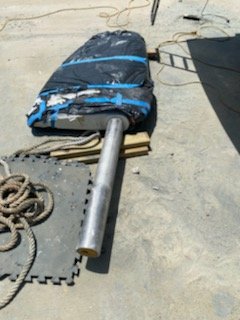

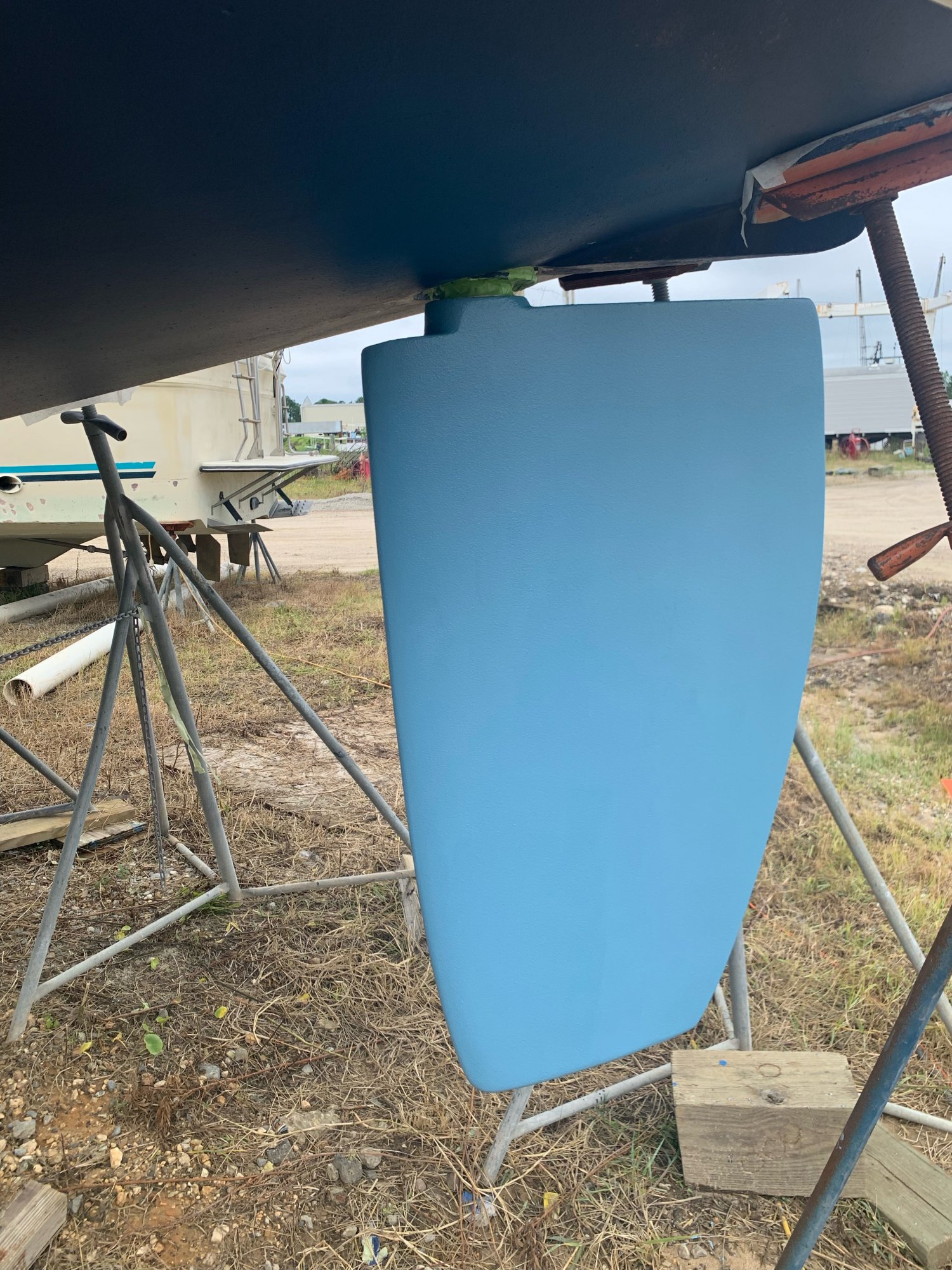

Foss Foam and New Rudder are basically the same company. In addition this forum store should have the build list gf parts. First call Al or mike at the forum store and ask for shaft size and length. Then call Foss Foam if the forum store cannot get one made for you. You do have the old rudder
I bought this at SBO shops, and fit perfectly
Repairing boat after Hurricane Zeta
Look above link.
Jim...
PS:
