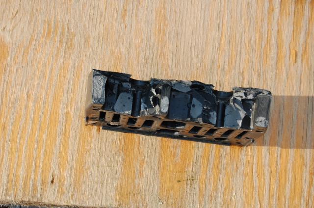

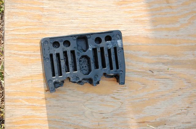

My outboat motor bracket was looking a bit under the weather so I purchased a new one. On the first trip out, today
the polyboard mount broke in half and down she went...and I dived and caught the battery cable and got a hold on her. After getting it secured to the rail with lines, I took a break and called TowBoatUS and when the skipper arrived we were able to get my new Nissan 8hp on board for the trip home. I did lose the cowling in the process.

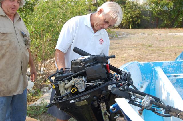

The good news is after applying first aid, which ment frest water flush, remove plugs, drain oil (water present) , flushing with Kerosene, removing carb and flushing with fresh gas, hand cranking and applying PB Blaster into the clynders....hand cranking some more and then she fired right up and ran a little rough for about a minute before smoothing out and running like normal.
I let it run for about an hour tonite and will keep running her for the next week for about an hour in the morning and again in the evening.
Now for a question....Has anyone ever had any poblems with braking one of these polyboard motor mounts? From the look of mine, I think it was a bad injection mold batch....the weight of the motor is 85lbs. and the bracket is rated 118lbs.

I would be on the phone with the provider (or manufacturer - or both) of that bracket discussing reimbursement for trouble/expense caused. It would be nice to know the brand so we could avoid buying one like it. I have never heard of that happening before.

Definitely, a call to the manufacturer is in order... Document everything. Also, a call or letter to BoatUS about the problem is in order as well. They are very good at getting resolution to defective products and forcing manufacturers to issue recalls.

The bracket rating is "safe working load"? What did it look like before it broke?

You mensioned 8HP and gas driven motor. Judging from the photo of the motor - it looks just like my motor. I have a 4 cycle gas engine it weighs 118lbs but it is 9.9HP. My entire mount broke - fortunatley it was when I was towing it and I did not loose the engine. It had a 2 stroke engine before. What I am getting at is that a 2 stroke engine of the same horse power weighs half as much. So I should have replaced the engine bracket with a stronger one when I changed the engine. I learned the hardway. So I believe the reason your engine braket broke was because it was carying 118+ lbs and it was at its limit. I guess I am wondering if your 8HP engine is really 85 lbs.
Very , Very Shinny....it was brand new...!
Discussing brands I don't think would prove to be prudent at this time.....That sorta sounded like G.H.Bush didn't it...well I will get back to you about the brand as soon as I have first given the maker a chance to do the right thing.....or not.

I did take that in consideration. I have sprayed the inside of the recoil and under the flywheel before every starting attempt and I am hoping it is getting thrown around under there enough to cover all the nucks and craneys.
I must state here that this is not my first time with submerging outboards....I have sunk a few boats in my day through both equipment failure and acts of stupidity.

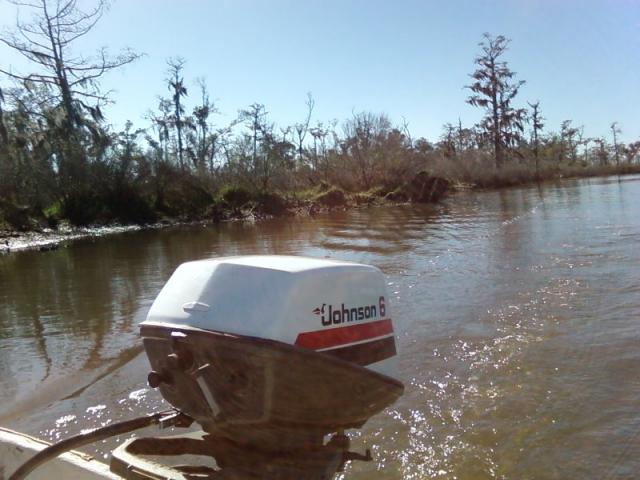

I think you got it correct, Mike.. Speed of attack and not letting it sit in air before applying a water displacer after the rescue is paramount! Look on e-bay for a used cowl .. ya might be able to save a few dollars.. The picture is of my 1967 Johnson; cowl was repainted a few months ago and some non-oem decals applied..

Is it possible that the motor hold-down screws were over tightened, causing the bracket material to crack? Not that I'm saying it's OK for the mount to crack under those circumstances, just wondering.....
