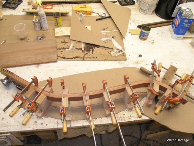

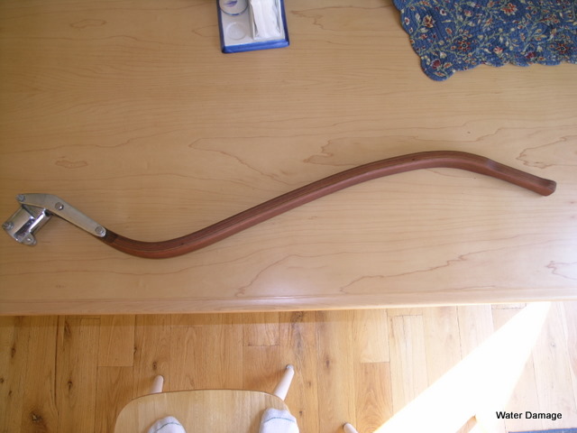

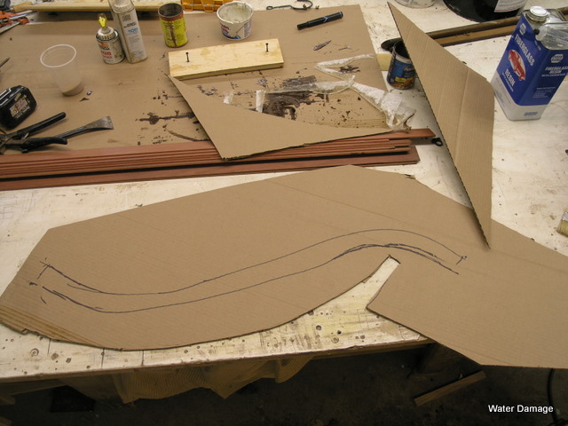

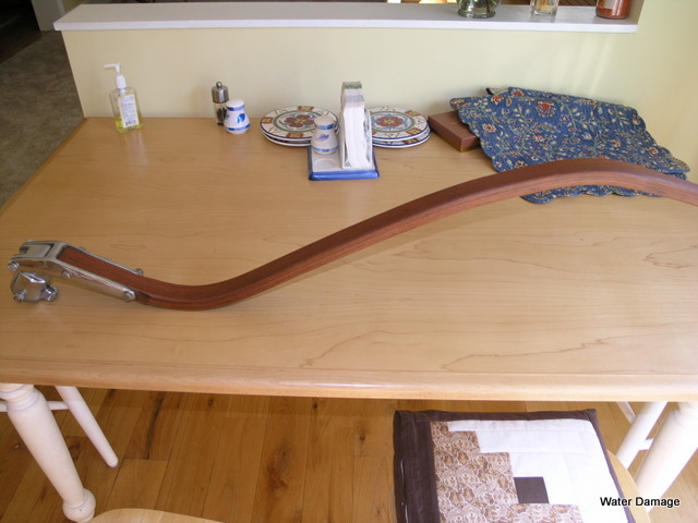

Well here it is from template to finish the new Tiller. And it will even be usable as it will go up and over the wheel unlike its predecessor.
I tried some thing new I used Ipe and Cypress in alternate layers. I have literally tons of the Ipe. Milled the strips sanded with #60 grit for teeth cleaned all with Acetone and glued up with west system epoxy.

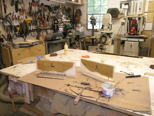

The other two pieces are the motor well stringers I glassed them and then put on a second layer when I installed the in the boat.

What a beautiful tiller. I want to make one just like for my O'Day 25. My straight tiller keeps banging the wife's knees whenever we tack.

geez, what I wouldn't give for a shop like yours.
Jun 16, 2010
98
Lancer 25 Newbergh
Yup its great when I'm working on my stuff the rest of the time its a job.
