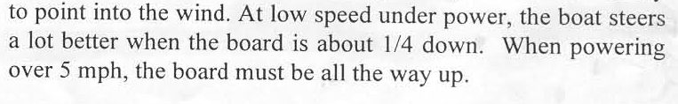

With the rudders up (or not present) and the centerboard up (Xs have a centerboard, not a daggerboard,) my X wanders around while motoring as well. There’s not enough structure to grip the water to provide tracking. MacGregor advises us not to use the rudders or centerboard at speeds over 6mph. However, I find that dropping the board about 1/4 of the way steadies the boat a lot. I am not an engineer or boat designer, so do this at your own judgement and be careful, especially when turning sharply.

It is VERY important not to use the rudders or centreboard in down position when motoring any speed above this, particularly IF you have emptied ballast with the intent of reaching higher speeds. I will sometimes run with the centerboard down about 2 inches showing below the hull at moderate speeds but even at that you must be careful particularly when turning (don't turn sharply)

I read in the 26x manual (curious) that indeed the boat is extremely unstable at higher speeds if the rudder is down or the centerboard. But they do say to put the CB down about 1/4 when going slow.
