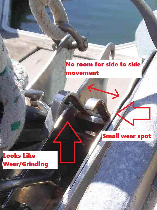

Rardi,
I suspect your failure was caused partly due to the side loading imparted by the anchor / stem fitting. On the right side of the photo you can see what looks like where the fitting has been rubbing/pushing against the roller. This is not how the fitting is intended to be loaded. They are designed to be able to move side to side to accommodate some movement and the roller interfered with that from, the looks of it. Course beyond 10 years its anyone's guess..........

Dear Maine:
When I responded to Ed yesterday, I did fail to recollect your "side-to-side" comments that you originally observed (and posted) last July. But I certainly picked up on them back then ...
... And I factored them in when I installed the new (and beefier) double-jaw toggle replacement fitting. Using Dremmel tool cut-off wheels (which were small enough to fit into the area) I cut off part of the offending side plates adjacent to the toggle. Not all the way to the bottom plate, but low enough that the toggle is now free to articulate side-to-side better without hitting the side plates. The anchor roller part on the left is no longer used since a P.O. installed the much more robust one on right. I also ground the right roller's side plate a bit also to allow more room articulating space on that side. But really very little so that structural strength for anchoring wouldn't be compromised. Then after the cutting/grinding, I applied our favorite "Spotless-Stainless" to passivate the newly exposed and rough SS.

Rardi & Sandpiper--
I agree with the use of the toggles and specify them everywhere they should be. However, on my boat (and, according to the photo, I believe, the boat in question here), the tang or chainplate blade on the boat's bow is oriented athwartshipswise-- the clevis-pin hole faces forward, not to the side. So the fork of the stay's lower end is already articulated for side-to-side by virtue of the clevis pin; and as to fore-and-aft, the tang or chainplate, which is already a bent blade of metal, will just bend farther, into its desired shape, by the rig tension (as the one on my boat has done).
The most important orientation for articulation is that of side-to-side. If the forestay's tang or chainplate blade were oriented fore-and-aft, so that the clevis-pin eye faced sideways and not forwards, you would want articulation for the side-to-side movement, without which the rig would be incorrectedly stressed and, ultimately, would fail. (This is a very unusual case, because of how tangs or chainplates are attached to the boat itself. Having a fore-and-aft-oriented tang at the bow of the boat would probably mean a forestay set well back from the point of the bow.)
On the boat in the original post, the forestay already had side-to-side articulation compensated-for because of the orientation of the tang/chainplate blade from the start. The sailors' problem was that this articulation was impeded by the location of the anchor rollers. The example is a valuable one because it illustrates the potential damages of 'second-guessing' or risk-taking in the decision to override the proper conventions for rigging attachments and tensioning and so forth. It's particularly a boon for the rest of us because no one got hurt in the illustration of the lesson.
