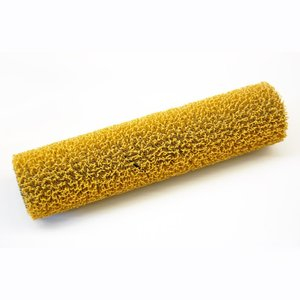

I had purchased the special Kiwigrip roller with the product but while I was at the hardware store having it tinted, I spied some 3 in wide stucco rollers similar to the photo. These rollers have smaller loops so much less 'open'ness' to them. I thought they might produce the degree of grip-i-ness (sorry for the technical jargon) I was looking for.

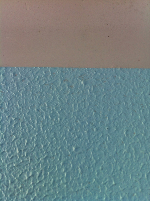

I found that I could actually use the small loop roller to apply the product to areas that I missed with the spreader. The texture created was exactly what I was looking for.

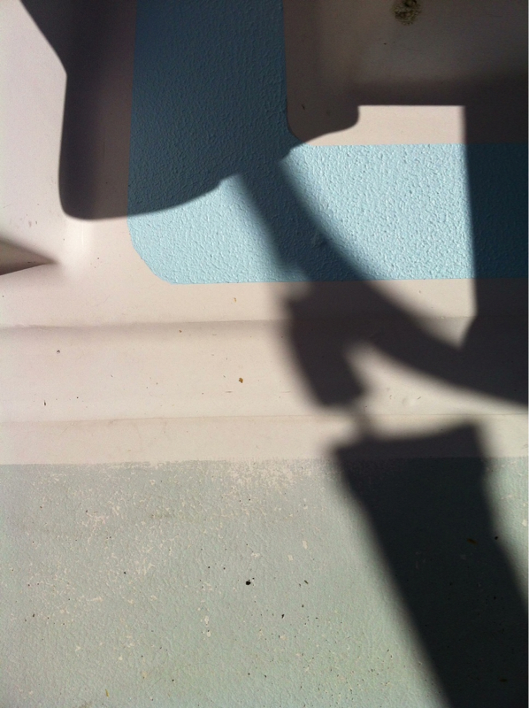

All in all, very impressed. I've included a side-by-side of old and new and a close up of the texture. Not happy with the new colour but that's easily fixed.
