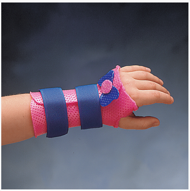

True, but you can still make orthopedic devices from it. She made this $143 splint and many others like it out of plexiglass for people.
Oh sure - in fact probably far better material than PVC... It's just that boiling PVC in water probably isn't going to work to soften it unless you are using soft PVC....

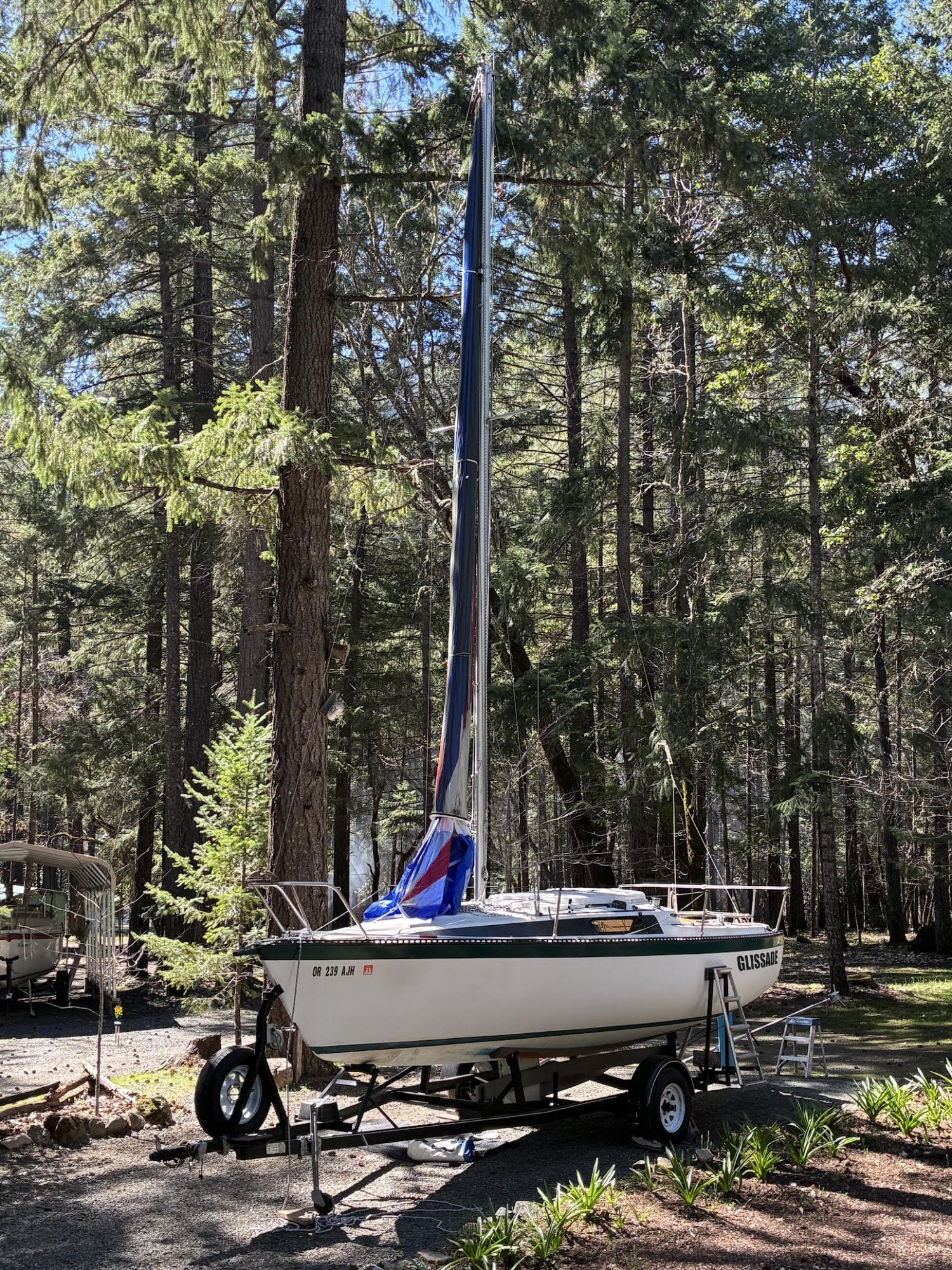

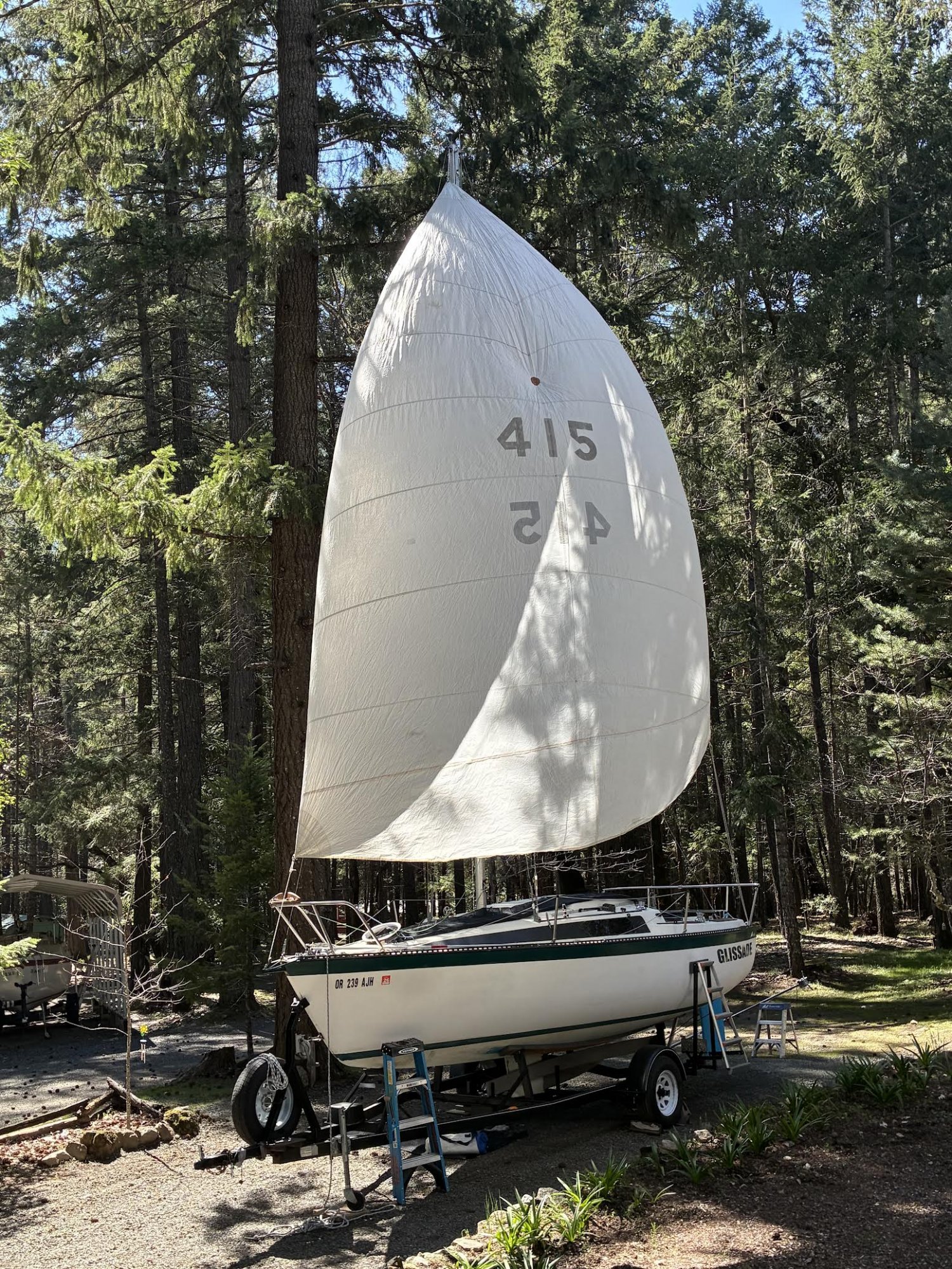

I've played with the deck mounted sock system a bit more but discovered an issue. raising is fine, but when dropping, by using the belly button attachment, the bottom half of the sail would be in the water before the belly enters the funnel. (BTW the belly button is actually at the mid point of the white "prototype" sail, it's a bit of an optical illusion in the photo).. huummmm. I'll play with this more later and maybe add a second line lower on the "prototype" sail, as I still think this has merit, but for now I think I'll stick with my original sock as it seems to work great in my driveway ;)
