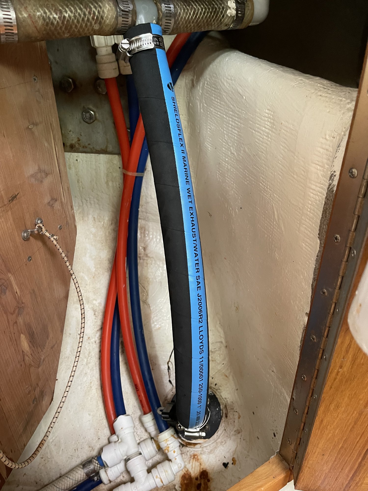

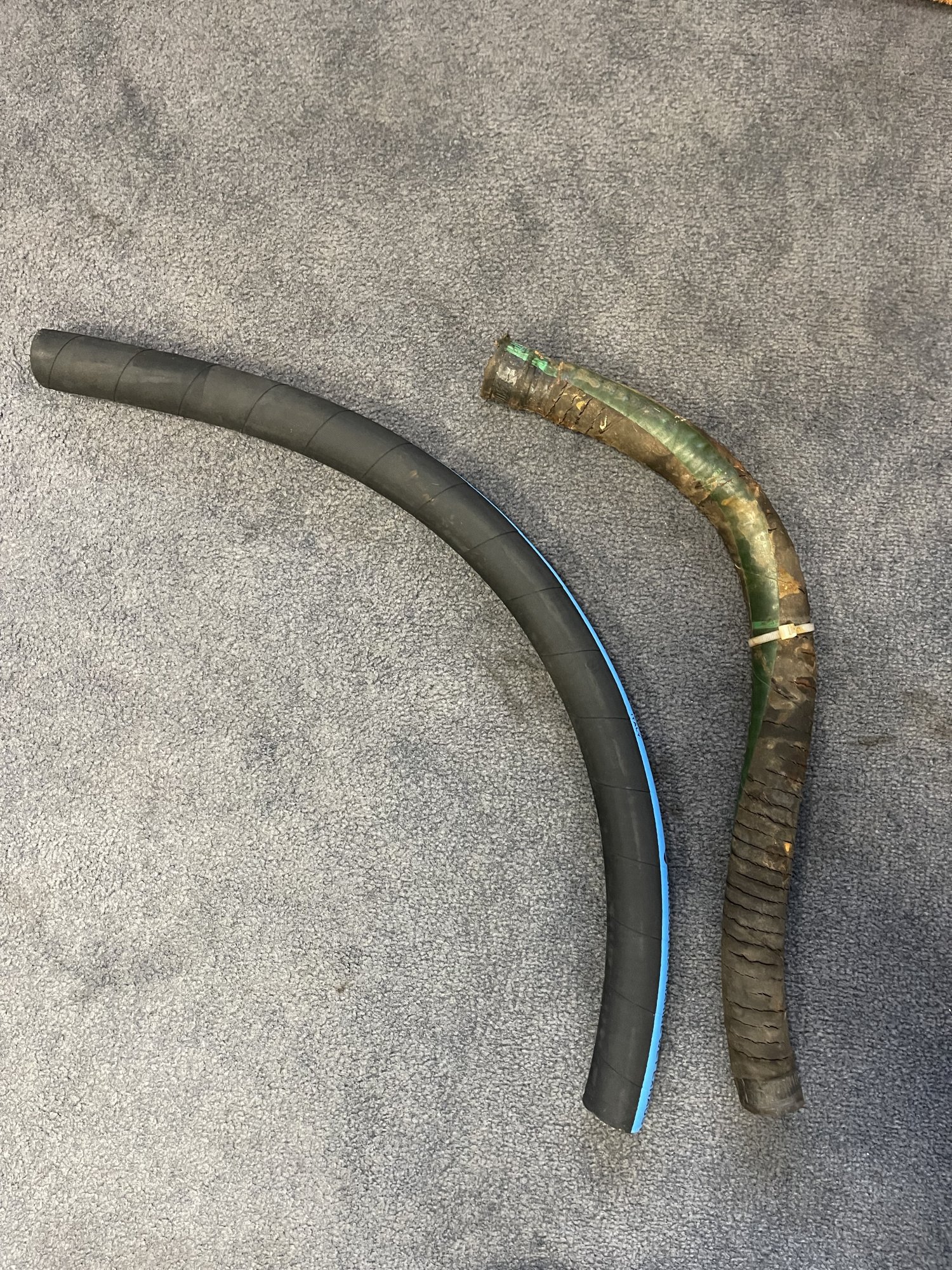

I just replaced the hose going from the galley sink to the thru hull. The guy at the marine parts store gave me wire reinforced exhaust hose. Is this ok? A lot better then what was there (hose with a stamped date of 1998 ) this is one of the requirements from the insurance company for immediate replacement and for good reason.

Wire reinforced hose for this application is overkill since there is no issue of the hose collapsing under pressure. All hoses should be doubled clamped below the waterline. Good luck great boat

My catalina has fiber reinforced vinyl for the drain. No issues in 31 years. On your boat, I'm guessing Catalina used exhaust hose because it was what they had on hand or someone was too lazy to get the vinyl stuff from the stockroom. Is this the boat that was in your family for 20 some years?
It's OK for the next 100 years anyway.
The only problem I can see down the road is that the interior of the ex. hose is rough and may tend to allow grease, fat, bacteria and other enchanting substances to stick to the walls of the hose. Reinforced vinyl is slick and doesn't hold waste products.
