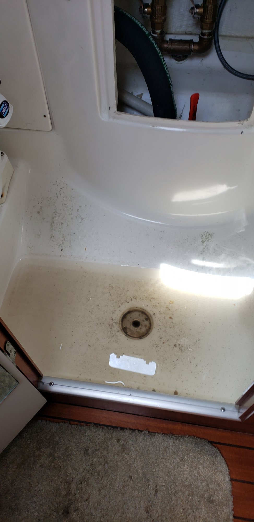

My 2003 Beneteau 411 shower floor drain is stop up. Does anyone know where the valve is located to release the water. My subpump does work.

Yes I have. What I learned today is that the switch is connected to a pump. There is a hose that lets out to the bulge area in the floor. Once the water has risen to a certain level, the bulge pump will come on and pump the water off the boat. 'What is happening with my situation is the water isn't being pump out of the boat.

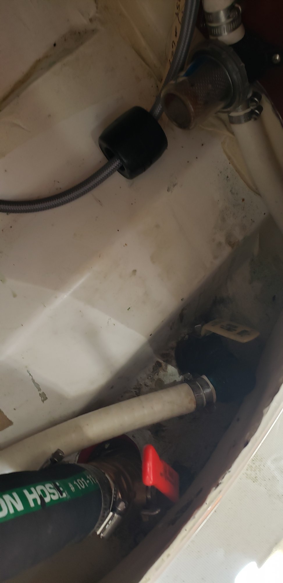

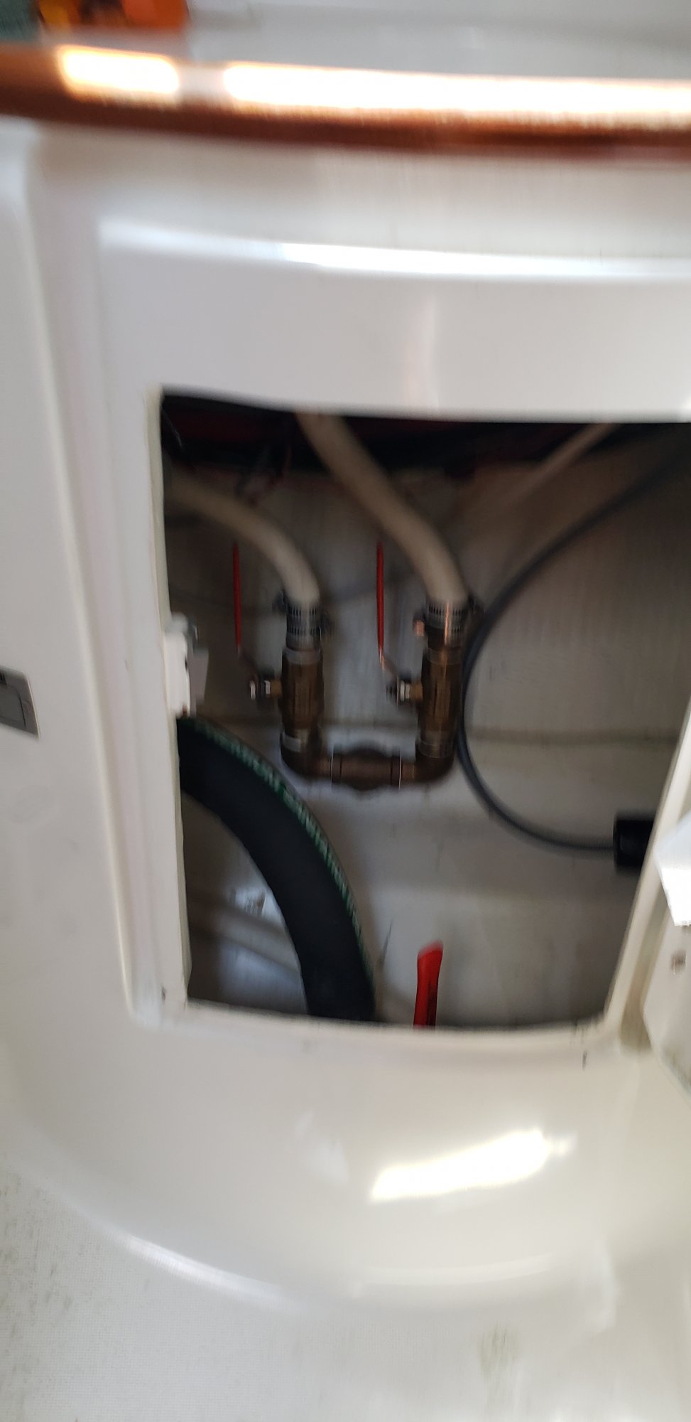

Thanks for the response. I took the floor panels off and notice that the line leading from the shower leads into the bilge space in the floor. Their is a float that will pump the water from that compartment. The shower line appears to be draining into that bilge space. But the pump is inside the sink cabinet. I am thinking that my pump filter is not sealed properly and is allowing air into the line.. I will see if a new Jabsco pump gasket will solve the problem.

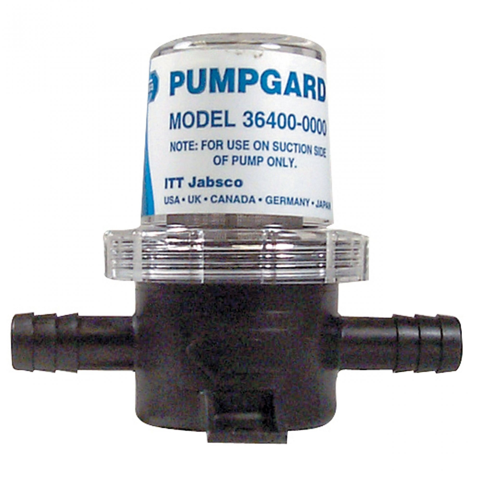

Follow the hose from under the floor to the strainer that looks like this
from there it goes to the pump then out through a through hull. Either the strainer is seriously clogged or the pump may need rebuilding ( impeller replacement) or the hoses are clogged. Good luck tracing your problem. We’ve all been there.

I believe this to be my problem. Just located the hose and filter.
