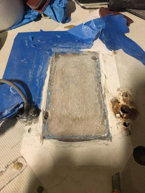

Mast support has been torn apart and reglassed. I had to do some sanding because some masking tape was embedded in in the epoxy. How even does the surface need to be before applying gelcoat? There's at least an 1/8" difference between various areas. Im assuming gelcoat is too brittle to be used in thick amounts under the mast?
23,250
Gelcoat is pretty but not able to sustain the weight of a mast. You would need a step (it would have a flat surface) and then put a bedding caulk like 4000 to further cushion the gelcoat.
Apply a thick coat of was on a hard surface, The wax is a release agent. Then slather the area of the surface with a final layer of thickened epoxy with fiberglass fibers. Press the waxed hard surface on to the final layer of epoxy. Gently level the surface against your hard waxed board. The board serves too give you a level surface. Some epoxy will squirt out from under the board, but you should get a level surface. You might even put a small level on the hard board to assure near level. If you have applied wax, when the epoxy hardens you should be able to remove the leveling board. Let the epoxy cure hard a couple of days. When cured, sand any over shoot. You may put gel coat on top after cleaning the wax off. If you are putting a mast on ttop of gel coat it is possible that it will break. Since the epoxy is not exposed to UV light You can leave it alone.
At least that is what I would consider.
So far, looking good. You're correct a thick layer of gelcoat will likely crack. Not a big structural issue, however you just put all this work in to it and you would like it to look decent. Fair the surface with an epoxy based fairing compound, like TotalBoat TotalFair or Interlux Watertite, or your own fairing compound with West System. Slather it on like you are doing drywall and sand it smooth. Then apply the gelcoat. You'll want the gelcoat to be a little proud of the surrounding area because it will need to be sanded smooth and polished.

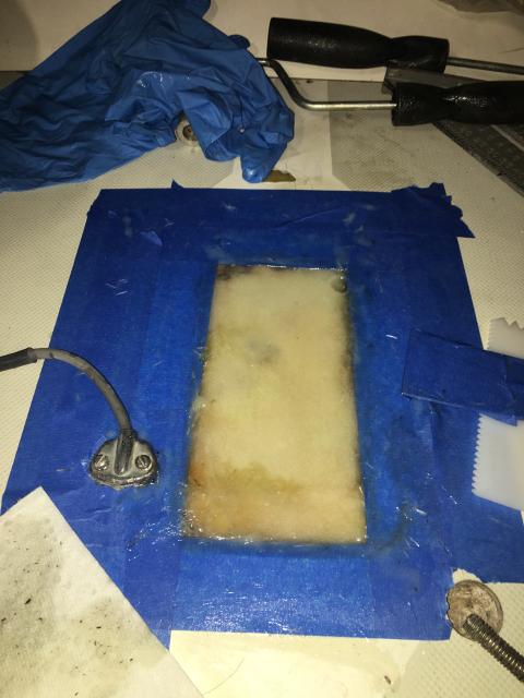

On a side note, I bought some E-Bond epoxy since the name brands are close to $200/gallon. This is the first project I used it on. I found a LOT of amine blush (visible in first pic) on the uncovered repair after curing. It felt like rubber but of course disappeared within a minute of sanding. Other than that, I'm pretty happy with it's performance. Blush aside, West and TotalBoat only performed a hair better. Estimated temp during the day was about 50F. I can feel the temp drop lower in the building when the sun goes down. Not sure if temp has anything to do with amine blush.
Amine blush is water soluble, no need to sand it off. Clean it with warm water and a scotch brite pad. Sanding will grind the amine blush into the surface.

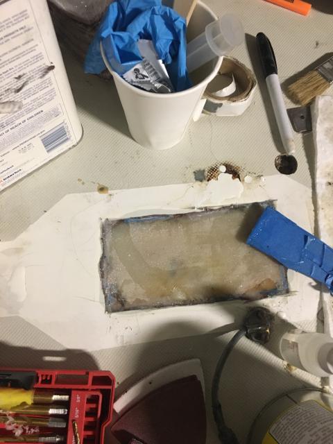

The gelcoat I applied yesterday never cured. I'm guessing ambient temp was around 55F. The can was warmed up with a heating pad and we also tried a space heater on the the repair for a couple of hours. I added roughly 1.75% MEK to it. Can stated around 1.5%. I suspect they forgot to add the wax to this batch. If I cover it up today, will it work or does MEK evaporate?
Get some spray auto wax something that has real wax not a lot of other stuff. Spray the gel coat with the wax. The gel coat will set up in minutes.

I applied some liquid wax to a piece of sheet metal and placed it over the gelcoat (too thick to spray it) and it hardened most of the way! I'm definitely picking up some spray wax. Thanks Dave!
13,005
Gelcoat won't fully cure if it is exposed to air, that's why some gelcoat has added wax. The wax floats to the surface and seals the gelcoat from air. The spray wax simply seals the surface from air and the wax hardens. Of course there is a "proper" way to do this with PolyVinylAlcohol (PVA) which is water soluble, so it is easier to clean off, but it is also about $30 a quart. It makes sense if you do a lot of gelcoat work, but for an odd job or two in a small area, go for the TurtleWax.
