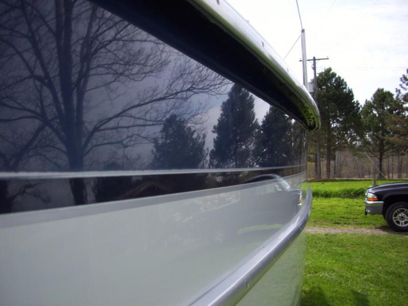

Quick and easy remedy? Use wet sand paper. Rubbing compound is nothing but a liquid version of sand paper. Use 800 or 1000 grit with a hand block get it wet and use a circular motion. This will take away surface stains and remove the chalky oxidation. It will actually leave the gel coat shinny and ready to apply a coat of new wax or finisher. A small electric orbital sander will make it even easier. Don't need to use much pressure.
