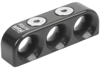

Write up implies these can replace regular organizers w/sheaves...anyone doing this?
I'm using D-Race - be about a 40 deg bend....

Lead rings are becoming quite common and this deck organizer seems to be very similar. Might even be better than an organizer with sheaves if the entry angle is not parallel to the deck. I just picked up one of these to try for my spinnaker tack line.

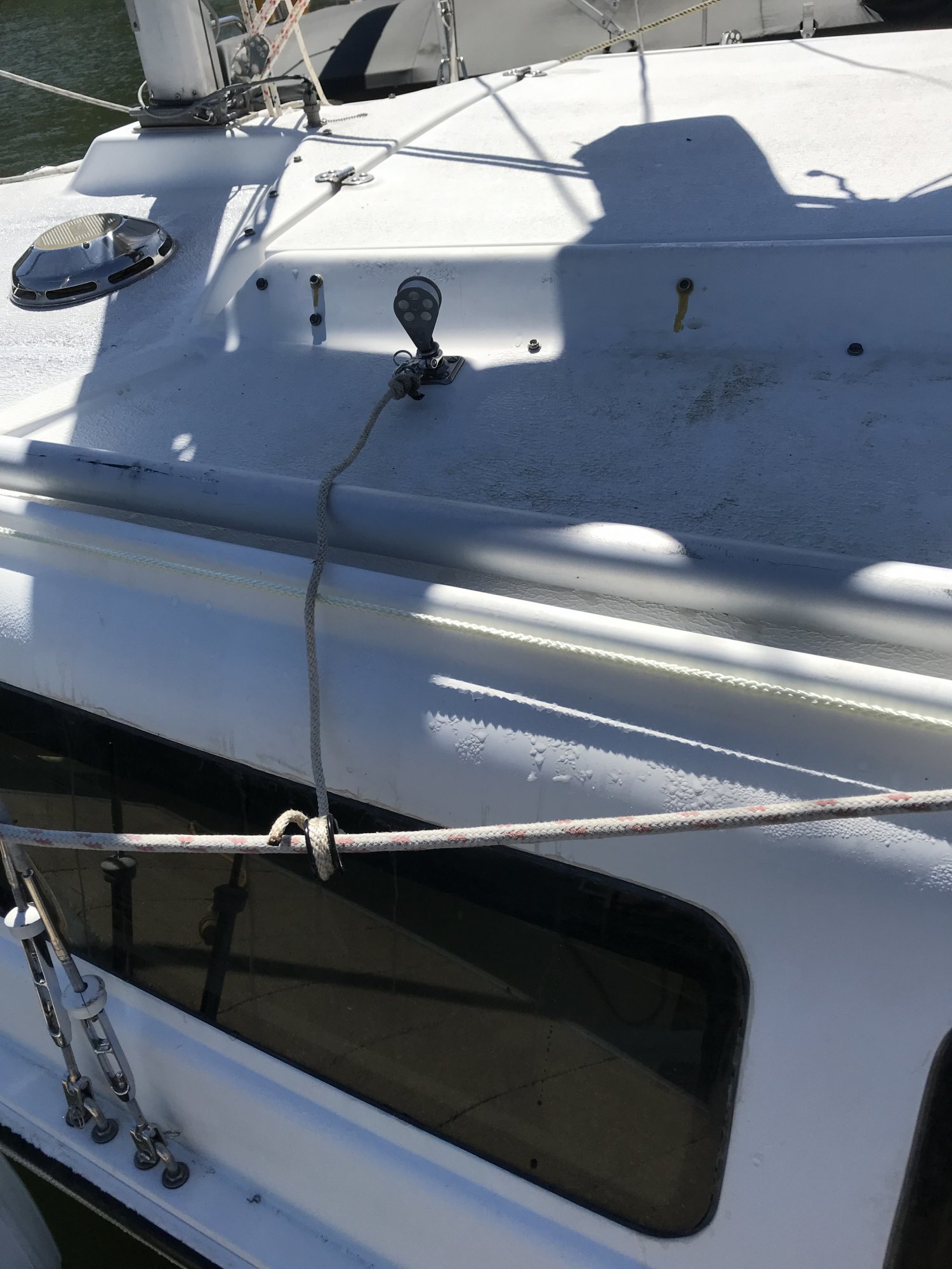

You asked about the deck organizer and all I can say is that the ring seems to work well as far as friction goes. This is not a great pic. I took this as I was testing out an idea but I don't have a pic of the final setup. I ran this ring on a line through my deck block and I run my jib sheet through the ring. One of the things I didn't like about the H26 set up is the lack of jib cars. My jib block is set rather inboard which is great when working to windward but on all other points of sail, the jib pinches the slot. When the wind is beam-to or abaft, I use the line that runs through the block to let out the ring... this lets me ease out the clew and open the slot. I call it a reverse Barber Hauler but I'm not sure if that is a good name or not. My reverse barber hauler sort of works but it adds a lot of clutter to the cockpit (two extra lines). When working to windward, I pull it all the way in and my sheet is nearly in the same place as it was in the original block.
You can just call it a Barber Hauler..... it doesn't make any difference which way it pulls. In-haul or out-haul. On my Nacra, (beach cat) the barber hauler is rigged to move the lead position outboard. On my Catalina 27, I use the genoa track.... and rig a barber hauler to move the lead position inboard. Same purpose, different direction.
