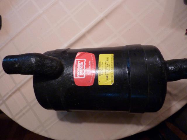

New Muffler
I need to replace the muffler on my 1990 H30. There are lots of posts regarding older H30s, but can't find any on the 88-94 model. There is not much clearance under the aft bunk. The exhaust hose goes straight to the hull exhaust portal through an in-line muffler. Seems like it should rise above the water line first before exiting, but the aft cabin prevents this.
Anybody dealt with this?
I have a replacement muffler for a Hunter 30 if you are interested. It is an inline muffler made of fiberglass so it cant rust away. Let me know if you are interested.
