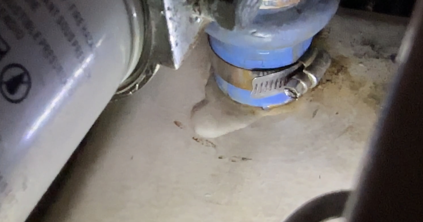

Muffler leak at top flange. Any tricks?
Jun 2, 2014
606
Catalina 30 mkII - 1987 Alamitos Bay Marina, LB, CA

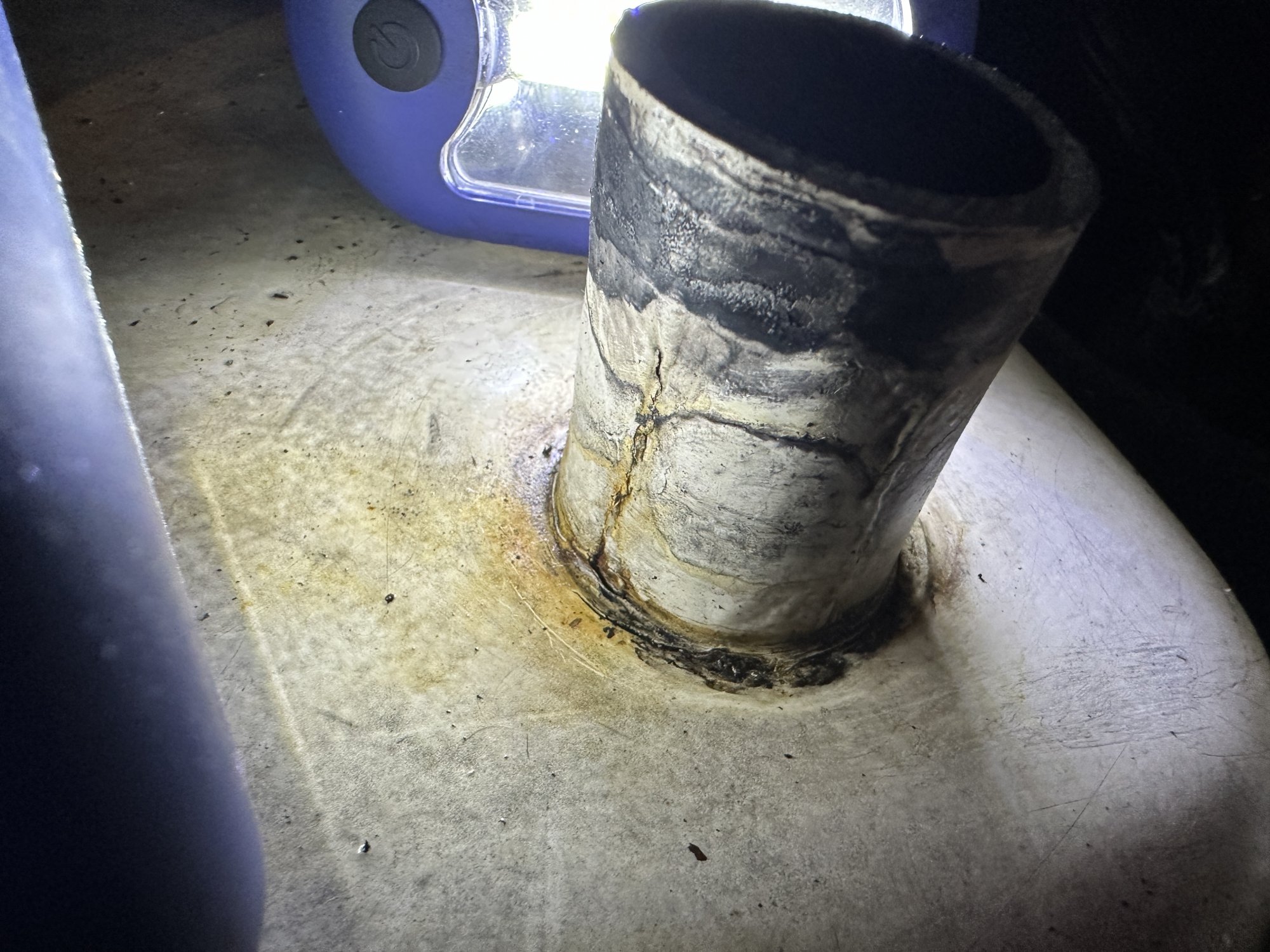

Just saw this. Any tricks on dealing with this aside from pulling out the whole cabinet and messing with the whole exhaust?
Apr 5, 2009
3,305
The muffler is fiberglass so you can repair the hub by sanding off the gelcoat and rebuilding with cloth and resin.

Yep. I think I might be able to get some photos of one that was much worse than that which was repaired with some cloth and resin.

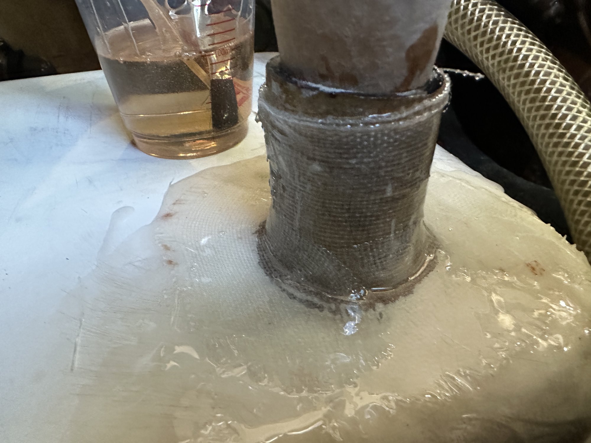

i ground down the tube and about a quarter inch around the base and did a couple layers of glass around and the base. I let it harden, smooth sanded and reinstalled. I added a little bit of sealant and two clamps. No leaks.

No problems getting the hump hose back on, it's silicone and fairly flexible, not like regular hose, thank goodness.
@Hayden Watson - You would think it's much cheaper to fix yourself, but if you don't have a garage with many of the supplies, I spent close to $200 just to buy what I needed, between sanding supplies, West System stuff, etc...
I suppose if I had a lot of the items already, it could have been closer to $100. But I have a general rule that if the repair costs more than half to replace it, then replace it. In this case though, I was anxious to go sailing this weekend.

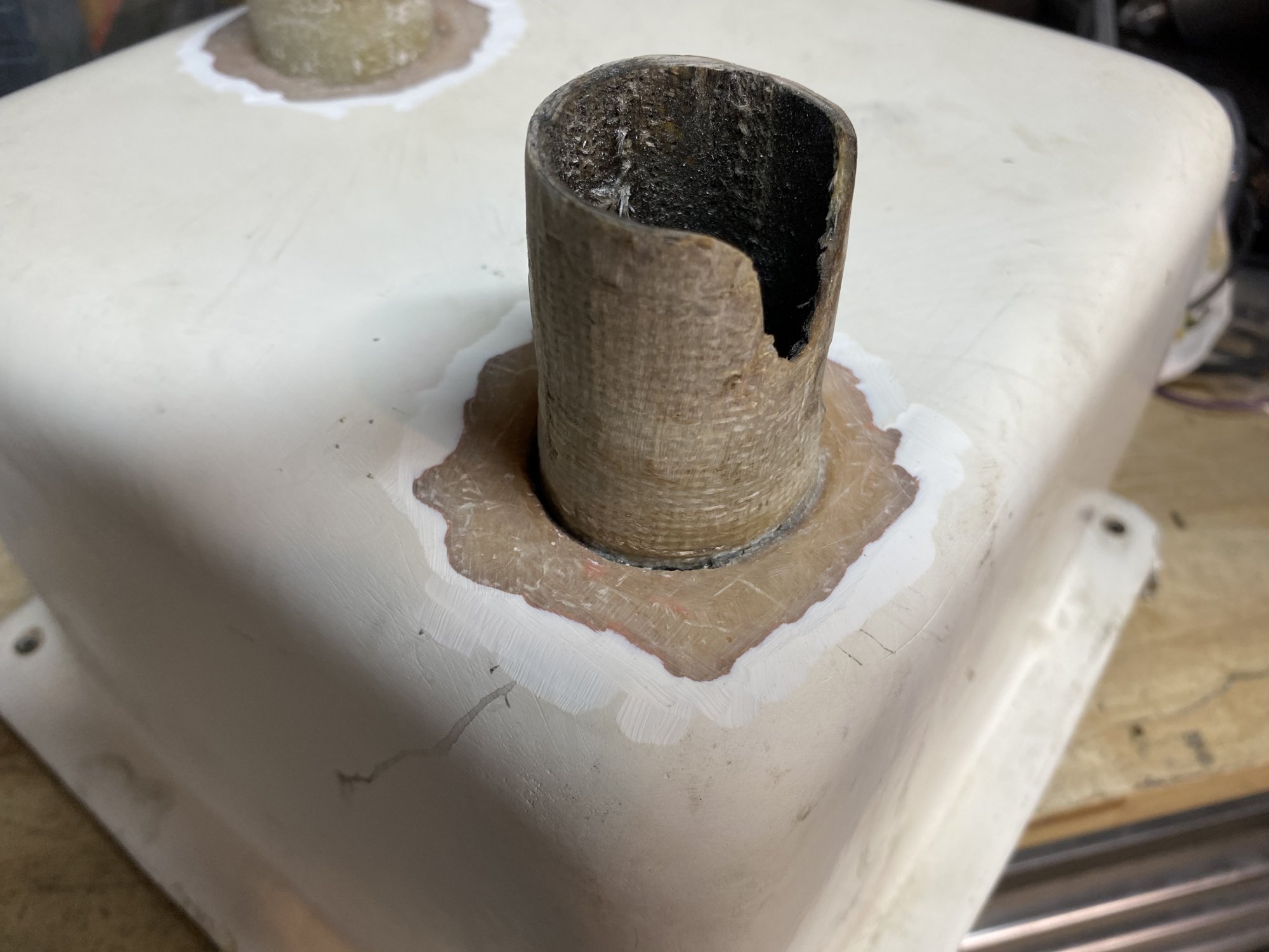

Mine was broken slightly different than yours was, but it leaked the same. I had a chunk broken from someone using a screwdriver to pry the hose off and I didn’t have enough clamping area. I also had cracks in the epoxy or resin that held the pipe to the box so I dug all the existing “glue” out and replaced it with Marine JB Weld.
The Beginning, after cutting out the bad glass.
here is the finished product.
Glad to see your fix… fixed it.
