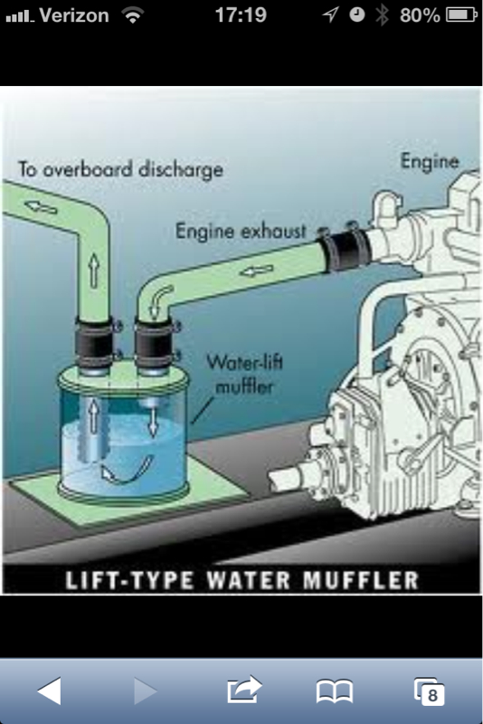

PERK... Can you explain this a little more. I'm confused, although it doesn't take that much to confuse me!! Here is a general pic of a waterlift muffler. The one on the C30 may be rectangular though, not cylindrical as shown here.
