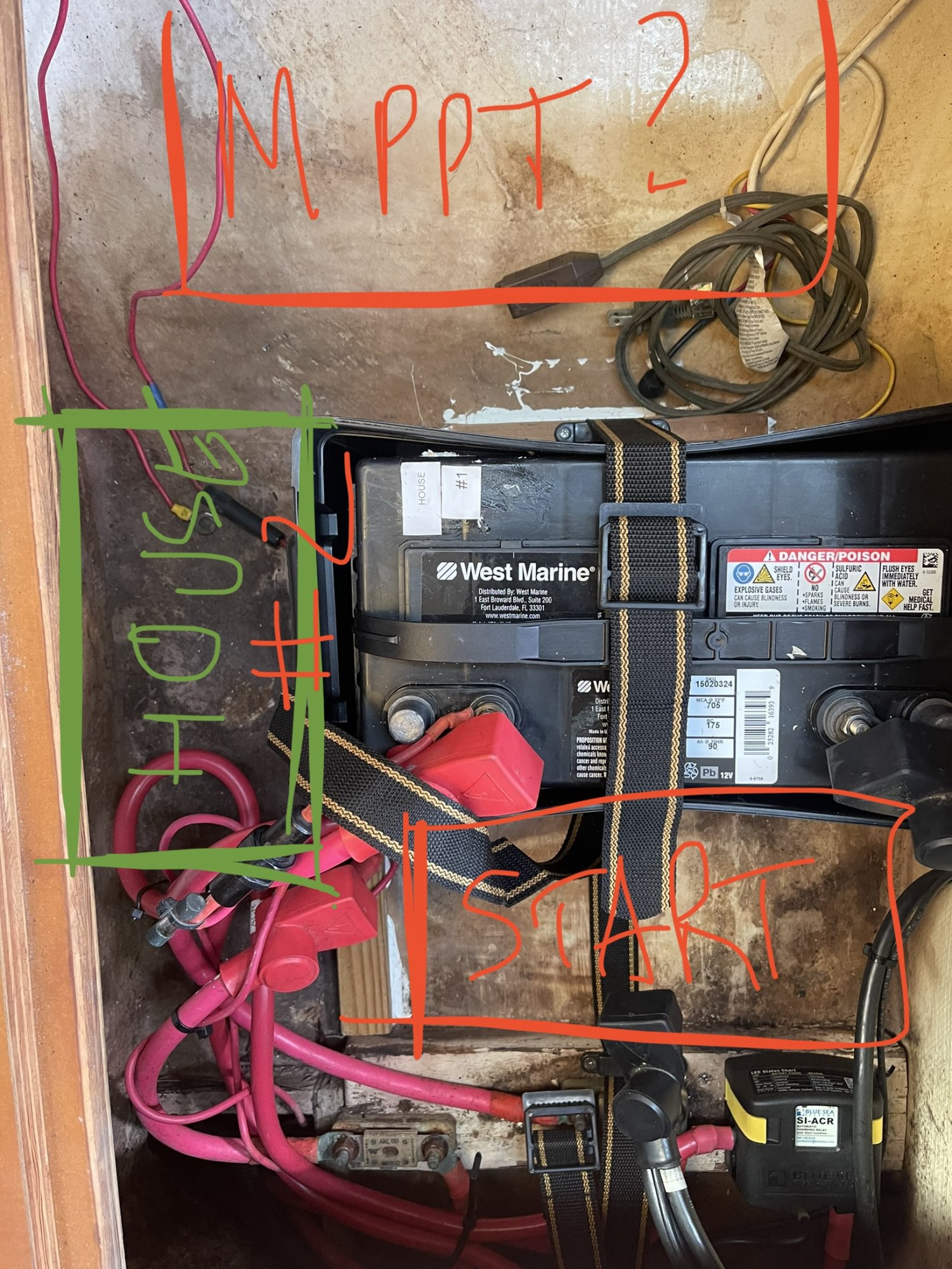

did you mount it on the sloped side. I plan on adding a 3rd battery For reference I’ve attached a picture?

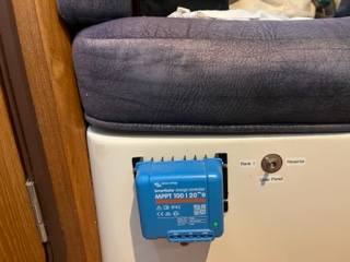

last year I installed a 200 watt panel above the Bimini and a victron controller 100/20 see picture attached it is on the port side just below the settee, why do you need 2 controllers?

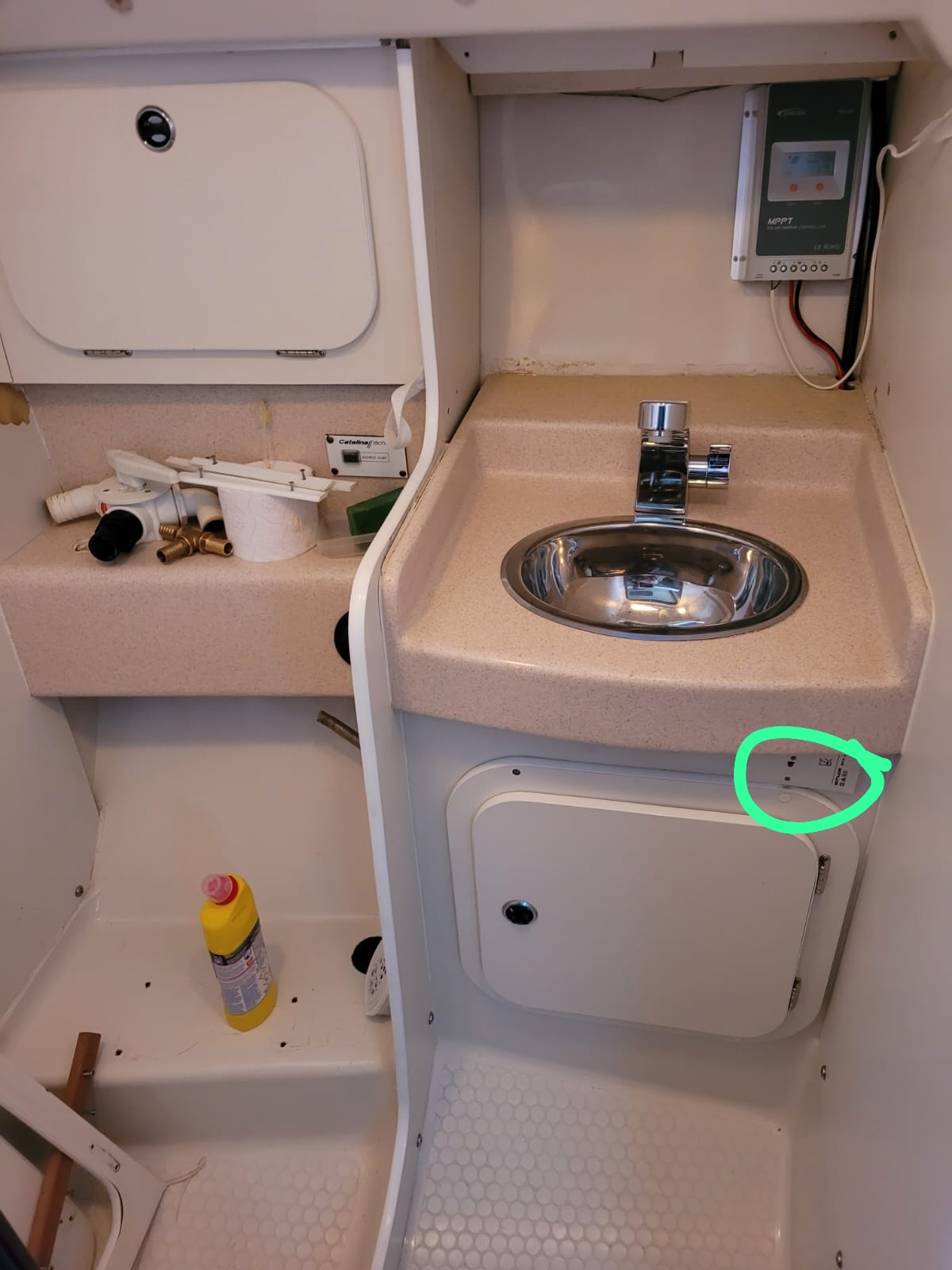

My MPPT controller had a screen to show power data, so I mounted it on the bulkhead above the battery compartment, above head level where someone would sit. I had mounted two 160 watt panels on the davits and I ran the wires down the davit supports and into the transom, similar to what you described. I used black zip ties with electrical tape around them to secure the wires. I wasn't concerned with the look of the wiring so long as it was neat and secure.

I've placed my controllers by the macerator pump and wired the output to the battery charger lines. In doing this shorter lines from the solar panels and bigger lines to the batteries. Reason battery charger not on at anchor or under way also the line size is greater than required also less connection at the batteries with same results.

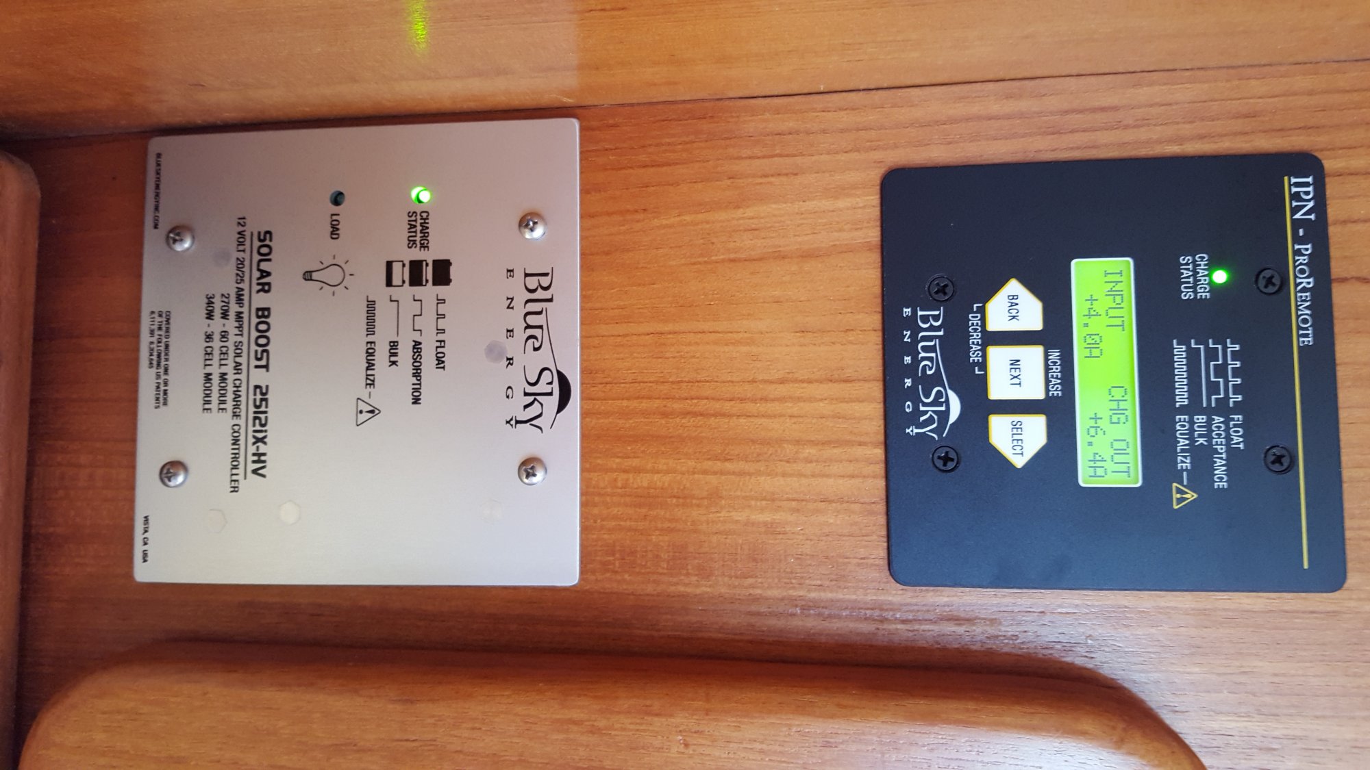

On my 310 the solar MPPT controller and battery monitor are mounted on the port side in the compartment where the stereo is located. Actually just next to the compartment as shown in the attached picture but they are accessed if necessary by opening the door to the stereo cabinet. They are mounted outside the cabinet so are easy to view any time. My battery box is under the port settee and I have 2 x 4D AGM batteries plus a small AGM starter battery that is located in the aft cabin also on the port side. As an aside, I have a single 175 watt panel pole mounted on the stern which allows me to rotate and tilt to point at the sun. This greatly increases output.20160213_085539.jpg
