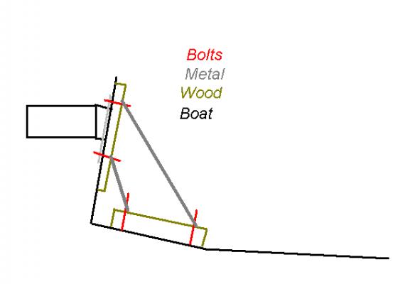

Sorry I don't have a picture, but on my Hunter 23, the motor mount has been beefed up in a pretty simple, yet strong mathod.
1: big sheet of 3/4 marine ply through bolted on with the motor bracket
2: 2 foot long piece of 2x4 expoxied to the bilge floor. There are two carriage bolts going through this piece of wood (one near the transom, one at the other end), with threads sticking up.
3: Two angle aluminum braces, going to the lower and upper mounting bolts for the motor mount.
This thing's never moving.
