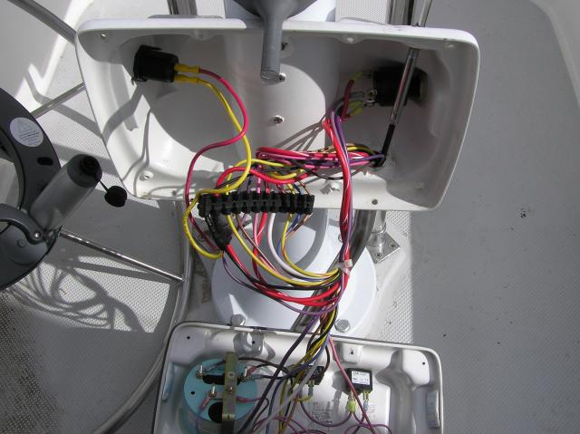

Ever done it? I want to add one and the engine console seems like the logical place, but space is a bit tight in there. Looking for other ideas.
Mar 6, 2008
332
Catalina 310 Scott Creek, VA
My boat (06) has one on the port side in the lower pod that has the gauges (athwartship near the hour meter). It was either OEM, or installed right such that it looks original..I can get a pic if you want
Sep 29, 2008
1,981
Catalina 310 #185 Quantico
A Picture would help
My tachometer is on the port side. Is yours as well? For that reason I did not look that hard over there. I did pick up a West Marine brand weatherproof outlet that is maximum 2" deep, and the engine gauge enclosure is a bit packed.

Thanks for Pictures
Now that I see it, I will have to re-look at mine. It did not seem that spacious, but it looks like it is.
