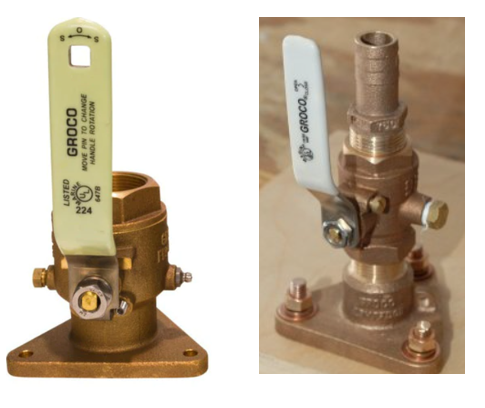

A motorized stainless steel seacock is an interesting idea. I prefer bronze seacocks of the configurations below. As a former oil refiner engineer I like manual valves for process line-ups and in this application no control valves that would introduce pressure drop and restrict flow and risk failure, and most importantly not in the closed position. I also like to put my hands on the seacock lever to verify valve position. I would also specify bronze vs stainless steel in marine application to mitigate the risk of crevice corrosion, which occurs when there is a localized breakdown of the protective passive layer on an exposed surface corrosion. If I did not install a motorized valve in marine plumbing I would also install manual isolation valves for maintainability.
However, I plan to install a potable water electric ball valve with isolation and bypass valves for maintainability to segregate a diesel water heater from an electric water heater when the diesel heater is off.
You might these articles helpful: Know how: Thru-hulls and Seacocks - Sail Magazine & Seacock & Thru-Hull Primer - Marine How To
