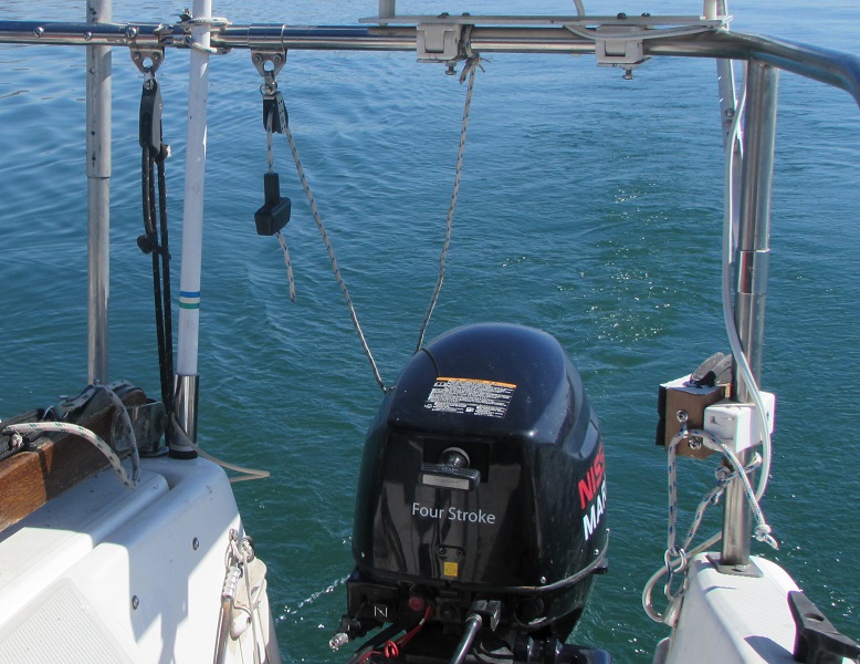

I never sail with the outboard in the water.. its one of the advantages to having an outboard on a sailboat.. no prop or anything else that causes drag. If you have a stern rail, its fairly easy to add some sort of lifting mechanism that makes both raising and lowering way easier.
edit.. found a picture of what I did with 2:1 leverage - copied the idea here from Sumner or someone else.. cant remember. There is another pulley hidden by the outboard that is attached to a metal tab back there.. had to drill a hole in the outboard for this but its been trouble free for years. There is also a line to the reverse lockout release also with a T handle so I dont have to reach way down there to release the outboard for dropping it back down.

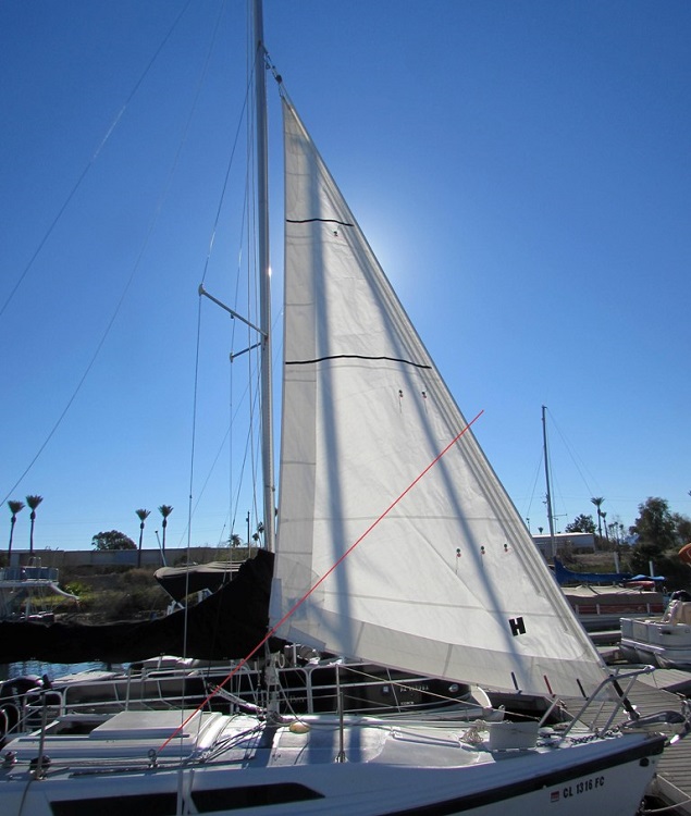

A lot of boats have a jib that almost contacts the deck. This prevents air moving between the pressures that create lift at the bottom of the sail. Called a "deck sweeper" or "closing the gap", it does make a difference. But it also completely blocks your view.. I just dont like sailing not being able to see where Im going so I bought a sail cut so I could see under it. Doing this doesnt seem to have hurt anything in heavier air but I possibly give up some speed in light winds. Point being.. raising your jib may not have been the best thing for performance but on the other hand, seeing where you are going might be more important to you.

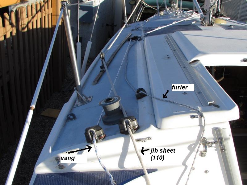

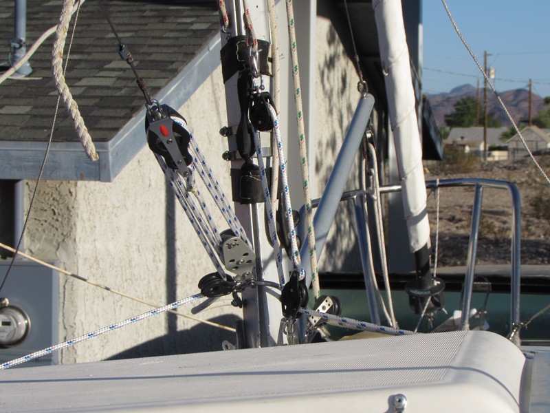

Curious if you have a vang and are using it? For a long time I thought a traveler got rid of most of the benefits of the vang but Ive been been playing with the vang in the last while.. What you saw.. hopefully someone else has an idea but it sort of sounded like what might happen when you adjust the vang???
The two pictures below show a change I made about a year ago (from seeing a picture Jackdaw posted.. ). Nice being able to adjust the vang from the cockpit but I can only adjust it from one side.
FYI, I have switched the location of the jib and vang controls from what is in the picture (lines no longer cross) since I never need winch with the 110.

One other thing about raising or lowering the jib. If you draw a line through the jib sheet, a starting point is that it should about dissect the sail luft in half. So the location of where the jib pulls from has to move if the sail moves up or down. Since its about a 45 degree angle, its about a 1 to 1 relation. Move the sail up 1 foot, move the jib "pull point" back one foot. Since you just moved the jib, maybe some chance it improved things?

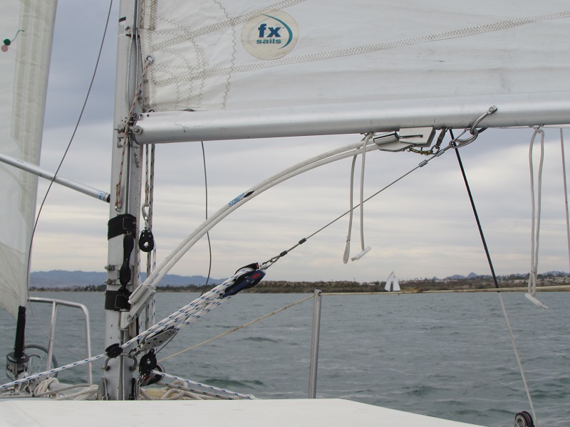

One more thing about your topping lift experience. This is something more for very light wind but a boom kicker along with a vang allows the vang control to duplicate what you had with your topping lift being too tight while sailing. Loosen the vang and the boom kicker pushes the boom up. Tighten the vang and and it pulls the boom back down.
FYI, my vang has a high load quick connect on it (on the end that attaches to the boom bail) so that its easy to raise the pop top.. I have been leaving the boom kicker off.. just because of the hassle of taking it on and off to raise the pop top. Im also just not a fan of sailing in very light wind unless Im by myself and its completely relaxed (not racing). And for that completely relaxed sailing.. I just dont care about the incremental improvement the boom kicker gives. If Im racing in light wind (my very least favorite thing about sailing), I would have the boom kicker on.

One more thing that might be helpful.. An exercise I did several years ago that I thought was useful was to take pictures of the jib sail while the boat was in the slip. I moved the jib car back and forth and took a picture at each spot. I then looked at the pictures to find out what jib car placement gave me the 50% luff bisect. This is just a starting point for adjusting the jib car placement but by doing this, I found that I had been using a setup for several years that was WAY OFF of what it should have been.
