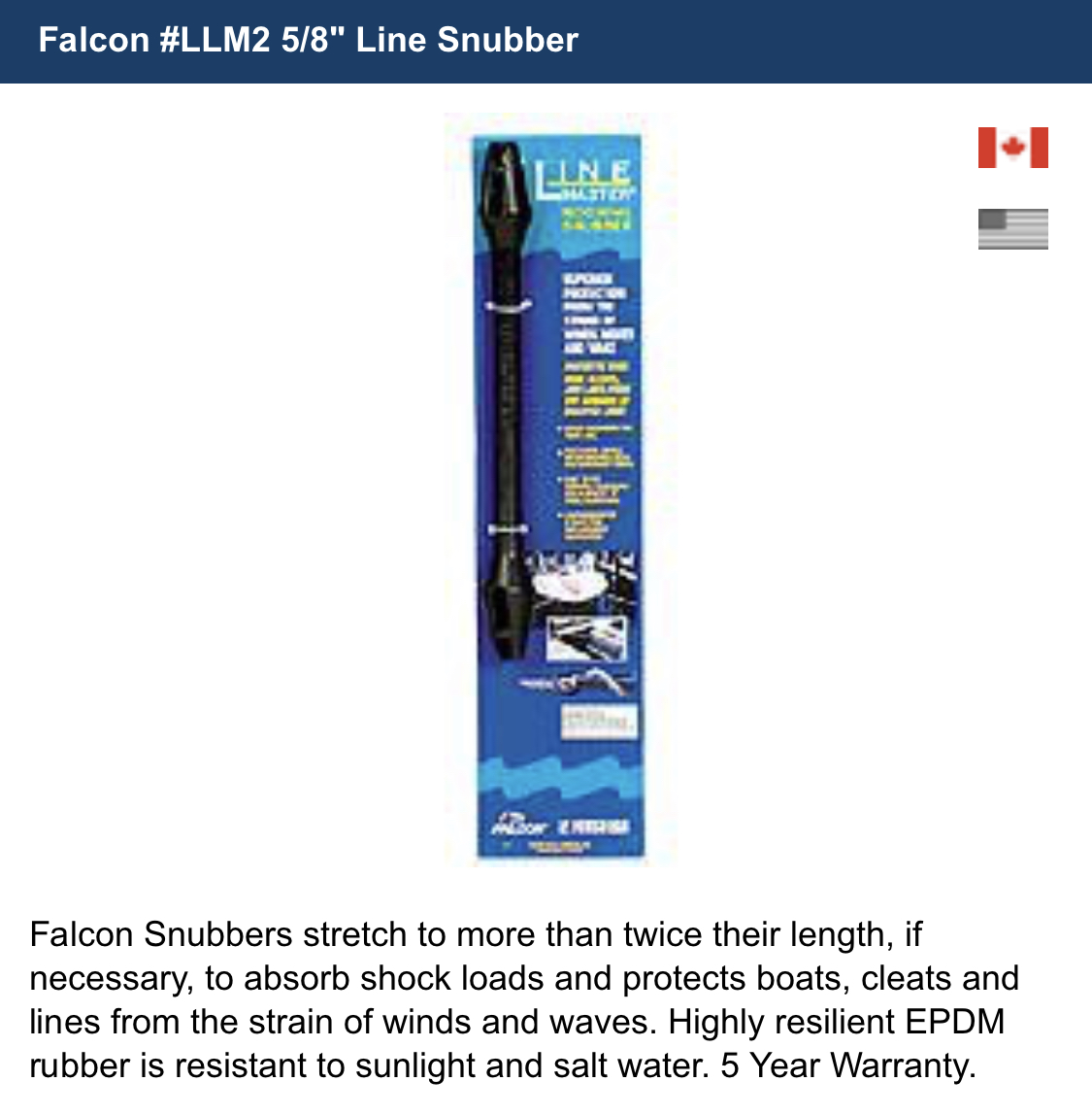

I’ve moored on a relatively exposed mooring for years although your boat is bigger than any I’ve had the principle is the same. My philosophy has been to oversize and add as much protection as possible. Helps you sleep at night!
I have two pennants hooked up like you but one is slightly shorter. If the primary fails the other one takes over. I always used a snubber as if/when things get wild it adds to the shock load protection of the nylon line.

You might want to rig one of these as you can take it with you for when you drop anchor. I have a permanent one in place on my mooring chain.
