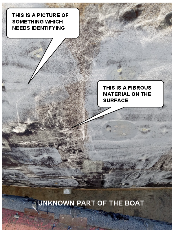

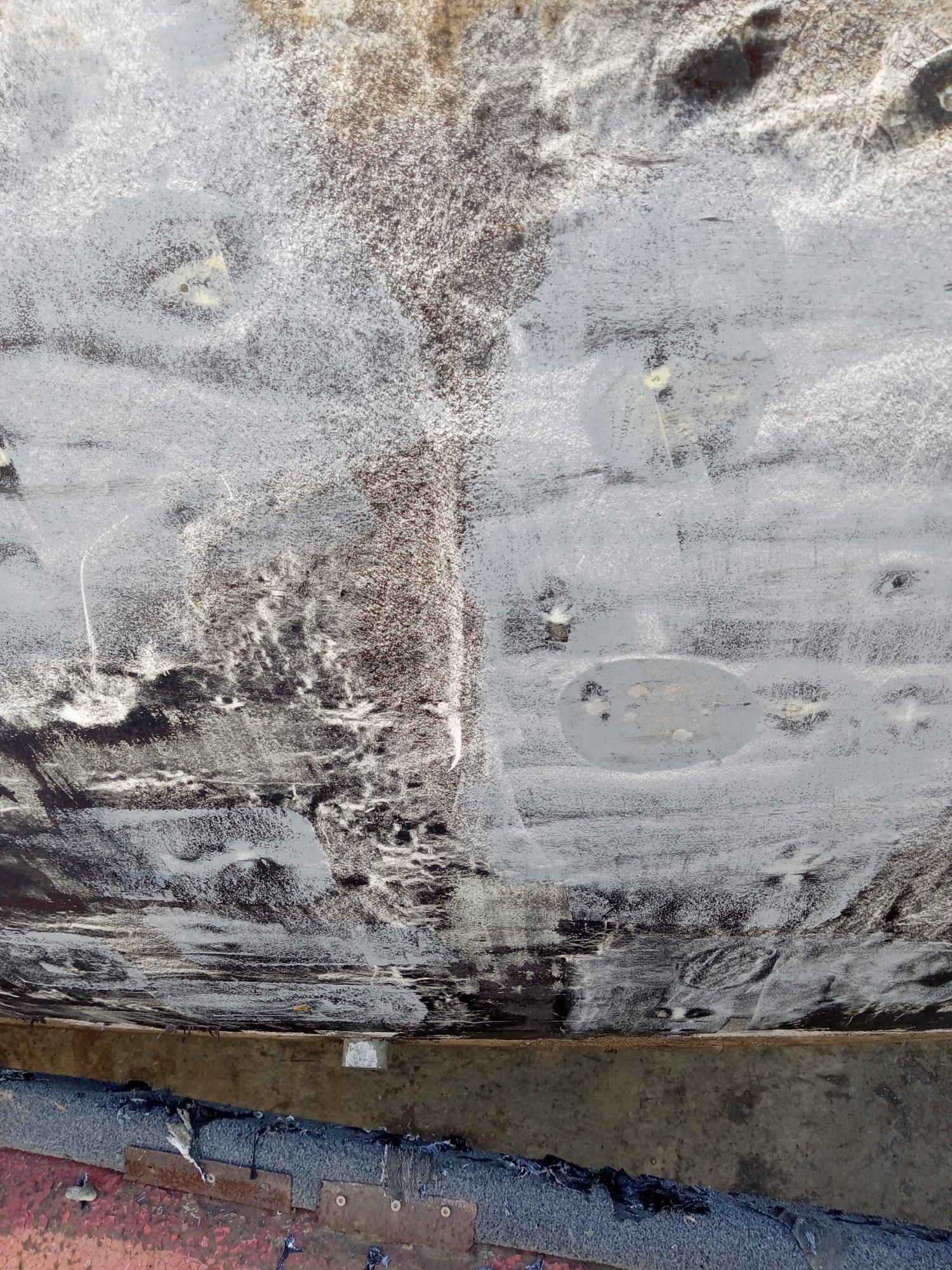

OK! When you start seeing other people's repairs on the hull, we're getting close. More sanding and stripping.

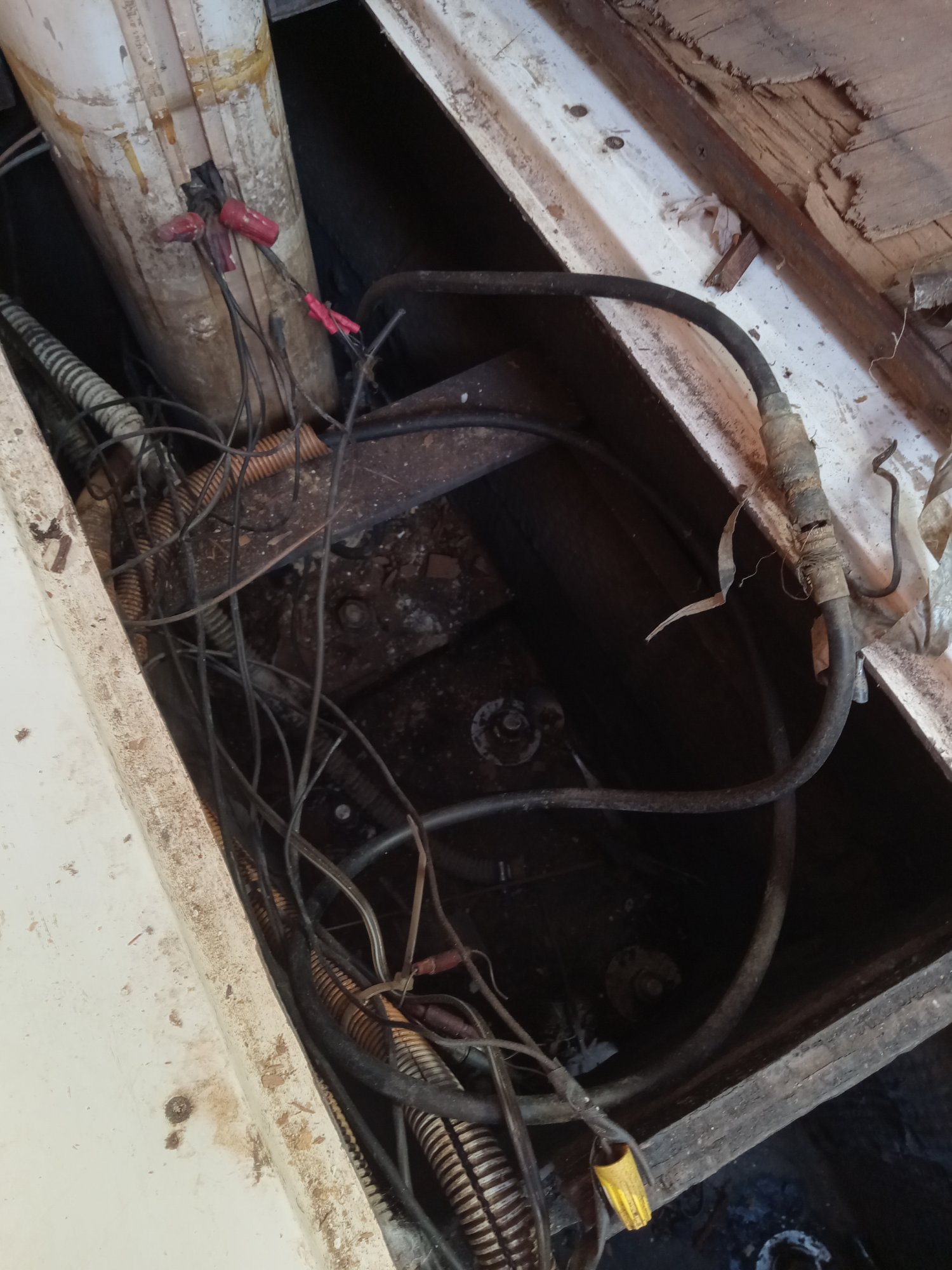

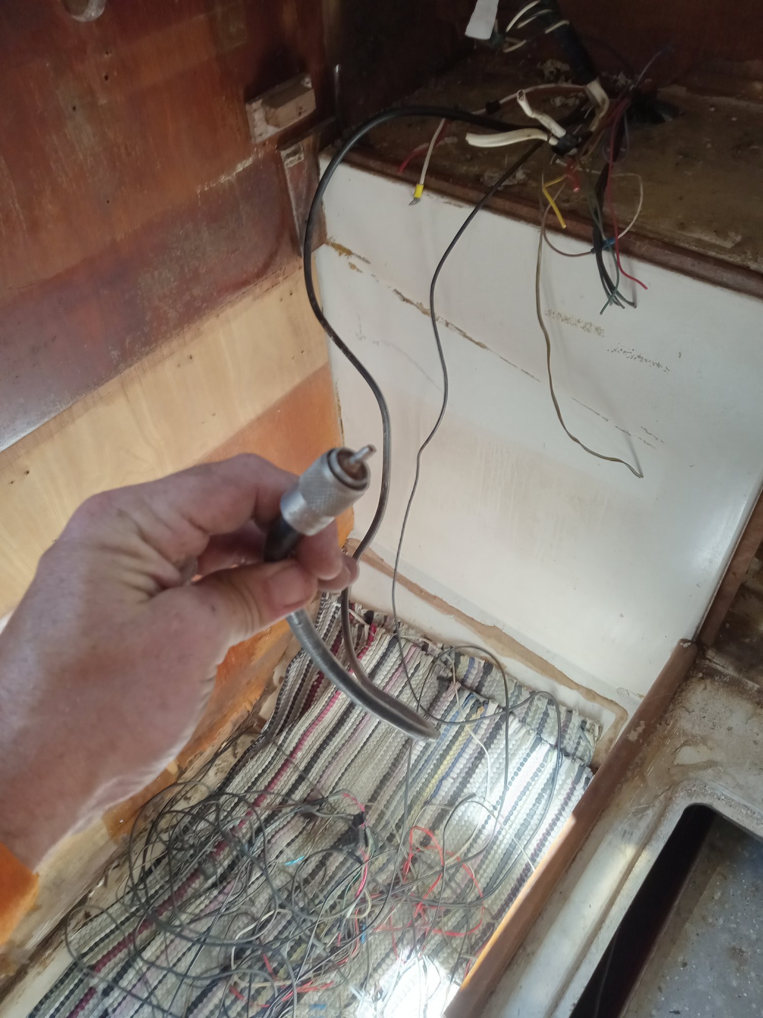

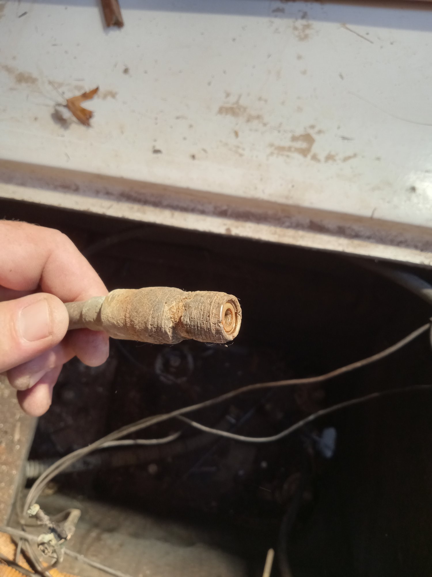

Now the nonsense of wiring in the bilge and to the mast. This coaxial (to masthead antenna for vhf radio) was ducttaped with a mystery wire bridging the connection. See stuff with wire nuts and general mess. Any way to fix this without going up the mast and pulling new wiring up through? I guess I'm going to have to get up there either way to replace the anchor light. Might replace with 3color masthead light?

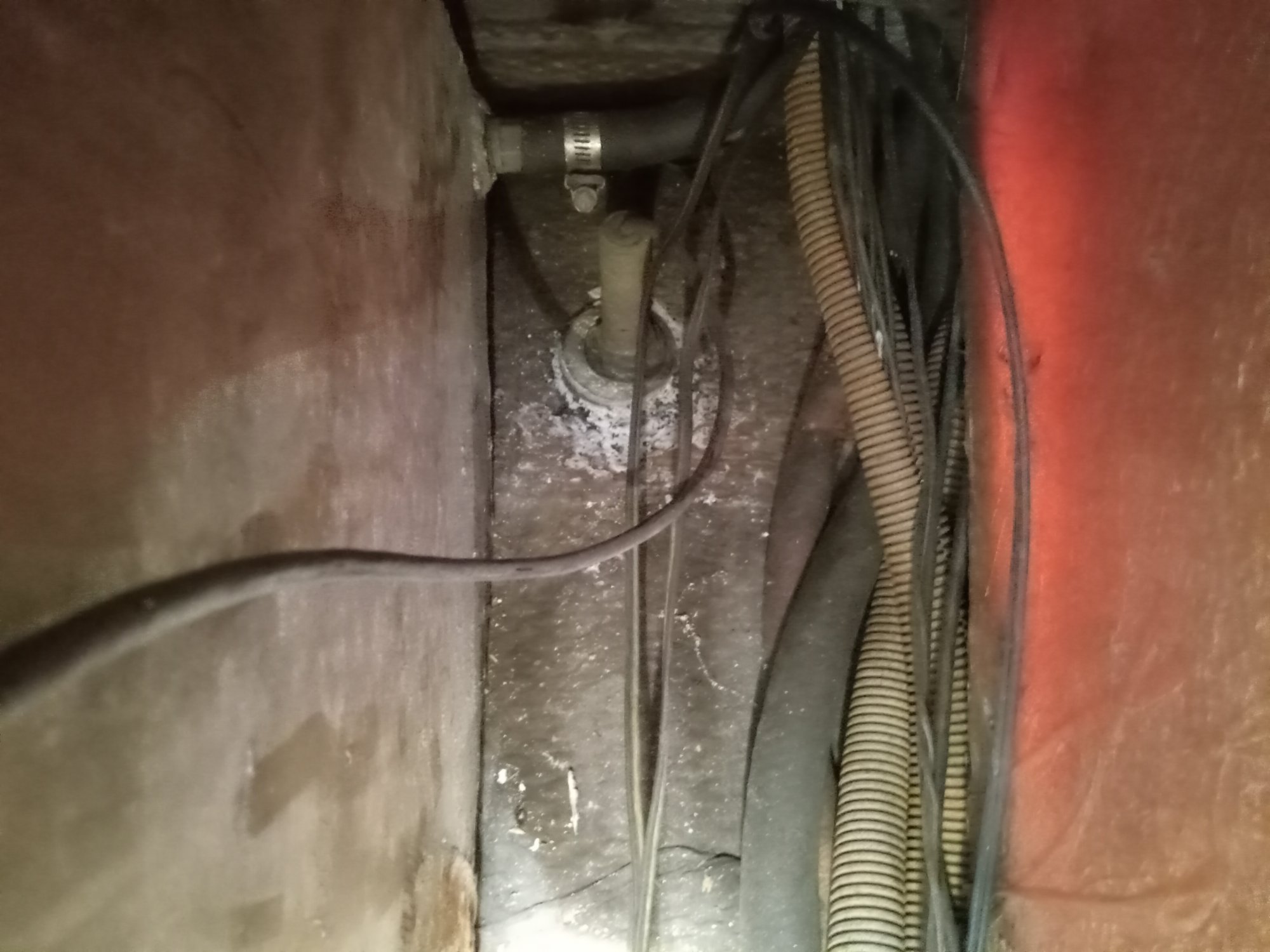

Last picture is old transducer/depth finder. Should I replace with new similar style through-hull or remove and fiberglass the hole? And put a new depth sounder somewhere else?

All the wiring on the boat needs replacing, especially the coax. There are several good sources for information on wiring, here on SBO at the Musings With MaineSail forum, at MarineHowTo.com and BoatHowTo.com. The Pacific Yacht Systems YouTube channel has a lot of good videos. There is a Boat Electrical group on Facebook on which there are a number of professionals. And of course here, on the SBO forums.

Do you plan to remove all of the wire from the bilge ? It looks as if most of it has spent its life underwater which has resulted in the brown coating on the coax connector.

Yes, the wiring is all bad and is being removed, asked for suggestions if there was alternative to wiring a vhf antenna to the mast, perhaps some better tech exists that would eliminate the need for wire.
The simple answer is no, VHF antennas are not wireless. There are however better and worse ways to wire a VHF antenna. Here's a link to the best description I know.

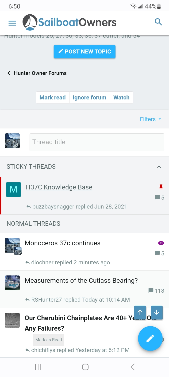

Also, in the reference section of this site either the modifications page (which does not have comments) or the reference page which includes a whole list of expired links.
To which section are you referring? Can you provide the broken link? I'm sure the powers-to-be would like to know.

1000001393.jpgthanks dlockner. The "knowledge base" sticky post has all dead links.

Once again, looking at the top image I see what looks like you've exposed previous repairs which didn't work out too well. The only answer is to dig it out and repair with epoxy and light weight cloth. Epoxy sticks like :poop: to any and everything and is far stronger that any putty you can apply. Finish off with waxed gel coat.

Didn't see one key wiring thought above. The 37C wiring was not tinned on my boat. Any moisture crawled up the wire under the insulation ruining it. I ended up replacing all of the wiring to current standards. This is not that big of a job. I saw a similar rewire job done at a yard for under $3,000. I did the rewire by area of the boat.
I also cut into the area under the breaker panel and mounted wiring blocks, running all of the breakers down to the blocks. It is way easier and neater to deal with wiring under the chart table instead of working behind the breaker panel. This is especially true for multi connection breakers like "Cabin Lights" and "Running Lights".
