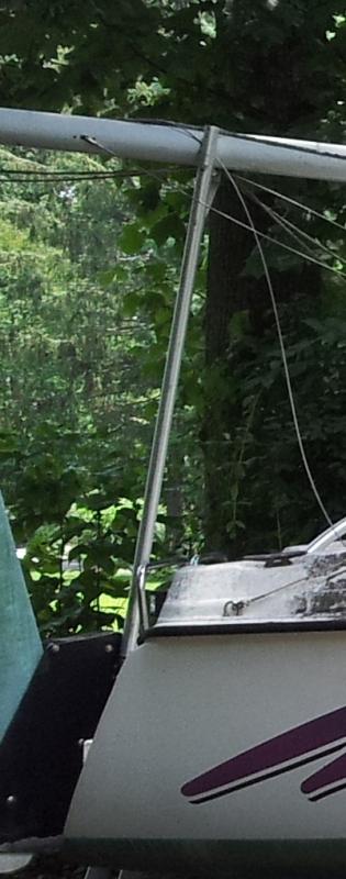

mmsailor, that sounds like the factory trailering mast support that I have, does it look like this pic? (sorry best pic I had handy) It's just a piece of pipe with a bracket bolted on one side to make a "Y" and a chunk of pvc pipe covering the bolt to act as a roller.
The 23.5 came with an integral mast raising system that can be done single-handed. Did your previously loved boat not come with those parts?
My 23.5 did come with the factory mast raising system , Very nice system . Something happened to the original mast crutch and some one made a replacement out of galvanized pipe . They did not use a y everything is right angles but it works . It was covered in rust . I sanded it , primed it and getting ready to give it a coat of white paint . The price of a new one is right up there so I can live with this until I hit the lottery . I never buy tickets so the chances of that are not great .
