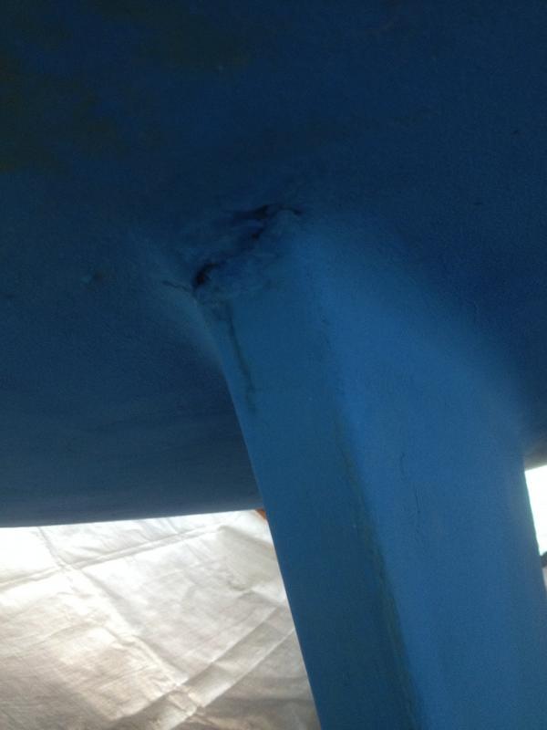

Hi. Now that the NE Winter is winding down, I want to start thinking about addressing a problem with my O'Day 22. I'm a new owner of the 1978 boat, and spent much of last sailing season fixing things up. I rebedded many things, and fixed rubrail and hull to deck joint. So, my bilge and cabin were dry by the time I got the boat in the water in mid-August. The bilge area over the fixed shoal keel (no centerboard) took in about a teaspoon of water per day, but by the time I removed the boat in late Sept., it had increased to about 1/4 cup. It had the taste of seawater, and I believe that it was. The boat is on the hard, and I took a photo yesterday of what is probably the culprit, a gash of some sort in the top rear of the keel. I did add some thickened epoxy to a few areas before bottom painting last year, but probably not enough in the area indicated in photo.
Does anyone have experience with this, and also, what would be the best way to repair the leak. The water didn't necessarily seem to emanate from the rear, as the keel bilge (under the floor cover) has some cracks along the middle lower sides, which could also be sealed. I just don't want to seal in a problem that will reappear, or mask over structural damage. I'm guessing there might be some internal cracks along which the sea water penetrates. Thanks!
