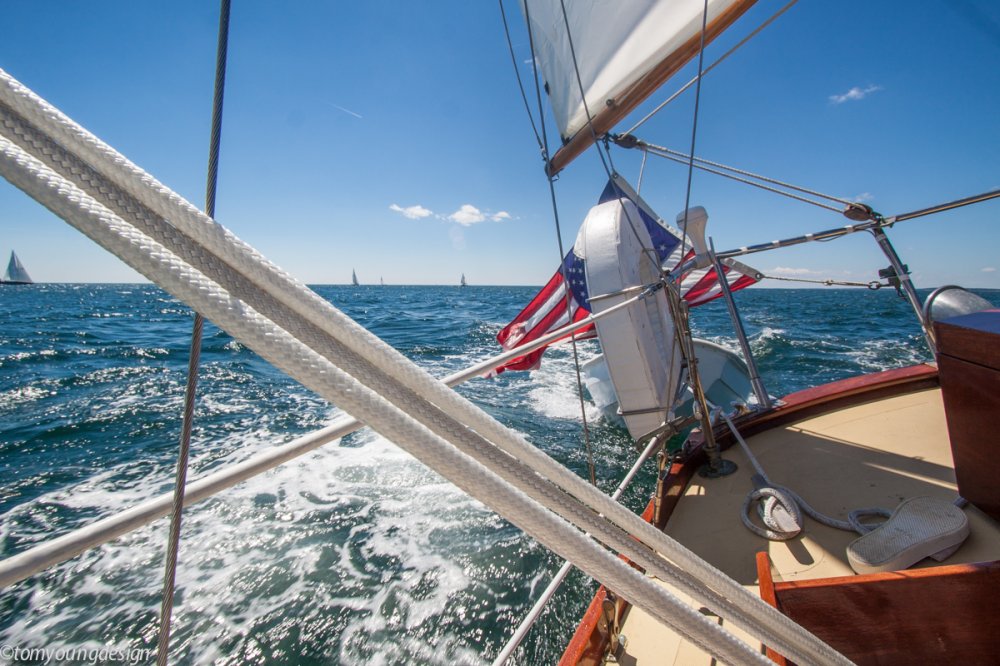

Most of my sailing miles have been with a family and these, days my wife and I alone. 99.9% of those miles, coastal, we are towing a dinghy. We long ago decided to - as well as throw life rings, throwable cushions - to immediately throw the dinghy painter off the easily accessible stern cleat.
The dinghy is easier for both the MOB and person(s) on deck to spot. Lashed inside are 2 PFD's, a set of oars and a bailer.
As well as a good float to stay with, the MOB can board it. We practice that to be sure. In fact we both boarded the dinghy this season while swimming on Cape Cod. It's quite easy without adrenalin. We ship surprisingly little water as you pull the mid rail down and grab the middle thwart. A little pulling and kicking, and you've in.
This is in a bathing suit with no adrenalin. With clothes on, it might take more effort but you could shed some holding on the side. For us in Maine, getting out of the water that could be quite cold, we like the idea as the MOB, as whoever is still on board, goes about their tasks (which might not be easy).
Like any procedure, it becomes more of a problem in heavy weather. But, we're coastal sailors: 99% of our sailing is in weather we choose, and mostly in daylight. If one of us goes OB, it will most likely be in broad daylight, in good weather.
When I sail alone, I'm more careful. The dinghy is still there but under AP, useless. So if I have something to do on deck and I'm concerned, I heave to or otherwise stop the boat.
The dinghy is our emergency ladder, and we know it works in the conditions we'll likely find ourselves OB.
I like this plan. How about a small outboard in a waterproof chest too?
For cruising, a dinghy is standard equipment and an inflatable dinghy is fairly easy to climb aboard. You could even tow a line off the dinghy that when grabbed and yanked could release it from the tow line. I'd be concerned about losing the dinghy, but something might be worked out that was safe.
Another additional thought, a pvc box with a sea anchor inside at the end of your tow line might slow the boat enough to make getting back aboard easier. I'm surprised no one has mentioned drogues yet. The towed line could also deploy a drogue.
-Will (Dragonfly)
Our safety rules and equipment are pretty spare by most standards. I give myself a break: We're coastal sailors, never more than an overnight off the coast.
That means, primarily, we can avoid the harsh weather offshore sailors should prepare for. I have to think about going overboard, from my mooring, not in the middle of the ocean during a gale. My only way back in the boat is the dinghy.
Stats show that vast majority of boats (most of us here) are coastal sailors. I would guess coastal sailors are towing a dinghy, 95% of the time and miles. Further, if we go overboard, most of us will be close to home and it will happen in mild weather. I'd also guess, 95% of the boats can't be boarded from the water unless there is someone else aboard(mine).
Yet few people consider their dinghy as a means to get back into their boat.
A long painter, if it doesn't float, acts a bit as a drogue. You could add something. Probably floats would slow it down.
To me, sailing single handed with the AP steering (or the boat steering itself), and going up on deck into a precarious spot, is analagous to walking along the edge of a 10 story building.
I wouldn't do that! I would take precautions which could include turning the AP off, and heaving to.
