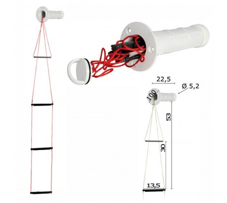

FYI, I sail solo a lot and see a lot of other solo sailors. Most of the time, I see them sailing with what appears to be an up and locked boarding ladder -- or no apparent ladder at all. I often wonder how they would get back aboard if they fell or were knocked overboard. Stuff happens.

Here you go... Just not sure where I can find a storage place on the boat.
Additionally the unit is projected to cost $3.500. That would compete with my sail budget.
