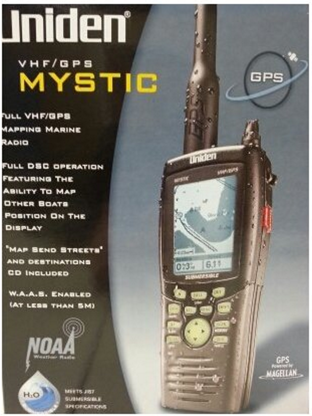

Back in 2003 the USCG created a Marine Industry working group to spec and build the Rescue 21 services, based on the existing (1999) DSC standard. Uniden and Magellan (where I running the Marine GPS technology) were both invited, and during the sessions we plotted on a super-device.
The result was the Uniden Mystic, powered by Magellan GPS and mapping technology. Released in 2004, it was a all-singing, all-dancing waterproof VHF unit with GPS, WAAS, DSC, and MAPPING. It was slightly big, slightly expensive, and glorious. Its the most feature-rich VHF handheld ever built, even to this date. I still have mine.
The point is in these meetings that the USCG TOTALLY had CH16 overloading in mind when they created their drafts for Rescue21 and how DSC should be used. While cell phones have taken some of the 'load', the individual and group calling capabilities are well designed and can (and do) relieve CH16 overloading. The team spend a lot of time making sure of that.
