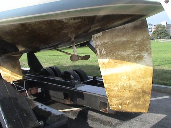

I have a 1992 H28. At the end of last season when I hauled my boat (see picture), I noticed that both the oblong zincs I had put on at the beginning of the season were completely gone (no trace other than the marks on the prop shaft). I keep my boat on a mooring on a back river in Maine (not may boats around and no marinas). Does anyone want to hazard a guess as to where they went? Could the bolts have loosened up and they simply fell off or is it more likely they corroded? Thanks.
