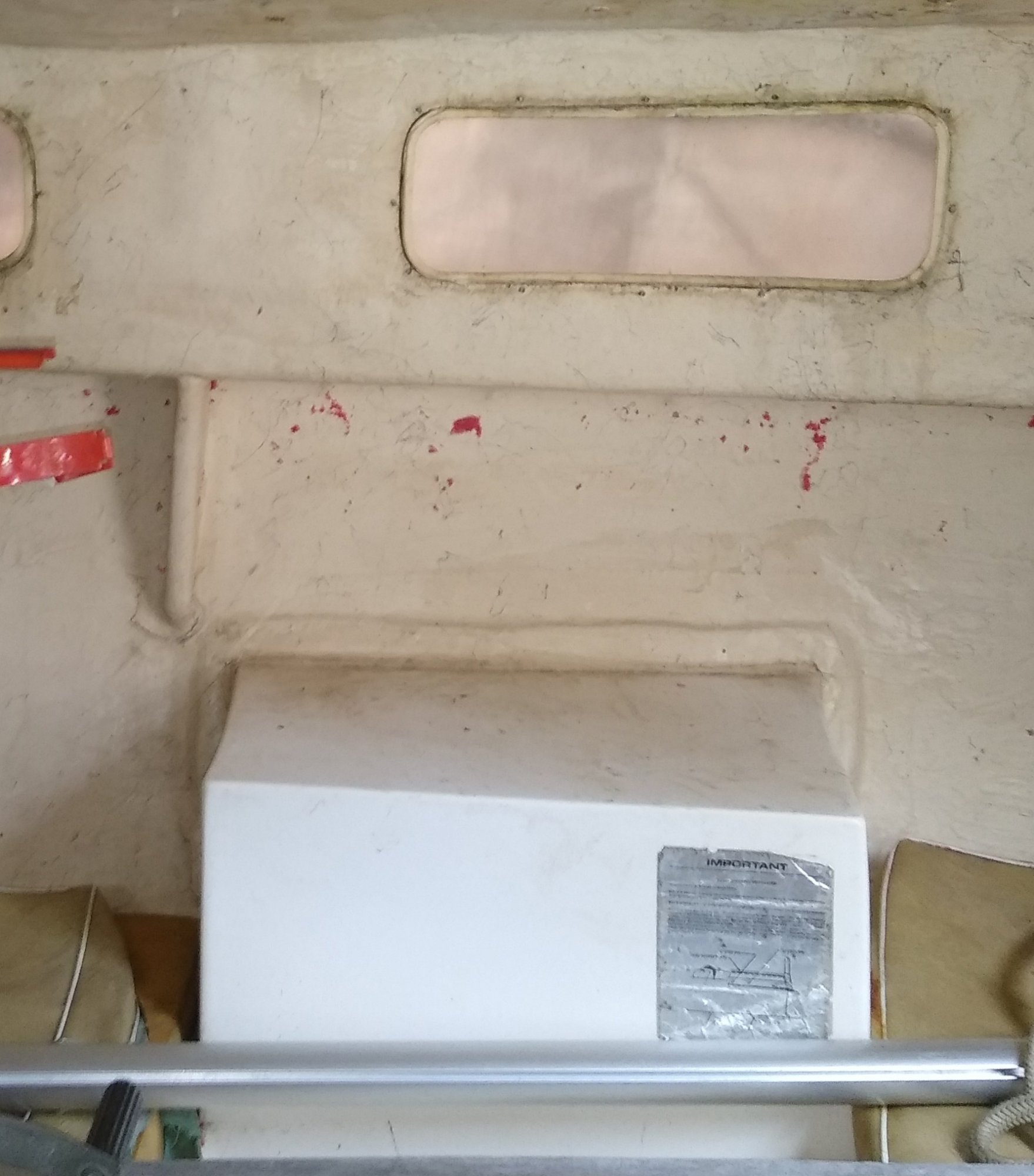

The box on the starboard side has no lid . No opening at all?
Pics to come.
Trick
Oct 28, 2021
10
San Juan 21 mark 1 21 2 Couer D Alene
Here is where the bulkheads would be.
Looks original.
You can see a lump between the windows the chain plates are glassed in the cabin wall.
Looks original.
You can see there is no access to the boxed area below it.
Presuming I can cut that open, and make a lid.?

Late to the thread, I know, but I also have an SJ21 Mk 1 and my interior looks just like yours. I believe those large bulkheads were only on the Mk 2s...and I know a handful of Mk 2 owners that have cut them back or replaced them with much thinner metal bulkheads in order to open up the cabin some more.
And yes, you can open up that box, it's hollow inside. Luckily the former owner of mine had taken care of that already.
