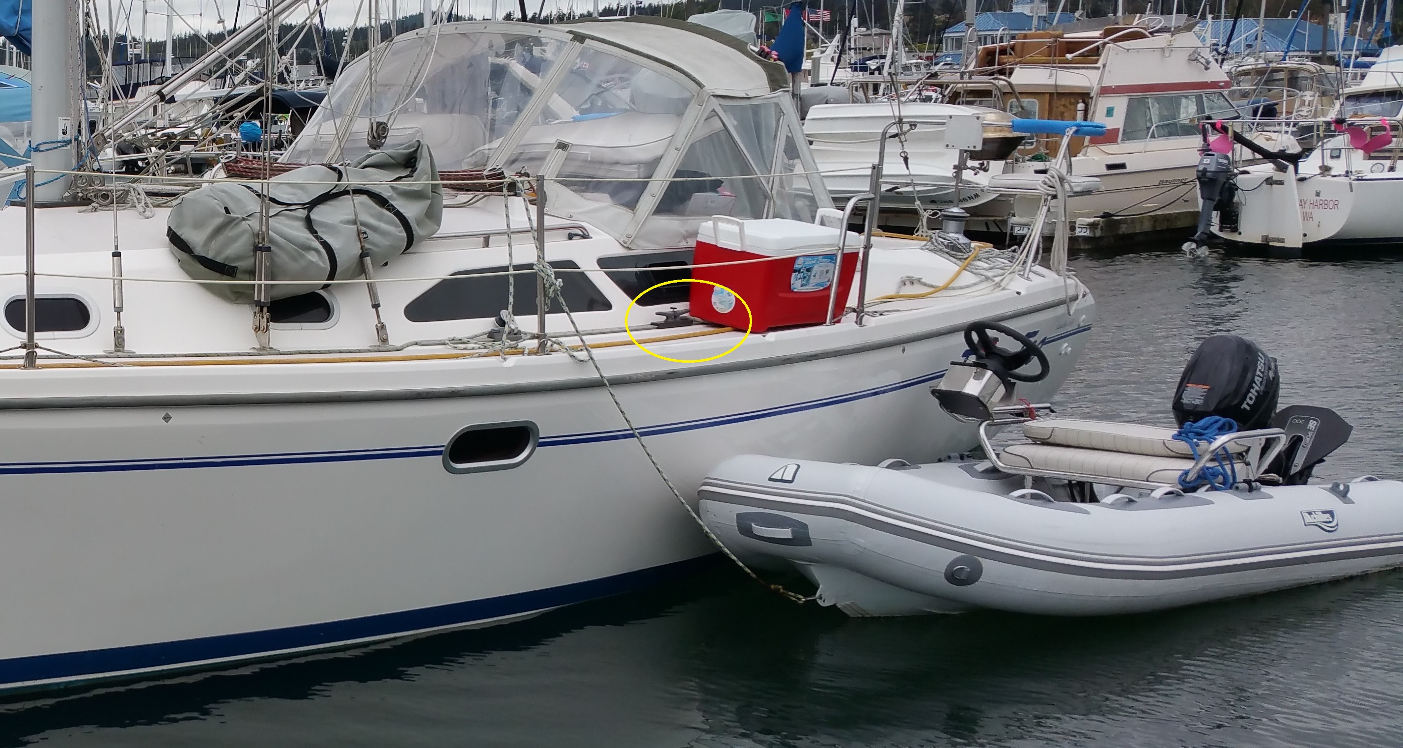

I've been using track cleats for that. The lead isn't ideal, but it works.

Right. But not a very fair lead, that's the problem.
What is a fair lead for? I do not see a problem. I guess after using for 5 years, there is something I must have missed......they sure work good.
