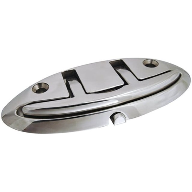

13,074
If you are worried about interference install one of these

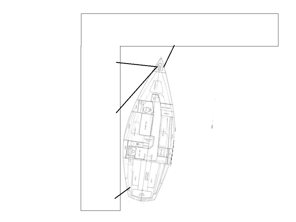

I made a rudimentary drawing of my normal docking configuration.
I think the boat angle in my drawing may be a little exaggerated, but I typically dock with the bow pointed "in" to the channel to facilitate getting on/off the boat. I've never had an issue with the spring line rubbing--that may be mostly due to the mid-ship cleat on the dock being a little forward of the center of the boat. If I have a breeze from the stern the spring line pulls the boat in tight against the fenders before the line can rub on the boat.
The only thing that's a little awkward is that the port side bow cleat has two lines--if you use larger dock lines you may not have quite enough room for both to attach. I don't remember sizing on the lines I use forward, but they both fit (even though it is a little tight).
