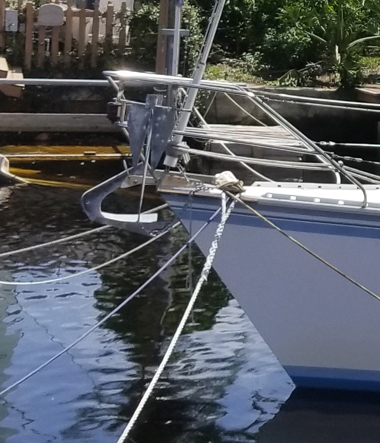

I've always thought of chocks as being like line cutters only with slightly rounded edges. I find them dangerous. My boat is 32 years old, I've had her for 20. There is NO gel coat damage from using our bow & stern cleats in our slips or when traveling in all these years. Our cleats are in similar positions to those on a C310.
Now this is exactly the type of real-world practical information that I come here for. Thanks @Stu Jackson for information that I can use, and saves me years of experimenting!

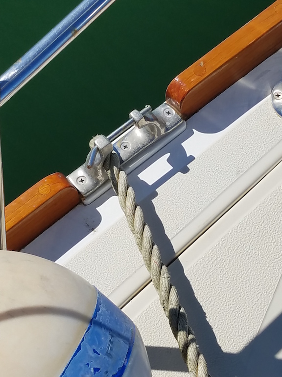

That's a weird point of view, I must say. Maybe it's related to the type of boat? If you have teak toe rails, you absolutely need chocks, or you will quickly ruing the wood, unless, perhaps, if you fit metal anti-chafing strips.
This one is very smooth, nicely made, forged bronze that's chrome plated. It also holds the mooring line in. There was only this one, to port, so I bought one for the starboard side, too, as we are moored via a bridle to the mooring chain.
Chocks have been around as long as boats! Yes, avoid sharp ones (duh!).

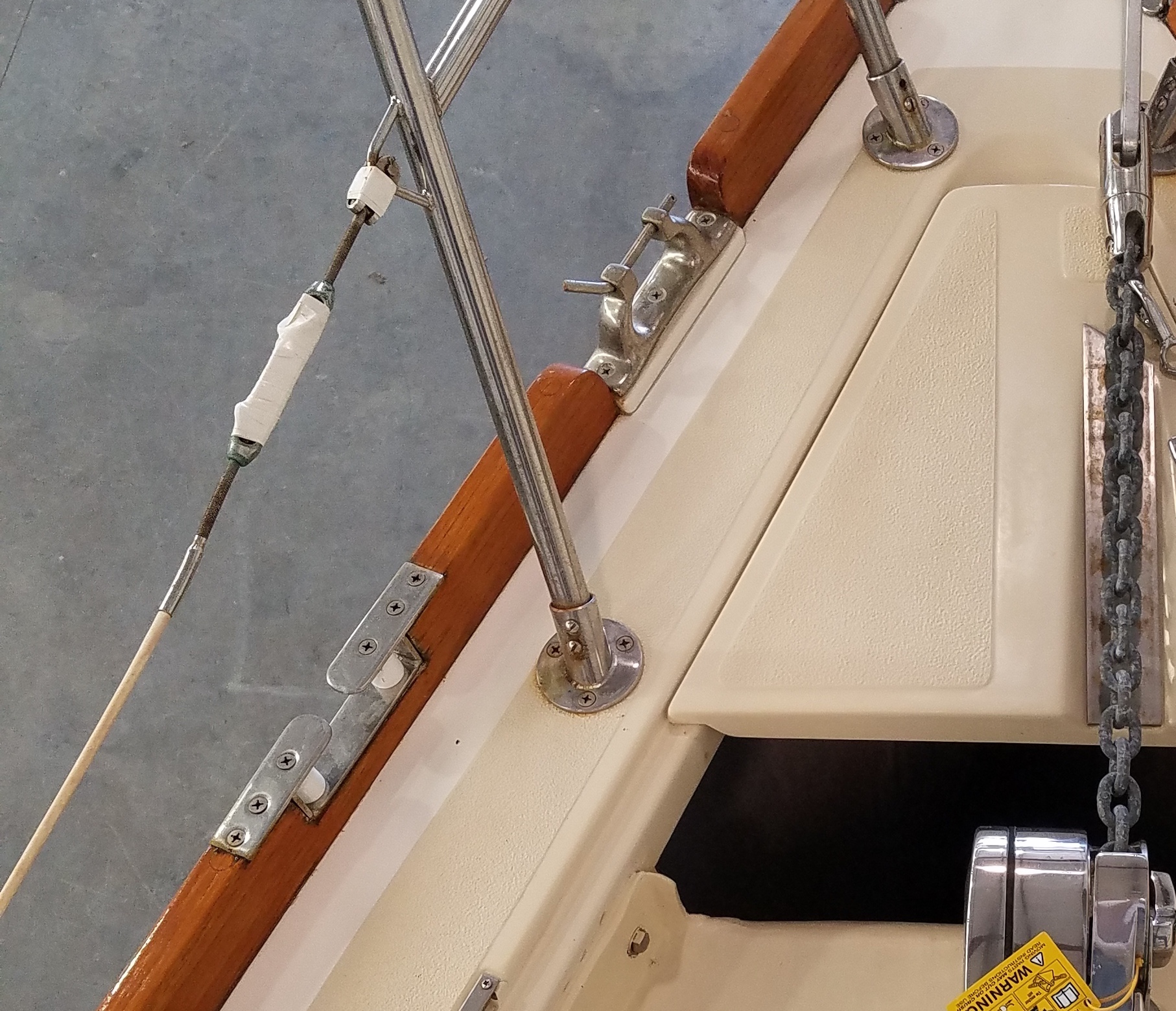

Here's the two kinds of chocks I have. Top is as before, the mooring chock. The lower one is more for a dock line, nice rollers to preserve the line, but too small for big mooring lines.
