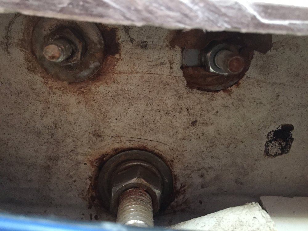

Honestly, the track itself is probably strong enough as it's designed for lifting forces, which are the worst possible type for fasteners or cleats, and you are using it for shear forces. All jib track's that I have seen are through-bolted, which you can check-out from the inside. The real question is the track-to-cleat connection and that pin that @Stu Jackson noted. I have these track-cleats on my boat, and have always been concerned about putting significant loads on them. May I suggest that you can 'stage' your loads by keeping your normal mooring cleats tighter than the center cleats? That way they'll just be backup if something else failed.
