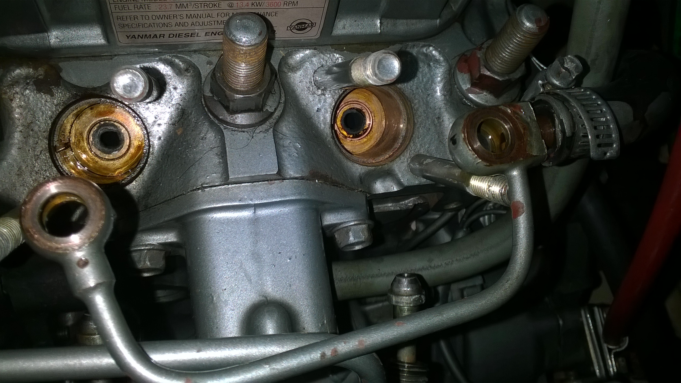

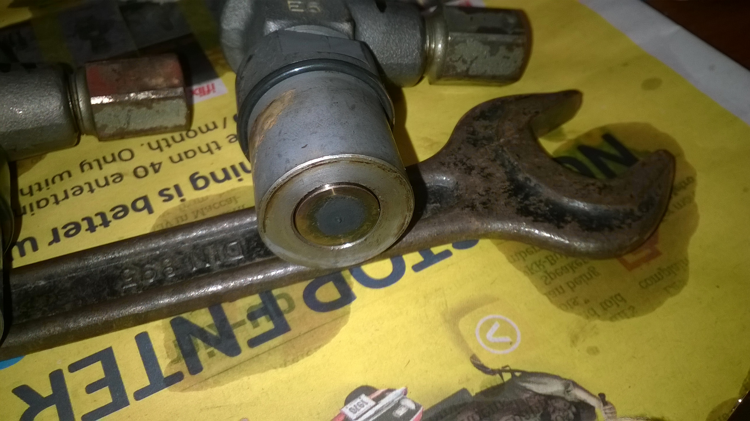

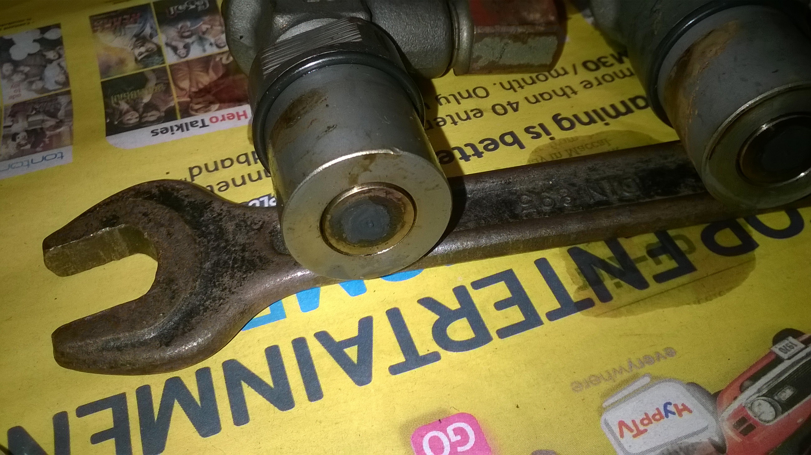

Observation: I removed both injectors and notice #1 is dry but #2 is wet (diesel) around the cylindrical portion that slots into top head. I'll post photos when have access to pc.

See Chamber #2 and wet and #1 is dry. Also #2 seems to have a little more carbon.

Ok I got my injectors back from shop. Spray pattern good. No change of parts. So it seems after 4yrs (about 500 running hrs) injectors are still A-OK.

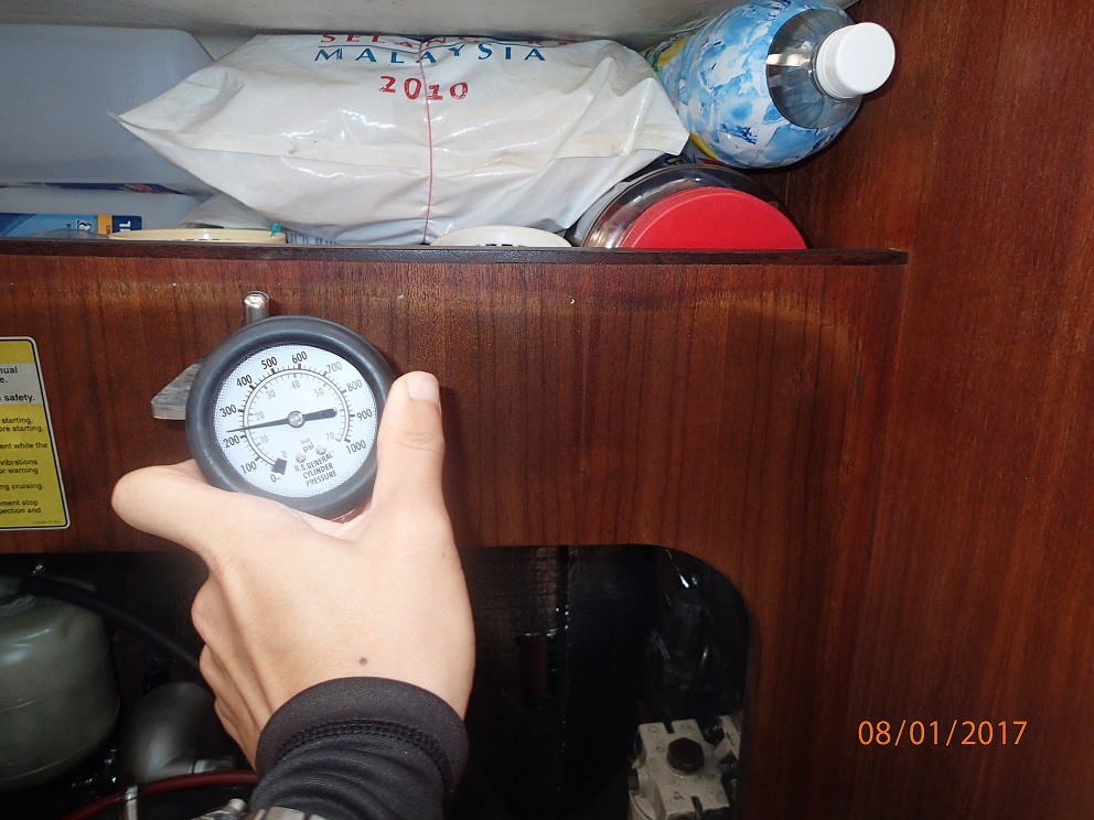

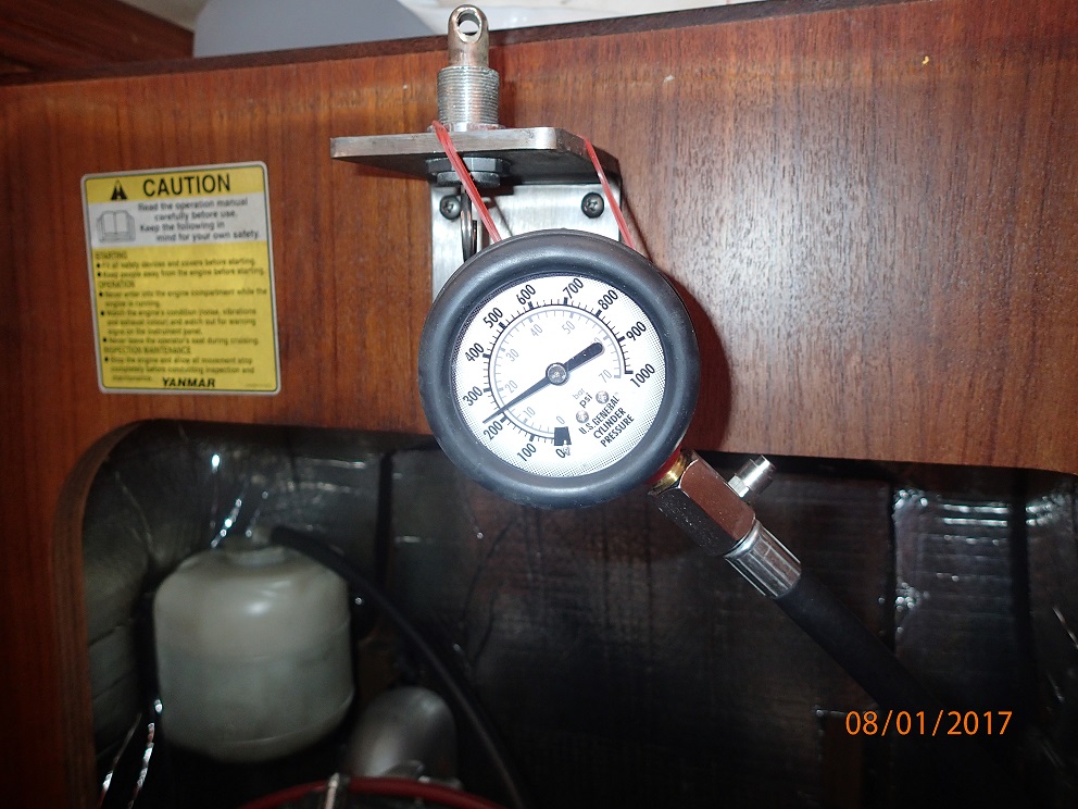

Tested both cylinders with Compression Tester. Both reading 220+psi. So both cylinders are balance/same in compression. That's a surprise to me but I guess it is expected....right?
